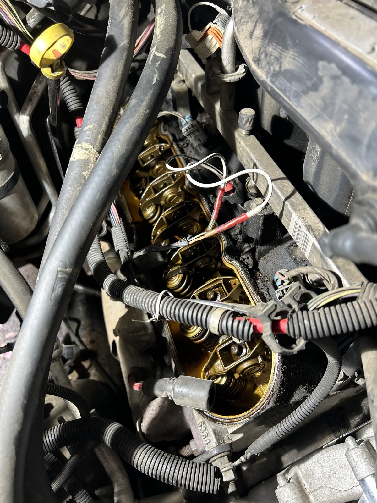

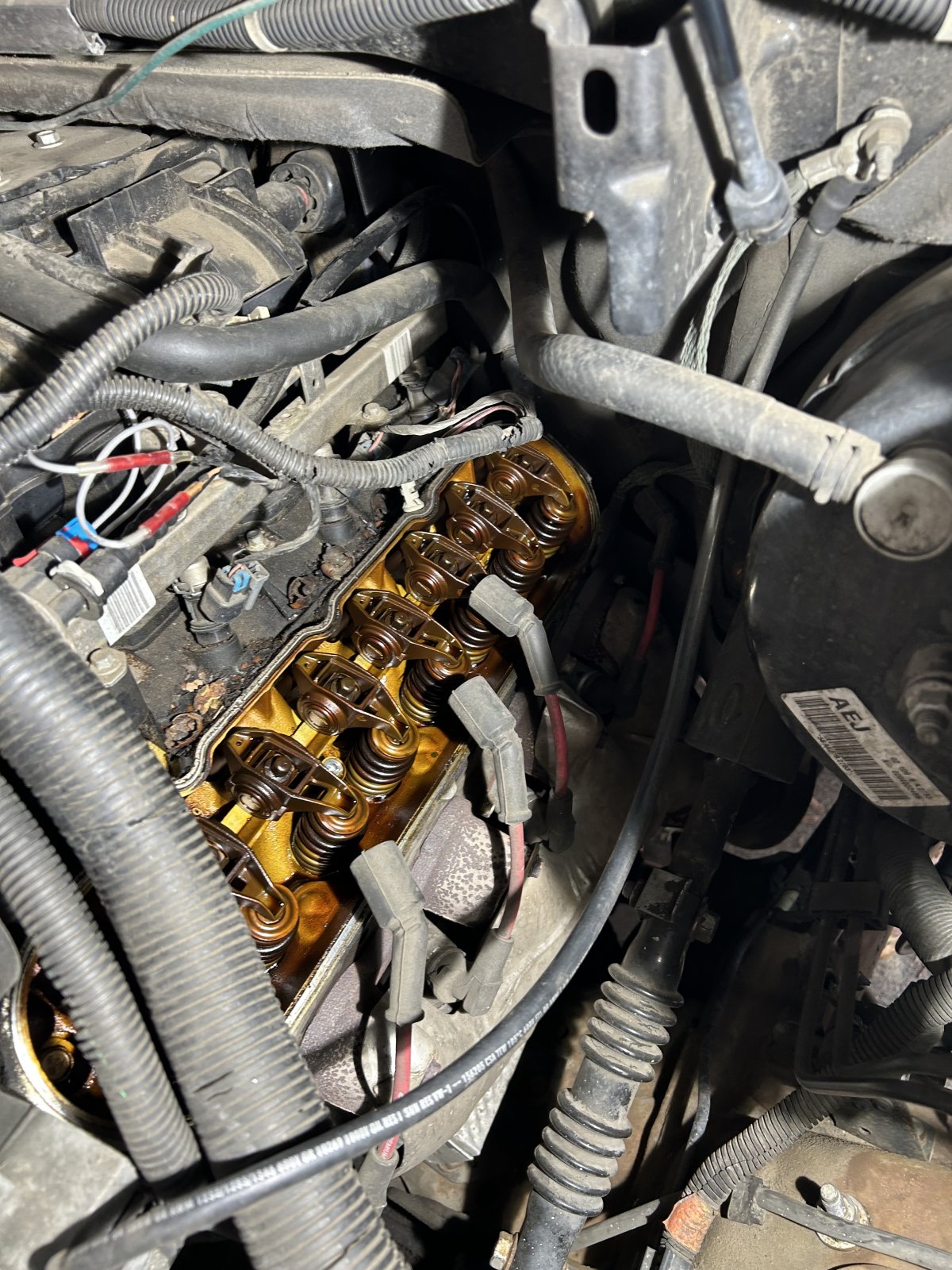

I pulled the valve covers this morning. All the springs are good. All rockers have a little side to side play at top dead center. No excessive lash. I think I will drop it by the transmission shop this week for a proper torque converter bolt and flex plate inspection. When I changed the starter a few weeks ago, I did put a wrench on the flex plate bolts and they were all tight annd I didn’t see any cracks. Are there other bolts for the TC as well?
