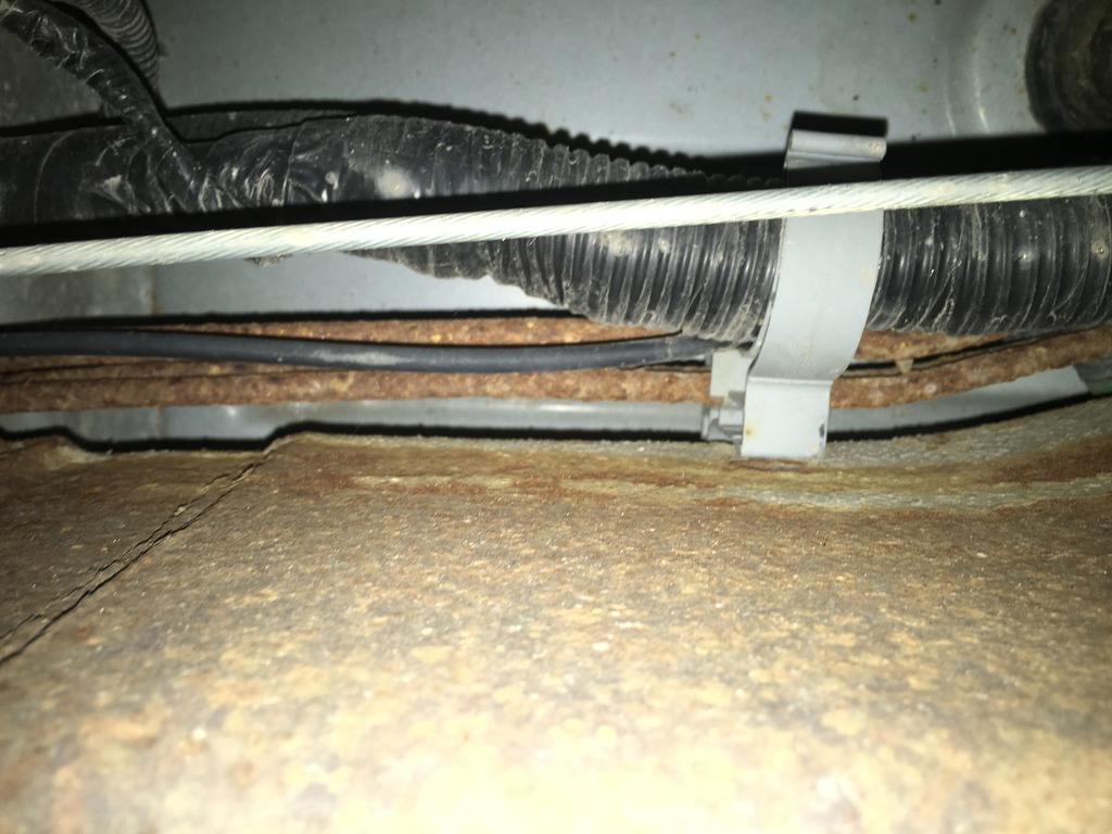

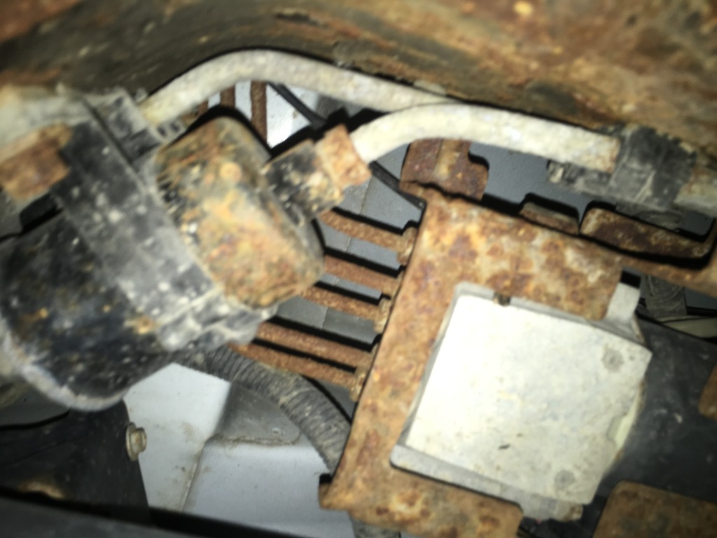

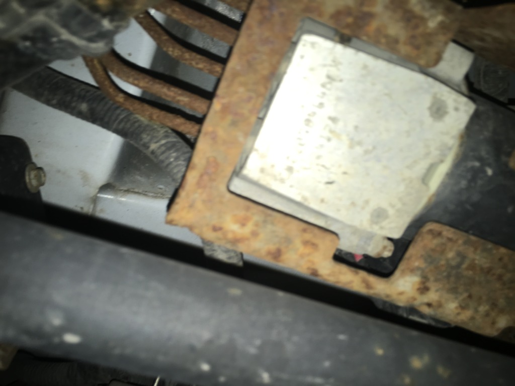

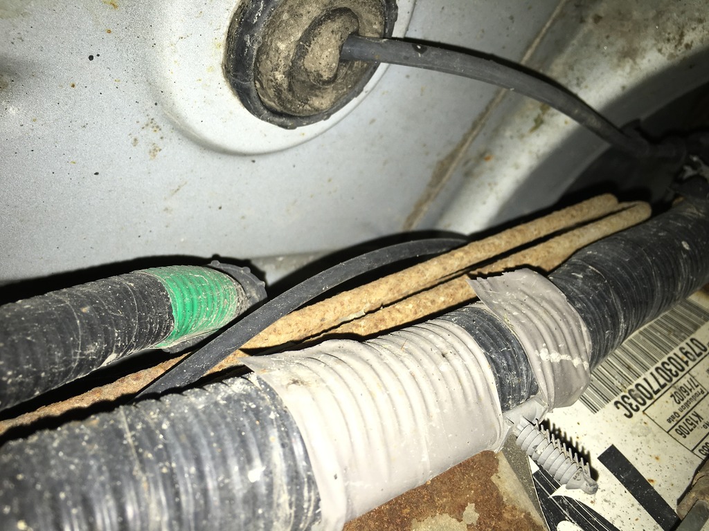

How bad do mine look?

Your brake lines are a ticking time bomb!!! These start to leak where you cannot easily see them, you must remove some things to see where the lines come down near the drivers kick panel at an angle and then level out, this is where they almost always rust through/blow out.
The brake line kits of pre-bent and proper length are less than $100 on Amazon. DO NOT allow the lines from the master cylinder to be replaced, the OE lines at the master cylinder do not have problems and are far better than what comes in all the kits.
It takes between 2-3 hours to replace the lines and bleed the brakes, expect a REASONABLE shop to charge you around 4 hours of labor. Shop around, find a shop that does these, any shop that has never done these will give you a price of like $1500.
Trust me, yours are probably seeping or will be ready to blow out the first time you jump on the brakes hard. This is a STANDARD OPTION OR FEATURE on these trucks, they all have this waiting for the current or new owners!!
Have I been 100% correct so far?? Yes I have been.
