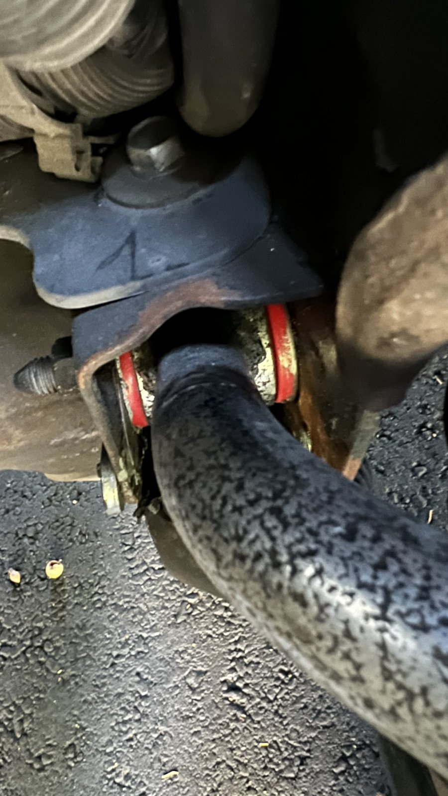

I’m ready to torch this truck to the ground. With the factory arms, the alignment shop couldn’t get my caster better than -7° because the upper arms were bottomed out in the back of the slots. I install some DJM arms and they can’t get the camber better than 1.5° and caster is still -5° and now they’re all the way in the front of the bolt slots ‍♂️

I'm sure you do, but do you have the offset UCA bushings?
I had them in the stock arms and they worked great before I lowered the front another 1” like 6 months ago. That’s why I switched to the DJM ones and that just gave me the same problem but opposite end of the slots

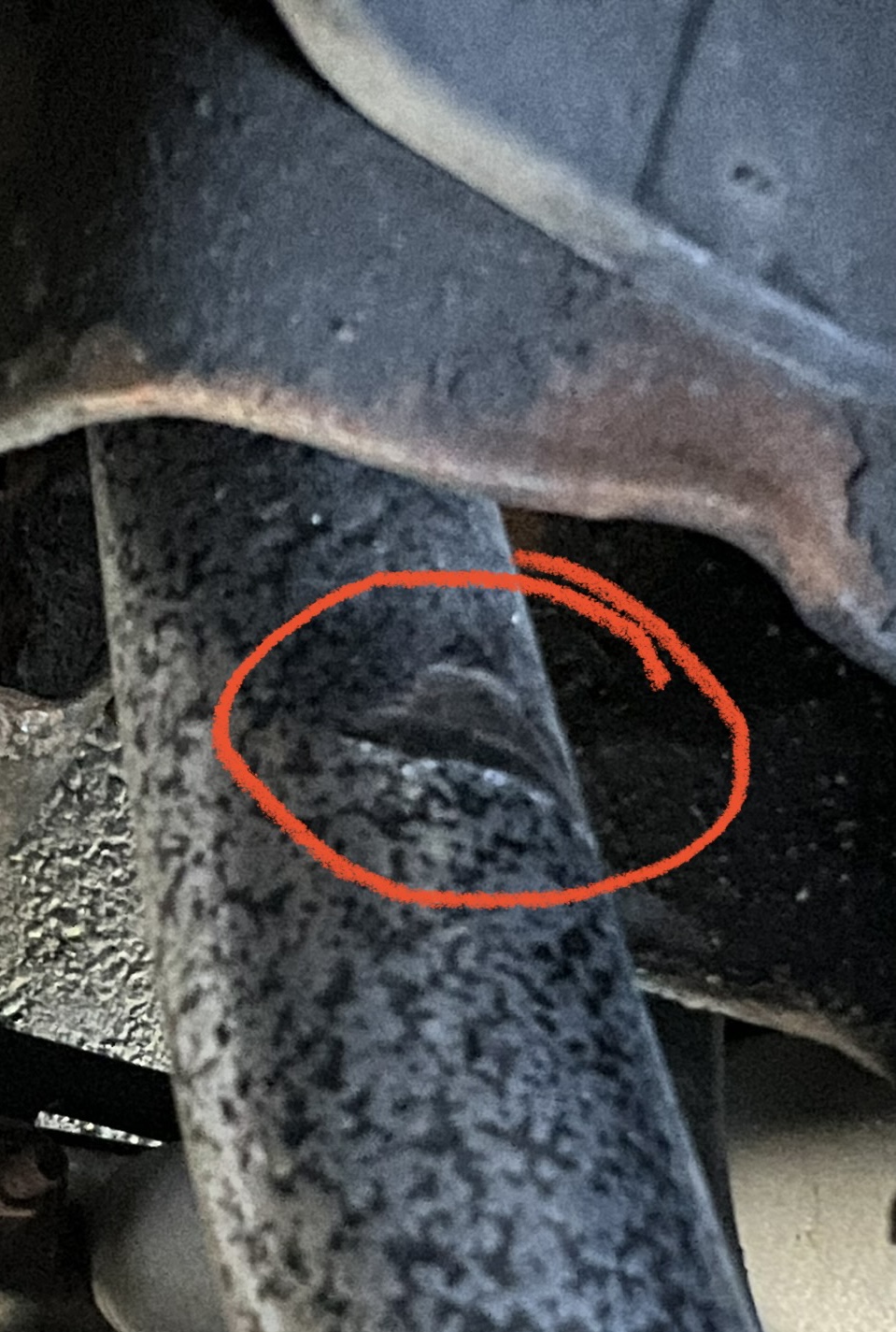

I was unaware that you need to trim the UCA mount with these arms ‍♂️ I’m starting to get really sick of all the BS that comes up with this setup

The instructions say nothing about it, of course
