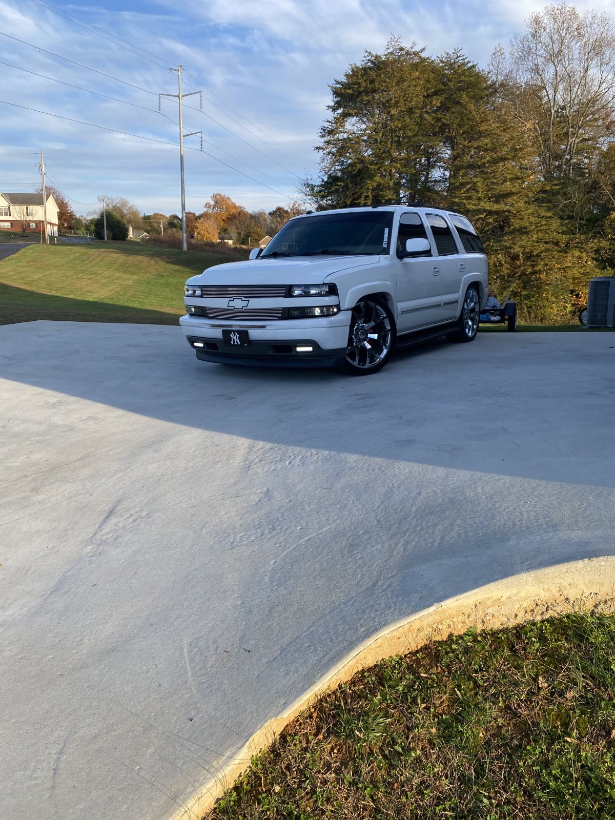

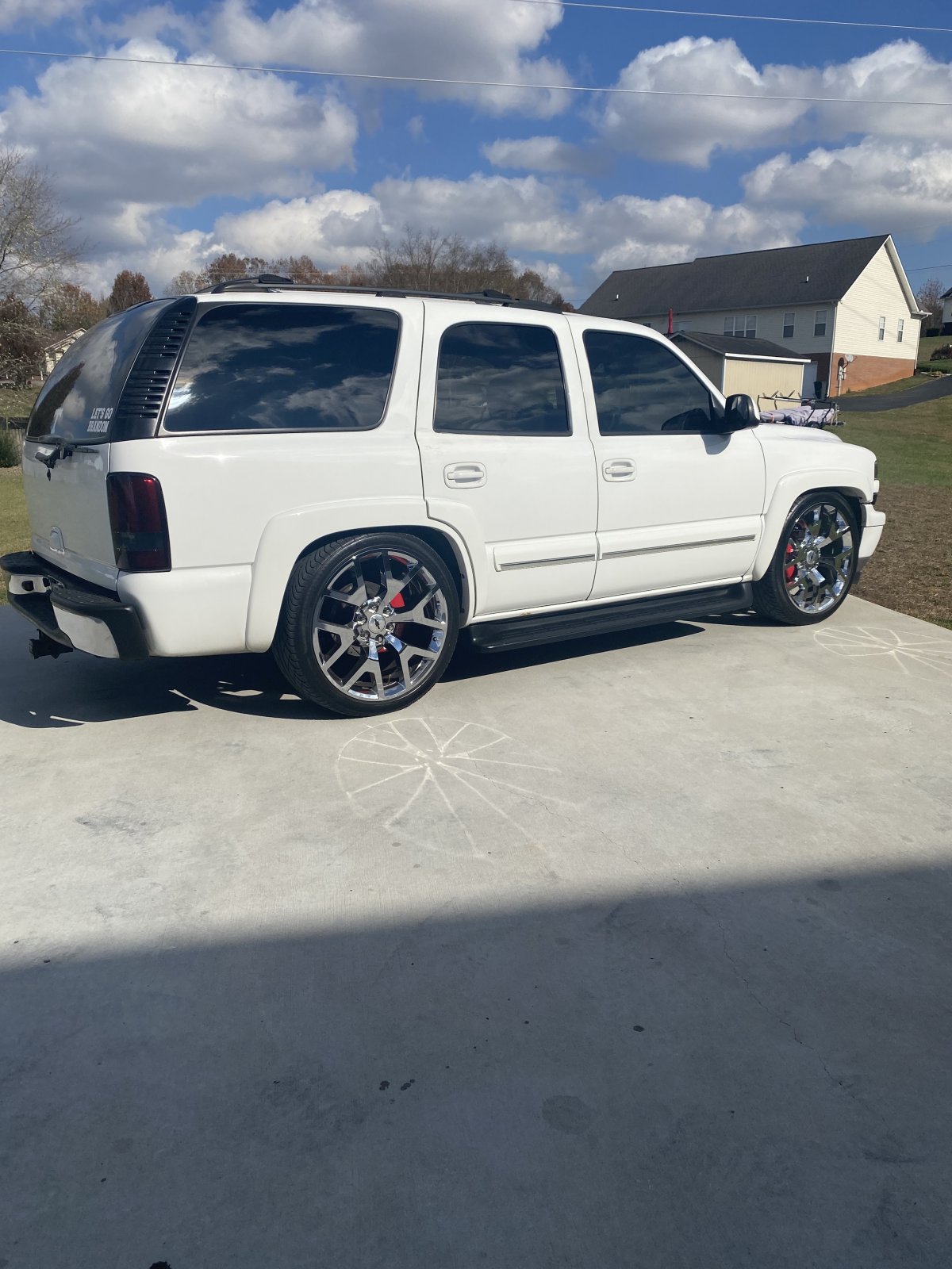

Yes I did run the 4230 for a while. I ended up getting the 5305 an going with them. An the coils that touch at the top the dead ones. I cut a coil off. An I got about a 6 inch drop. I also have helper bags.

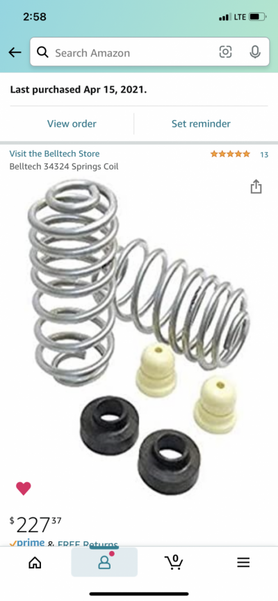

These are what I ordered an got the 5305s.
