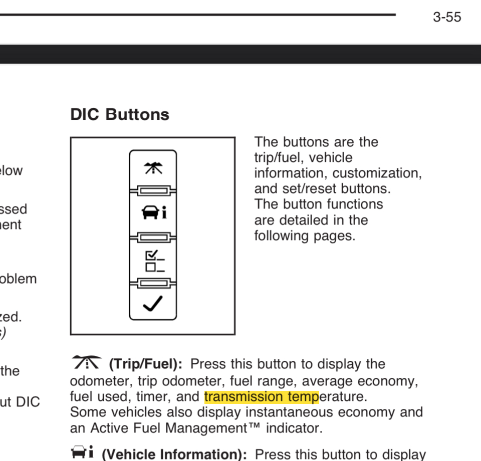

should be able to pull it up in the dic display I have it on mine and many others do as well, just cycle thru pushing the top button, it should cycle thru miles, mpg, etc, just go until you see trans temp.

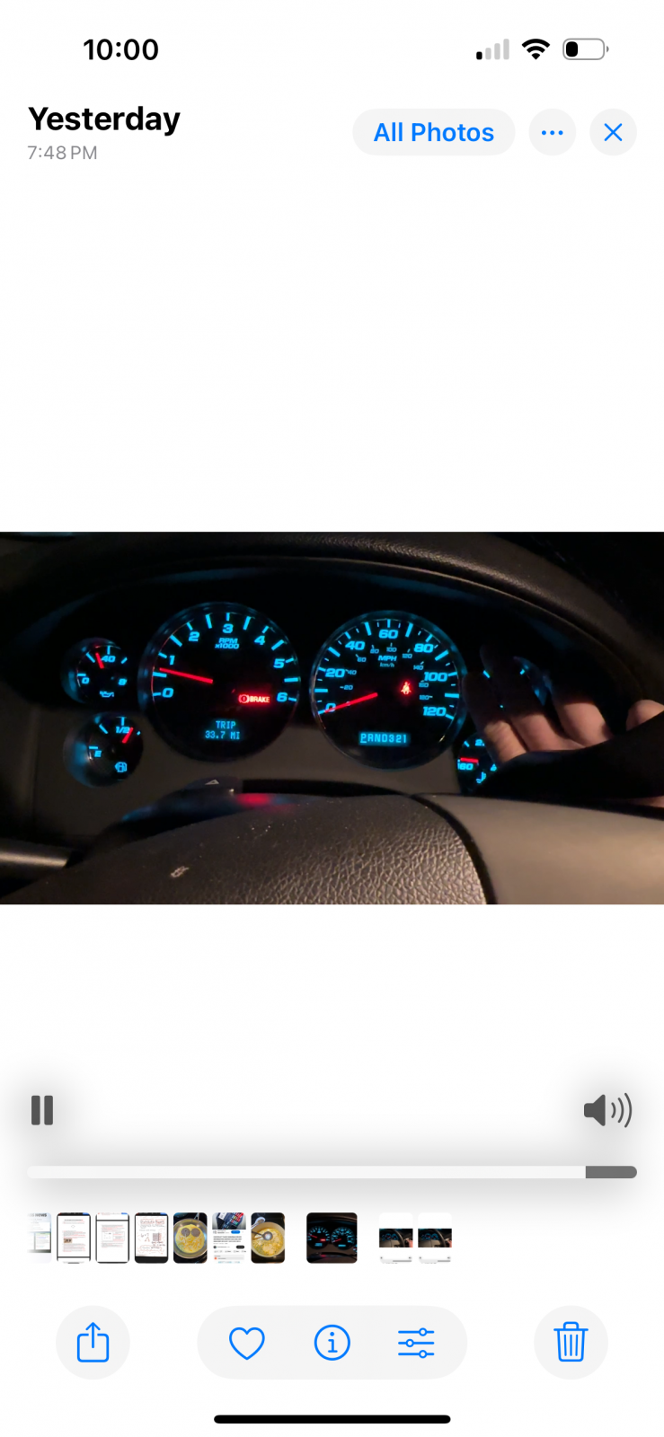

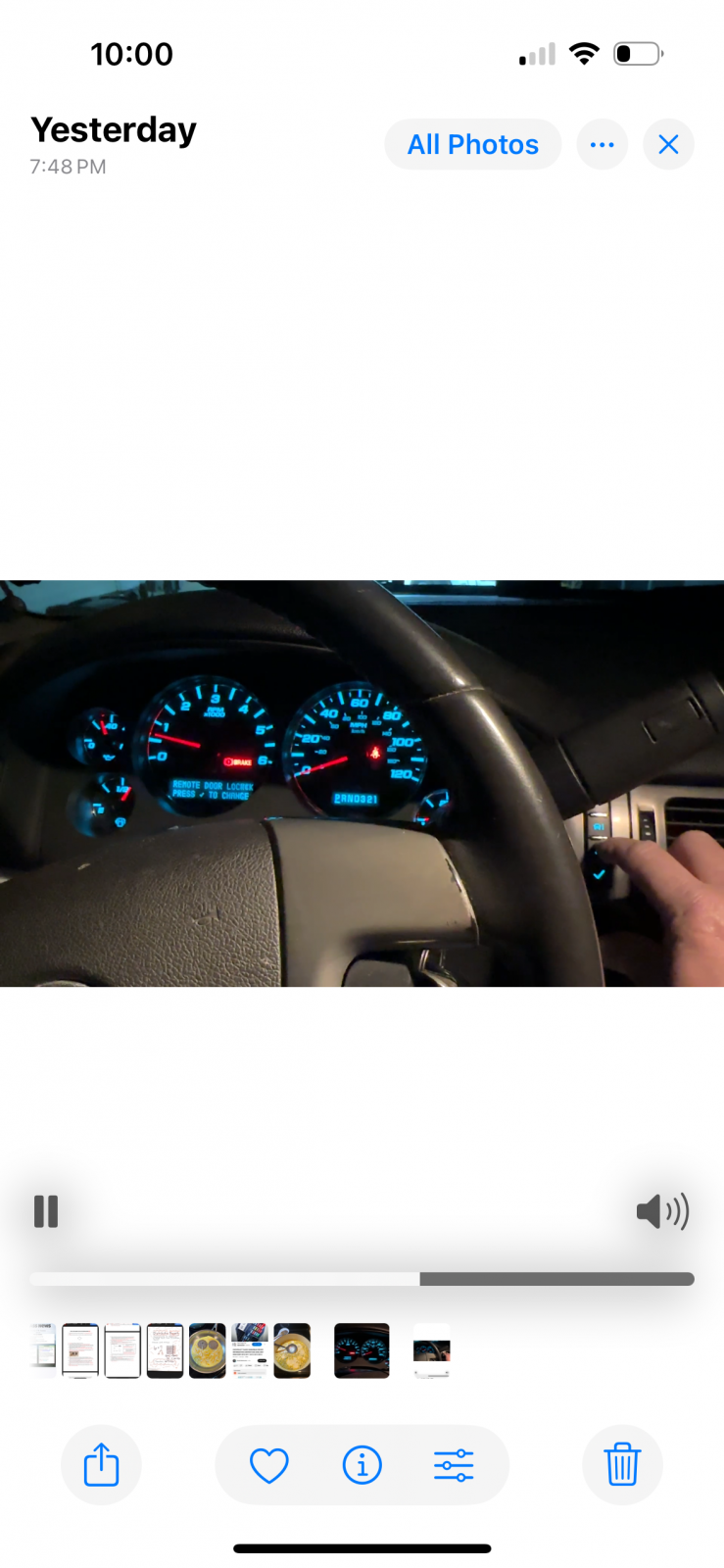

So, I tried scrolling through the DIC and nothing would display. Hmm? I pressed and held it several times and still nothing. Anyone one run into this issue where nothing would display? I do have a Range AFM disabler. Not really knowing if that made a difference so I tried it with it plug in and with it removed. Same result.
Anyone have this happen before?

nothing at all? it doesn't show mileage or anything?????? if so then the display is burnt out
and you do not "hold" it for the top button you just press it, the only thing that gets held is the "checkmark" button for things completely unrelated to transmission temp display

You should post a video of what you are doing, after you read your owner's manual. Do not shoot the parts cannon yet.
I will take short video and post it later today. I did read the manual after it was first mentioned. Once the display was shown to not cycle through it functions and the button appeared to be physically operable (meaning I could press it in and it would return to its original position) then I started the troubleshooting.

Here are screenshots from the video of me pressing the different buttons showing the respective options on the instrument panel.
