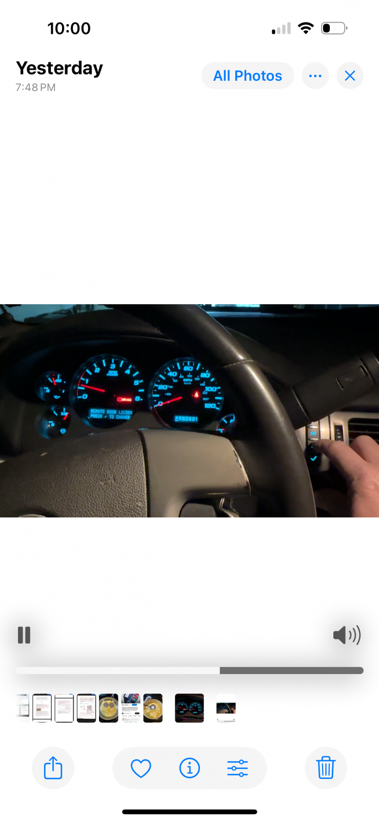

Here are screenshots from the video of me pressing the different buttons showing the respective options on the instrument panel.
