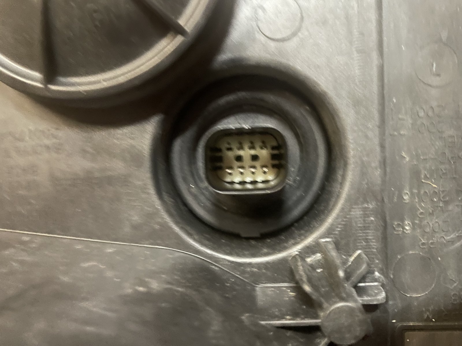

All bulbs stayed stock.
It could be the harness except that the doesn’t directly connect to the bulb socket. It connects to the main housing pin connector and that was corrosion free.

Finding and fixing the cause for the voltage drop was my first thought as well.
However, that’s when they suggested that the OEM housing has proprietary recognition capability via the control module.
They are implying that aftermarket housings Will not be recognized by the control module.
That’s where I think they are full of BS. However, they are a dealer and have the scan tools that most shops do not have.
