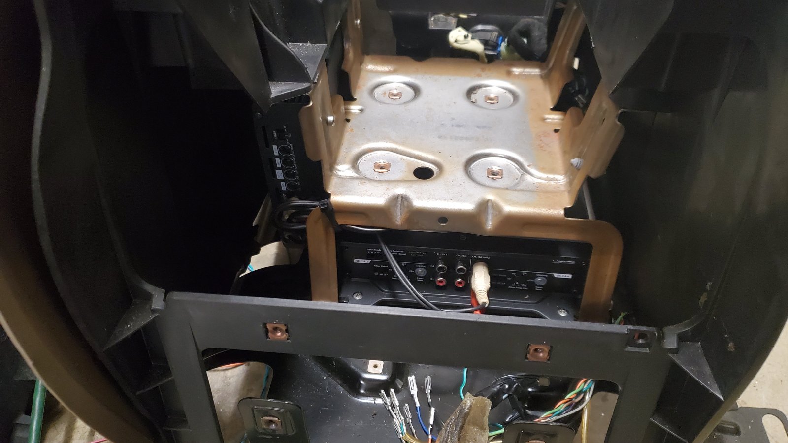

I have not finished fixing mine yet so I have not confirmed if it's the head unit or the amp. However, I did pull the console apart and found some evidence that the amp had gotten wet, so I am in the middle of replacing it. Upgrading while I am in there with a JL 4 channel where the stock amp mounts and a second amp for the sub, also mounted inside the console. Hoping to have it back together within a week or so to see if it is fixed.

Just wanted to throw an update out there - I did replace the amp, ended up installing a JL JD400/4 for the door speakers and an Infinity Primus amp for the sub. Dramatic improvement in sound, particularly bass, but the intermittent buzz or distortion is still present, and still annoying. It seems a little different in that I have more background buzzing going on that wasn't there before that is independent of system volume, but time will tell a bit. Somewhat bummed that it didn't eliminate the issue.
I did find some references to the rear seat radio/head unit causing some fuzz or buzzing for people, but no idea if that's my cause yet. Only the rear channels are interrupted by that module, so I may unplug those from the amp and see what happens. It isn't too hard to completely bypass the audio signal to the rear control unit, but I didn't do that as I want to keep as much factory functionality as I can. I don't use the rear controls and given that it's $100+ for a used module, I would likely just permanently bypass it and move on with my life if that ends up being the source of the issue.
By the way, if you have a late truck that doesn't have the HVAC duct running through the console, the JL amp will fit where the stock amp was with a bit of trimming, and the Infinity will fit where the duct would typically pass through.
