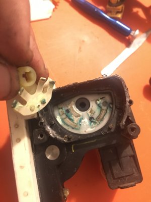

lol They’re horrible for building corrosion!
Here’s my driver door latch assembly torn down to the door ajar switch.

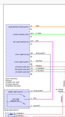

@GCDenali Check power at terminal ‘D’ ‘Connector 1’ of your BCM. “Inadvertent power supply” and report back
Dome lights and the map/reading lights use the same ground but different power feed. So from what you’ve said we can gather that the ground side of the circuit is good. So it appears to me that you’re having a power issue.
