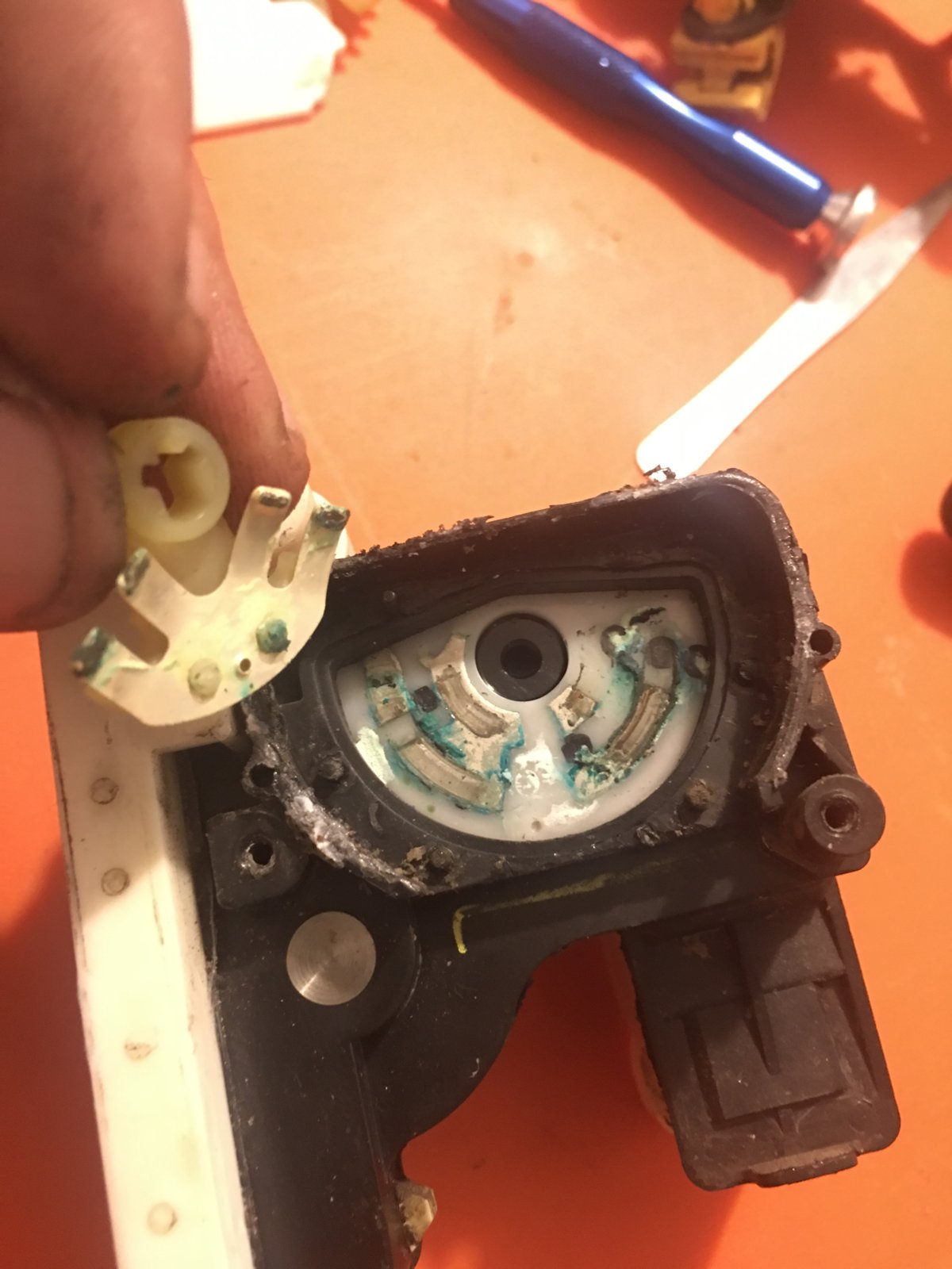

Spray some contact cleaner in the door latches. The switches are integrated into them. I have had the issue before on all 3 GMT800 trucks I have had, and spraying contact cleaner or wd-40 has always fixed it.
lol They’re horrible for building corrosion!
Here’s my driver door latch assembly torn down to the door ajar switch.

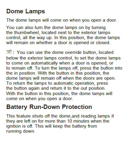

I think pushing the button in turns off the interior lights.

Yes, I should've said... The override switch should not affect the map lights. Can't see it being a fuse if they come on with the fob....hmmm....
