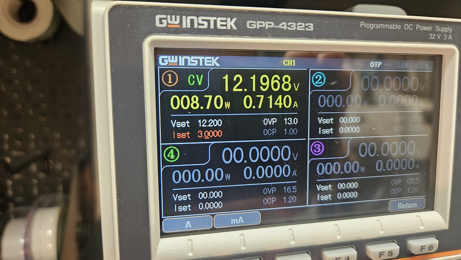

So I shut the headlights off, key off, and with the door open, I turned off the same map light, same 700mA difference. To be sure the bulb isn't wonky, I pulled it and put it on my PSU to verify the load and at 12.2V it was at 714 mA so that checks out.

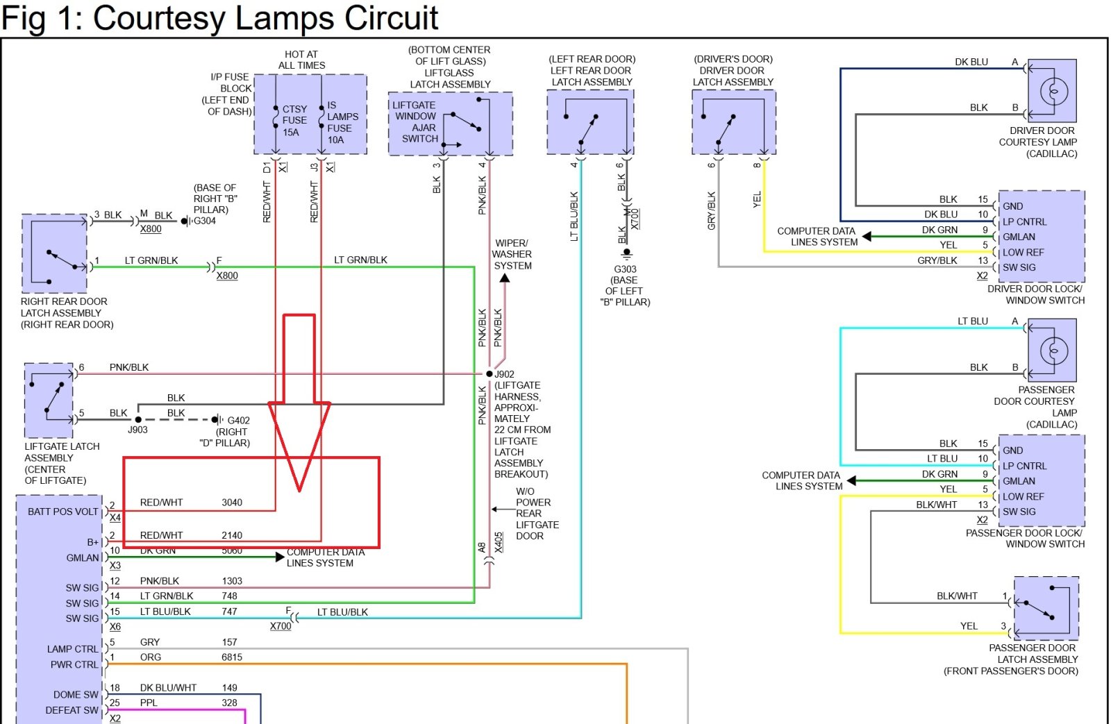

I have battery voltage at both circuits 3040 & 2140.

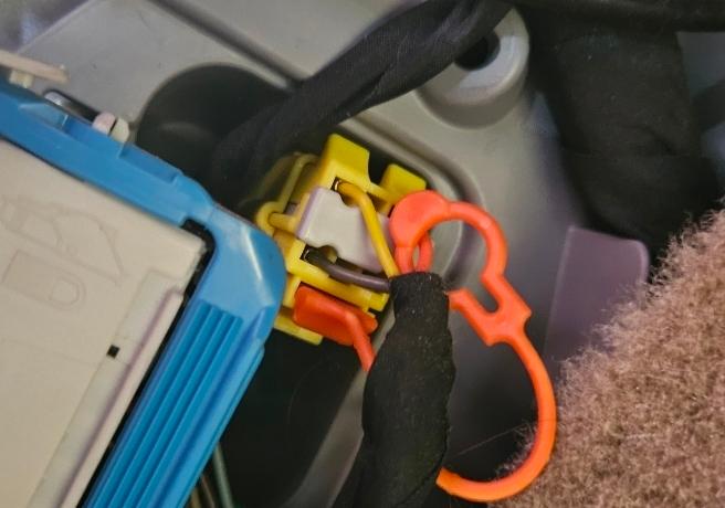

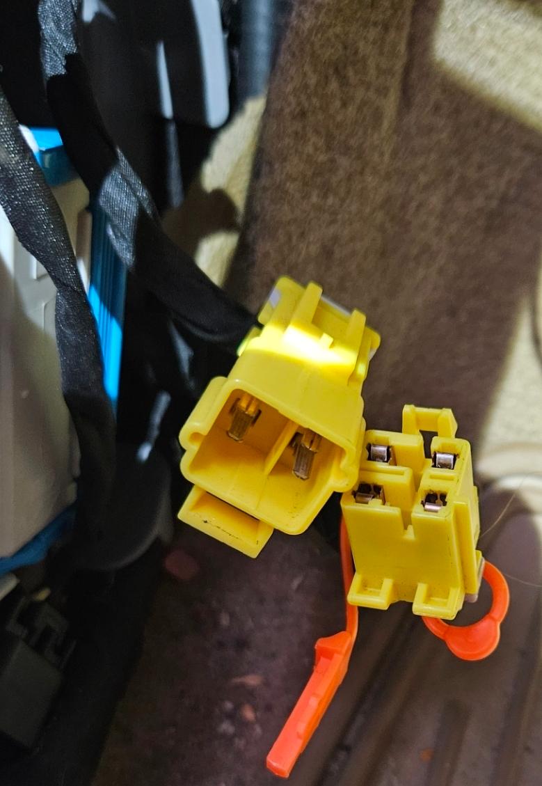

At the base of the kick panel, I don't know what this is, but it has 4 wires, yellow, grey, orange, & purple. With it disconnected, I have 7.6V on each of the yellow and grey, but when connected, I lose the 7.6 V at both of those wires, the orange and purple I'm not sure but have almost no votage.

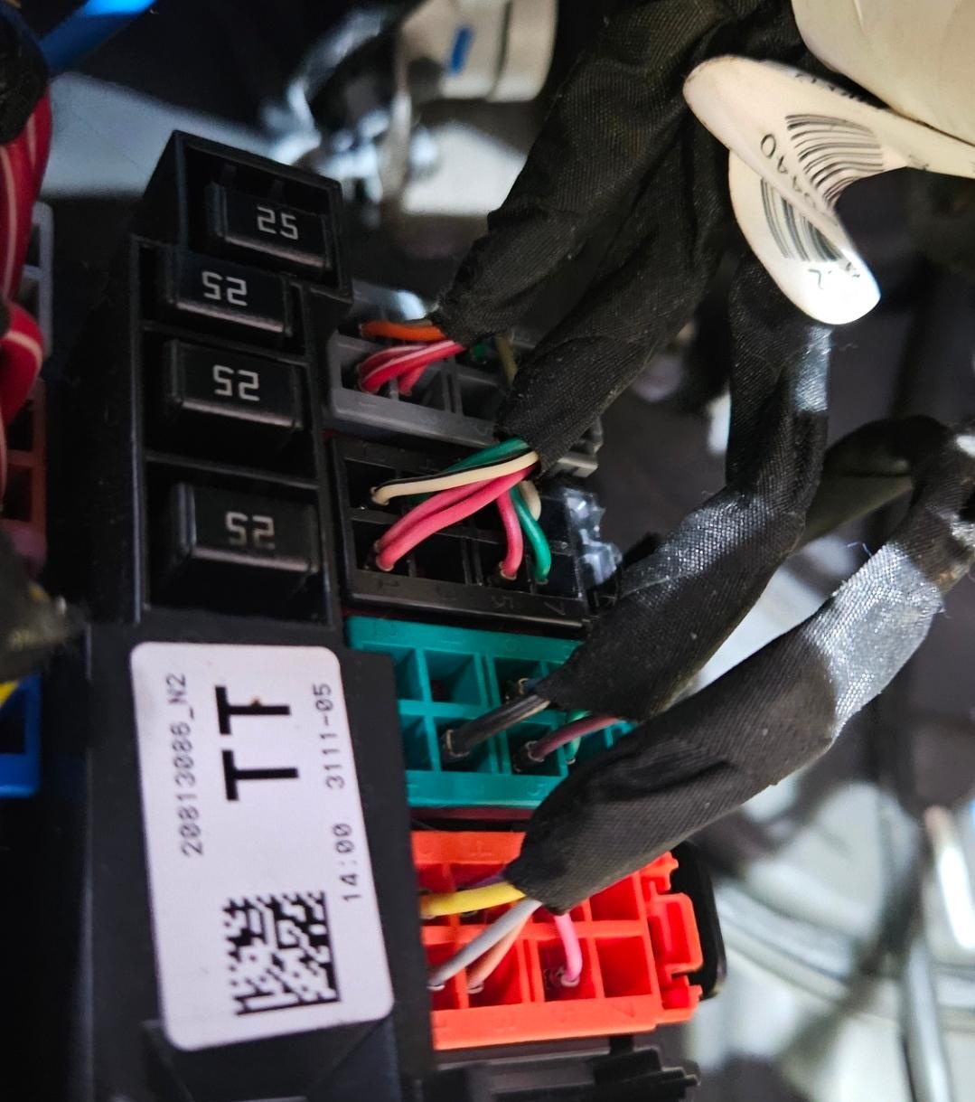

It is the black connector near the base of the steering wheel in this junction box:
It does have battery voltage but I'm not sure what the 'Interior dimming lamp control", circuit 157 should read. I did not pull any of what looks like 25A breakers.
