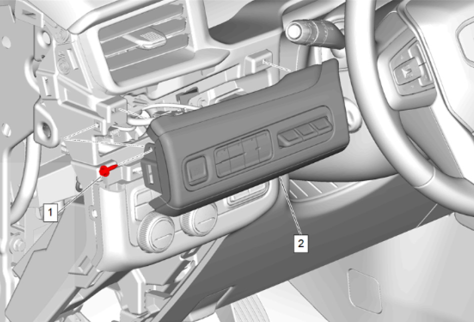

Saw that you put this on your Denali Ultimate. On the Denali, there seems to be a bit more leather trim on the section near the air vent to get to the 2 screws. I wasn't sure if you just have to brute force it or if there was another way. How did you get to the 2 screws near the air vent? Thanks in advance!
The 23 is even easier. My mechanic installed mine while I stood there. Remove the lower panel, then the side panel. There is 1 screw holding the button assembly in place, remove it. Take a trim tool and snap the switch panel out of the dash. Disconnect the switch wiring harness, plug in the new harness. Put it all back together.21 Yukon Denali Switch Panel.jpg

The 23 is even easier. My mechanic installed mine while I stood there. Remove the lower panel, then the side panel. There is 1 screw holding the button assembly in place, remove it. Take a trim tool and snap the switch panel out of the dash. Disconnect the switch wiring harness, plug in the new harness. Put it all back together.View attachment 400054
You rock. Thanks!
I have a '23. So, only the switch panel itself (shown here) needs to be removed along with the lower and side panel? No other trim like in the site's installation video?
The installation is even easier than the video shows, and I used that photo for reference. To install, you will follow the video for the first 2 parts, removing the lower panel and the left side panel. After that, refer to the attached photo. There is 1 screw to remove and then the panel with the start/stop button will pull straight out. It will have 4 clips on the back like the other panels. Just go slow applying controlled pressure with your fingertips until one clip releases and then move to the next. This will allow access to the installation location.
Thank you!

23 Tahoe Premier. Install was exactly as in the video.
It's a silly thing to get worked up over, but the engine shutting down really irritated me. Lol
Product works perfectly!

Regarding the clips that hold the switch plate in (on the ‘23 Yukon, anyway), could you confirm that they’re (4) of the plastic wedge-type clips with the metal clip over them? And it’s just a matter of pulling straight out to release them? Thanks!
