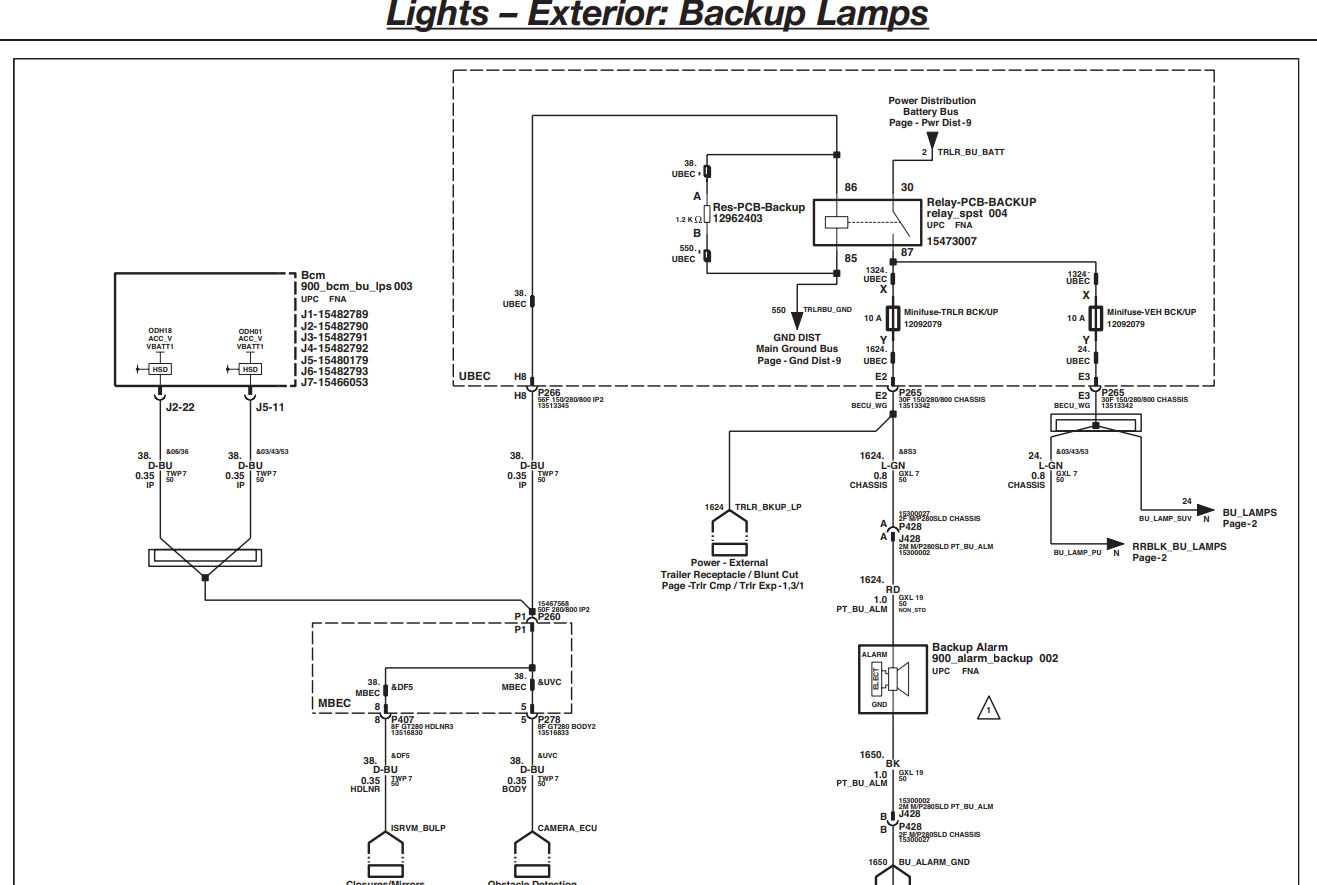

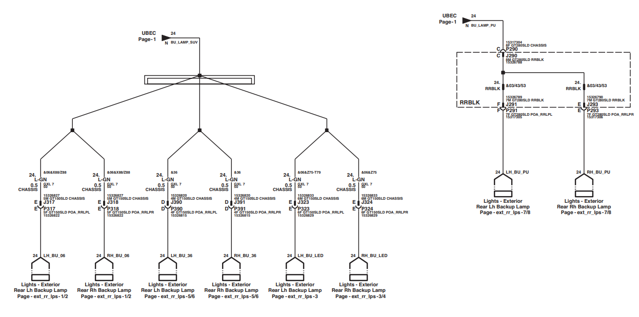

I would check for any cut wiring.
Do your reverse lights work?
And what color is the reverse output wire? This is lights diagram, but there could be other wiring I didn't find.

The PAC interface operates via the CAN bus, there is no "reverse light" wire in the back of the radio. It gets all its inputs from the CAN bus. When it receives the message that says the vehicle is in reverse, it toggles the puple/white wire from 0V to 12V. Considering the parking brake output works, I'm inclined to believe there is something wrong with the interface itself. But I have no way to confirm :( I will double check the reverse lights and report back
