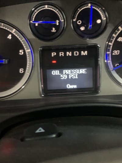

So I just took it out for a test drive and it feels like a completely different truck. I didn’t do any wot pulls but it feels so much more responsive. I think Im having a similar issue that Hager brought up about the converter pushing through at a stop. I’ll have to reach out to Black Bear for a fix.Thanks everyone for all your kind words encouragement. I really appreciate all your help/advice!

Super awesome! Do another oil change after first drive is my approach. Would have suggested you use cheap oil with a break in additive if I thought of it. You did absolutely nothing wrong, just costs an extra 50 bucks for oil. You didn't do any damage or anything.
I put a factory built HKS team racing engine in a MK4 supra like 10 years ago, like 40 grand for just the long block. The crate showed up, busted it open, and there was the engine, packed with boxes of oil and filters. 5 filters, and 5 oil changes worth of oil.
Step one. Start car with new engine, shut off once engine temp registers, then shut off and change oil.
Step 2 after full engine cool down, fire up car and warm up to full temp, rev to 3 grand a few times, shut off and change oil. Ridiculous maybe, but metal comes off early.
I personally change all diff and tcsse and engine oils super early.
