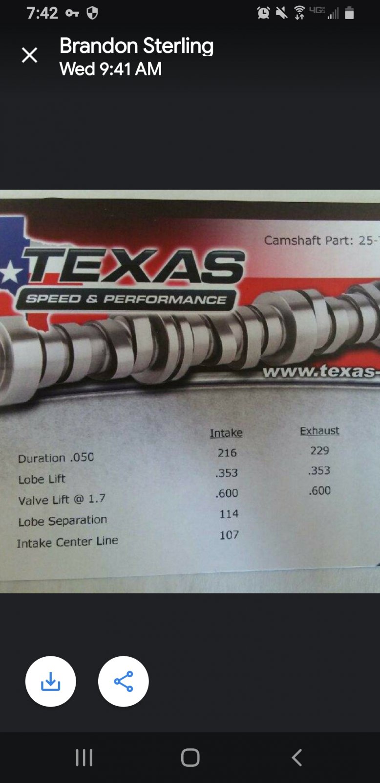

So just my opinion.. thru my research and experience
I "think" that cam would work fine with a good tune.. but you said you'll be
adding a supercharger down the road so make sure you get a LSA - lobe seperation angle of at least 114, 116 would be better.
That cam has a lot of lift.. which you won't need with a supercharger. I would go one step smaller on the cam.
IF you really want to get rid of the VVT, that's fine, but it does have its advantages.
I think doing these upgrades as a SEPARATE operation wastes a lot of time and money
With the cam job, you'll already be 80% of the supercharger job - depending on which SC you choose too.
You will def want to pin the crank while you have the balancer removed - I'd replace it with a better unit
And do the oil pump, timing gears & chain, and chain tensioner too
The SC won't require a high lift cam, so you can save a lot of wear on the valvetrain with less lift, plus
tuning and manners will be better
I wish I had done all mine at the same time too.. I did the SC only... Lots of work and a work in progress still !!
But probably next year I'm going to just build a new LS3 with a non DOD cam, GM perf heads and possibly stroked.
The pistons are a weak point with forced induction on these.. but I'm not the original owner like you, so you know your
history etc which is Huge IMO

I recently built my L9H and have a Texas Speed VVT-1 cam, ARH longtubes, and 2600 stall converter. I decided to keep VVT in mine because I also own a 06 SD with a LQ9, and when I drive it, I miss the VVT badly. With my stage 1 VVT cam, it feels stronger than stock, and when you get 6400 RPM, it's a beast. It ALMOST feels like it's not meant to a daily driver, which is what I was looking for.

Is that a single bolt cam then ???? I'll have to look into that.. I just don't need
much lift due to the supercharging and want to have a really long valvetrain life

It is a single bolt cam, and TSP includes a part you put in the VVT to limit it's motion to avoid putting the valves into the pistons. I chose this cam because I also have built this motor for supercharging and I believe this cam and converter will work very well together.

The cam in my 2012 XL Denali is non-VVT and agonized over that decision at the time. I also have a 2007 XL Denali that still has the stock VVT cam and I prefer the power of the 2012. Off the line and down low it feels stronger than the 2007 (calibrated butt dyno), and of course at higher RPMs the difference is more pronounced. Not arguing, just offering my experience up for consideration.
