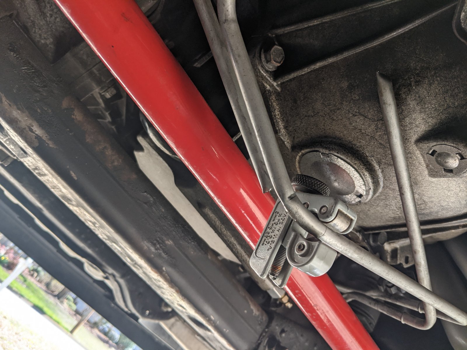

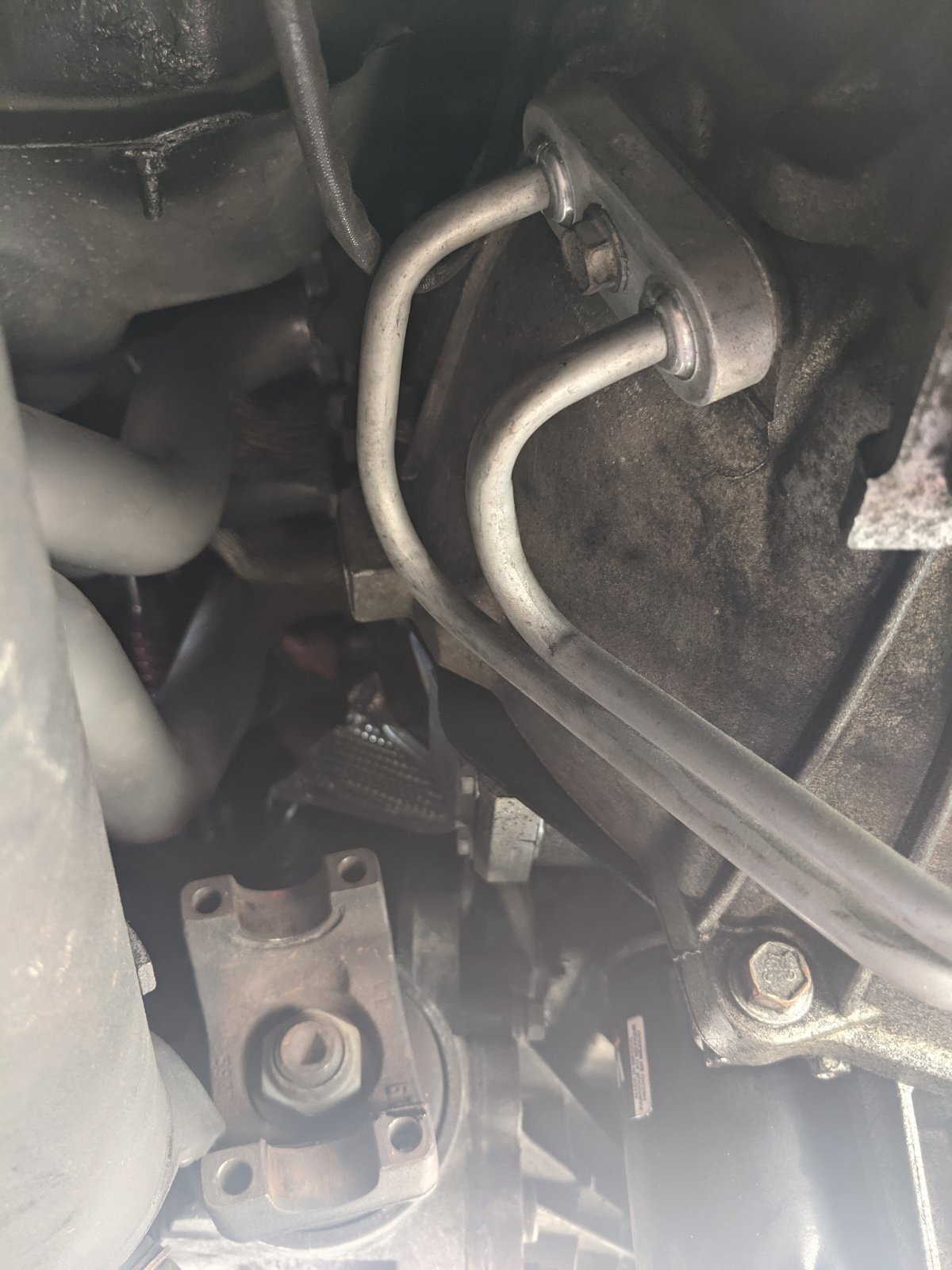

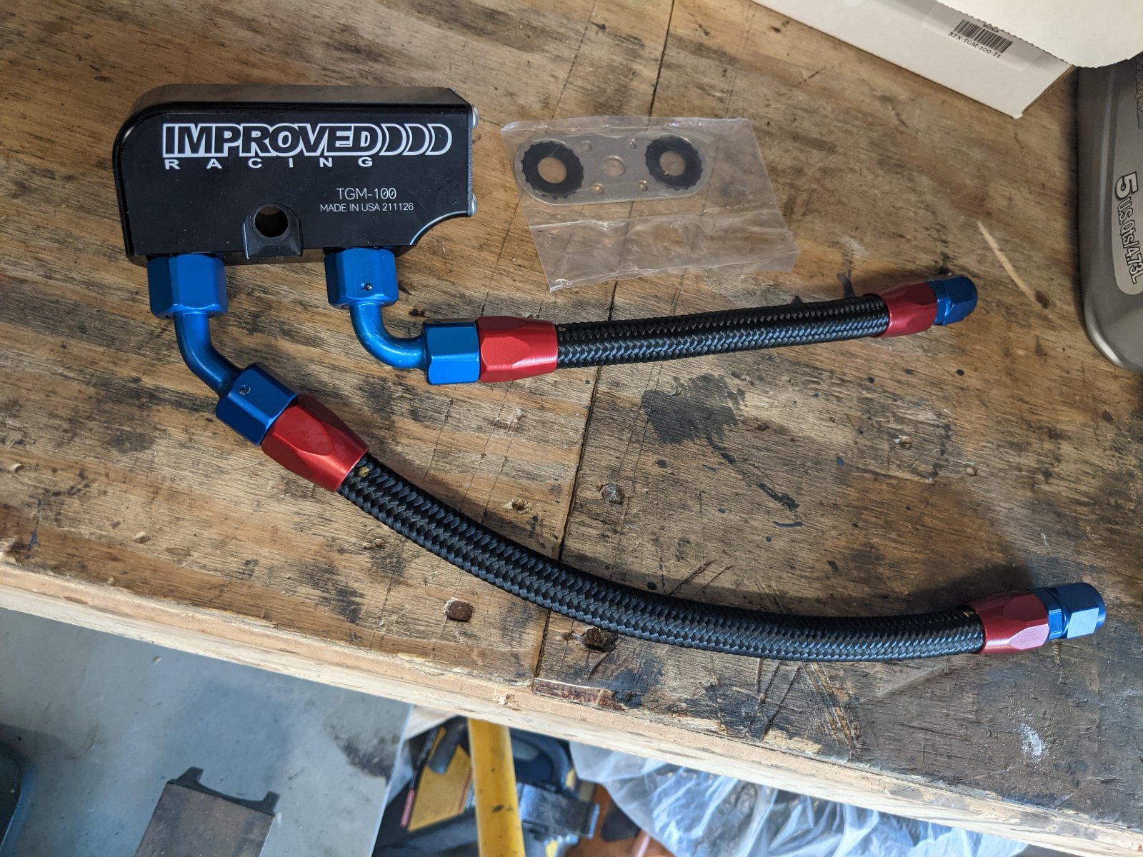

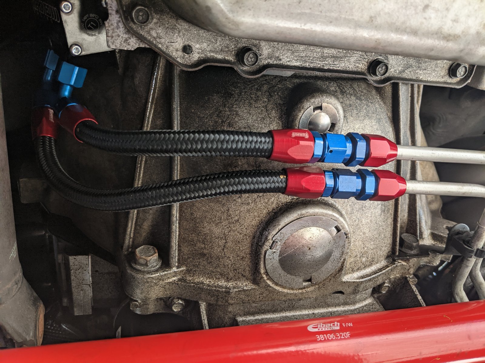

New product from Improved Racing works so well it really should be factory. Installed on my 2008 Yukon Denali with heavy duty towing/cooling package plus oversized Mishimoto radiator that took forever to warm up previously especially in the winter. Now cold rough shifts are gone in a minute or two, and it takes about 10-15 minutes to hit 140 in the cold.
Installed in an afternoon with a few fittings, hose, tubing cutter and a half a quart to top off after the fact. They don't have a complete kit yet but I believe they are working on it. Pretty simple to make the hoses, plus they will make custom hoses to order. You'll want to pull the front driveshaft if you have 4wd/awd too. Here is the parts list I used:
140* thermostat
90 elbow 6an oring to hose end45 elbow 6an oring to hose end (60 degree would work better for upper fitting or another 90 with a spacer so they don't hit)
x2 6an straight hose ends
x2 6an compression fittings
About 2' 6an hose

Are those just compression fittings?
Edit. I skimmed through. I see it’s compression at the end
