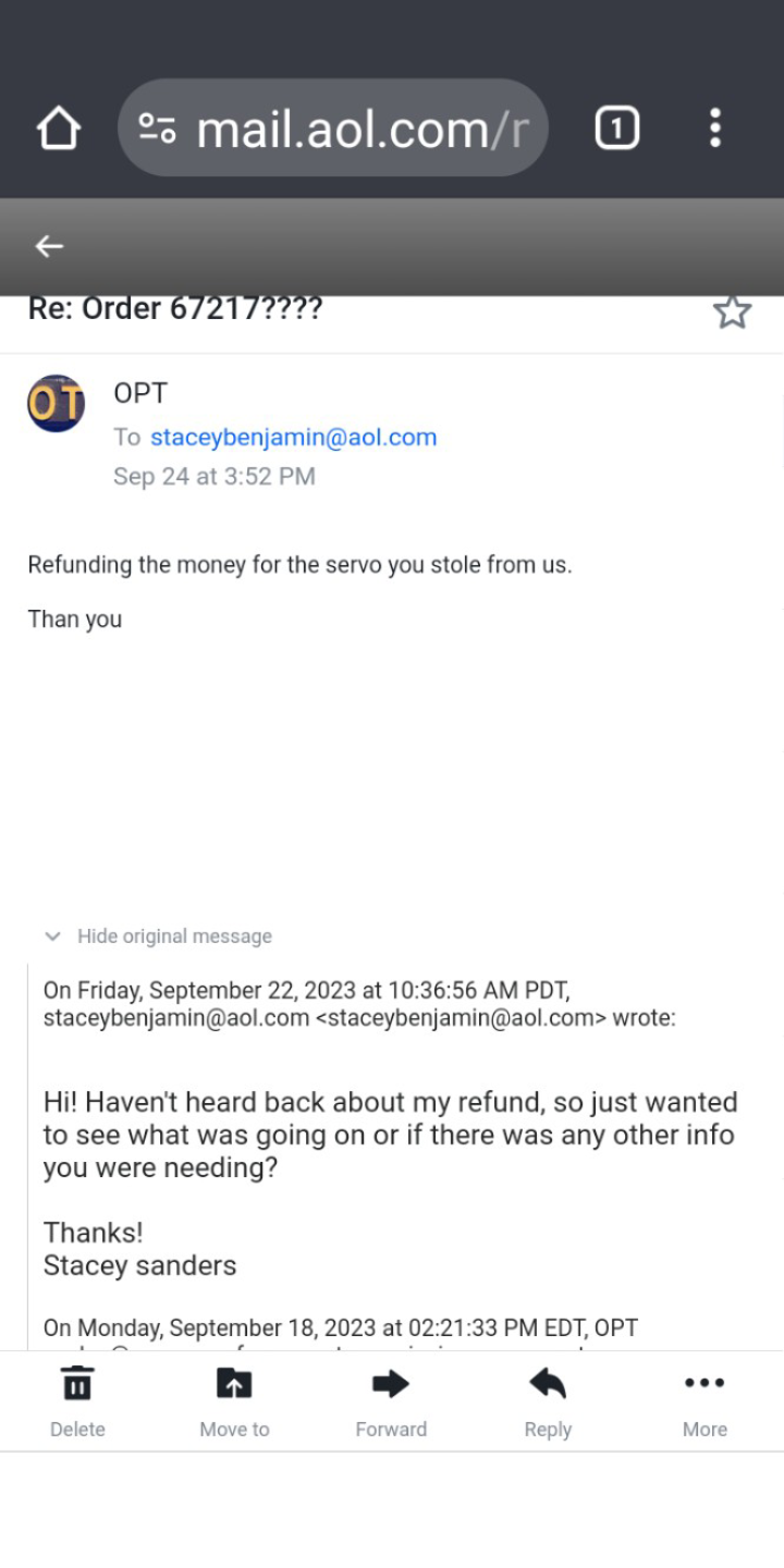

***BUYER BEWARE!!***
This business is apparently some kind of front for scamming people out of money. IMPOSSIBLE to get anyone there on the phone, have to send NUMEROUS emails to even get ONE reply!! I paid almost $100 for a servo, that I never received and when I tried reaching out to get a refund (because honestly, it's exhausting trying to find a way to reach out to them and not being able to talk to anyone, after almost 4 days of trying to contact them!!) Only to receive an email accusing ME of stealing from THEM!! I mean, WOW!!!! Apparently this is what they do, steal from hard working, honest people, steal those people's money, then try to turn it around on THEM!! WORST COMPANY EVER!! DO NOT BUY ANYTHING FROM THEM!! Unless that is, you want to get ripped off! I attached a screenshot of their reply email to my post.
