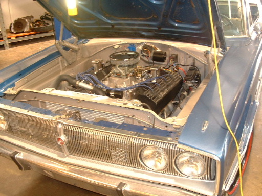

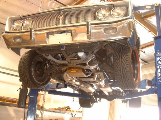

( photo ) .. A '66 Dodge Coronet with a 200-4r, handling a new 750 HP, 426 Hemi. I did the custom coolers for it,... then I "had" to test drive it..... Oh, my gosh !!

I was with Art Carr when he coordinated with Torco, to produce packaged transmission parts, certified & labeled as " Art Carr parts " . But.. the deal was written poorly for Art. Art accidentally sold his name to Torco inside the pages of the deal. Art could not use his name at his shop in Huntington Beach, Ca., anymore. He renamed his shop, " California Performance Transmissions". So, having said that, no not trust the "Torco - Art Carr parts". He dropped the scammy deal.
In my '88 GMC, I considered using the 200-4r tranny, but Art convinced me my 700-R4 will be stout. He built it to withstand 650 HP, all day.....
While I was there ( I, R&R'd transmissions and installed custom coolers ) .. We loaned the shop, after hours & weekends for Chip Foose's "Overhaul'n" show for a while.....
When you have a moment, you should try to contact my good friend, Kenny Youngbood, he lives in Henderson, and is quite connected in the car culture.

Awesome looking Coronet and sick set up - looks like you do great work!!
Would love to know what went into that 200-4R, guessing re-cal kit w/billet, large-ratio servo, all sorts of VB and Gov mods, billet int shaft/HD forward drum, dual-fed direct drum w/teflon ctr support sealing rings, Raybestos blues in the direct, extra friction in the OD, fully rollerized gear train and more. I've only built a little over 50 or so of those but there's not too many builders that will even touch them...They can be very finicky and certain parts, like good direct drums, are getting very hard to find and expensive.
And yes, a lot of people don't realize it but the 700R4 and 4L60E can be built to handle serious power, so much of it is the hydraulics with some choice upgraded hard parts. Many default to the 4L80E, understandably but in many cases, either it's too big or simply not cost-effective (or both).
