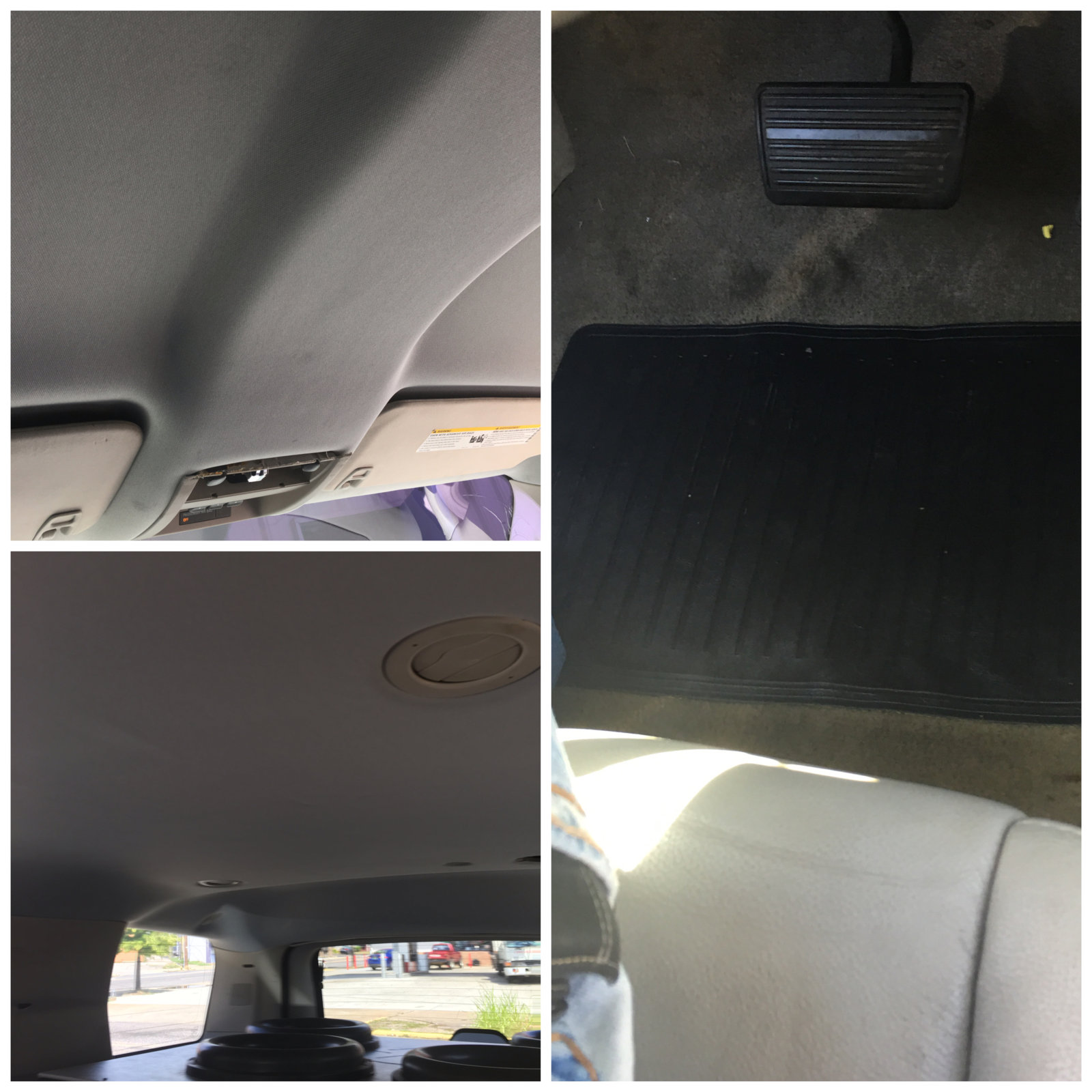

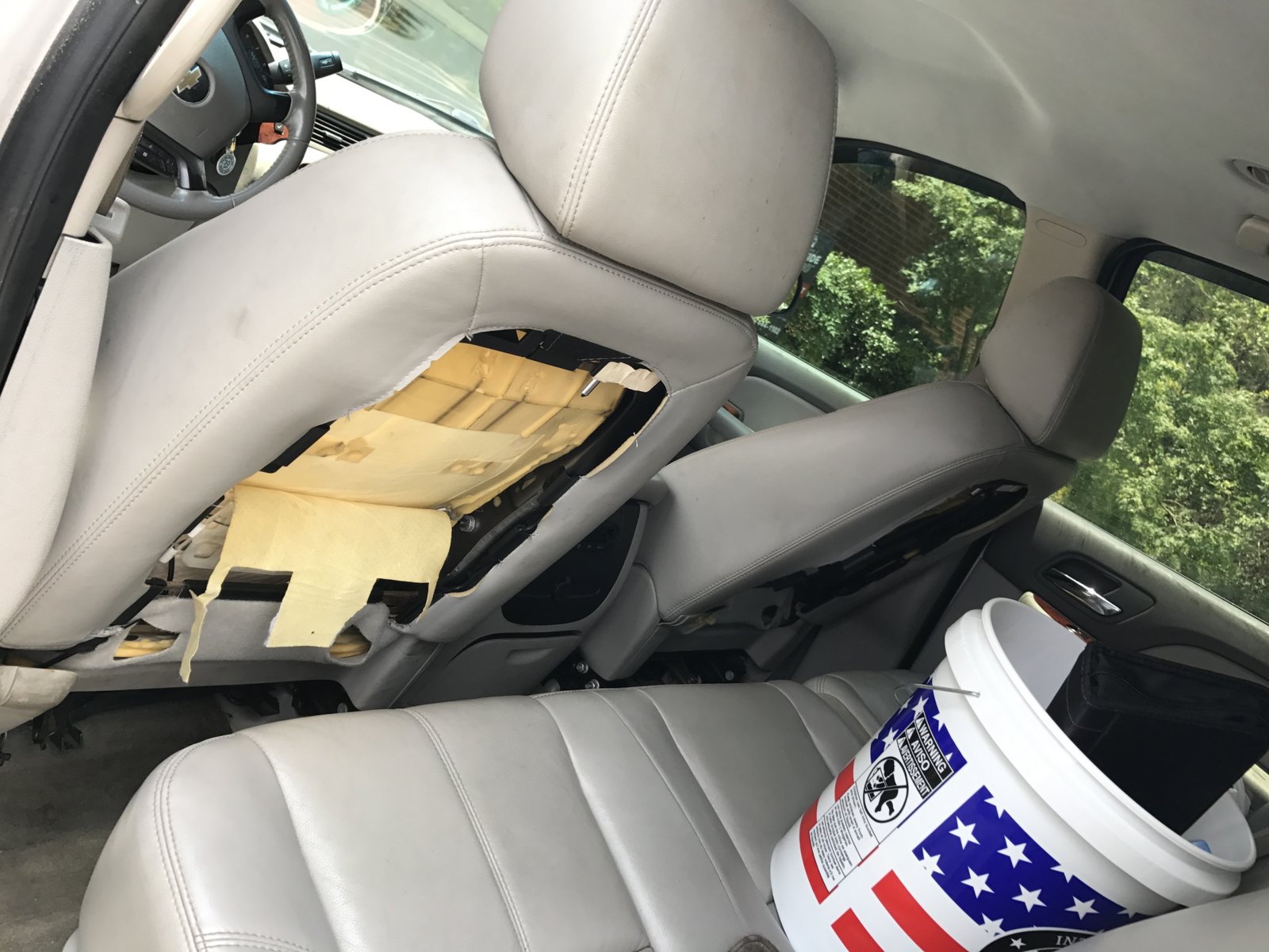

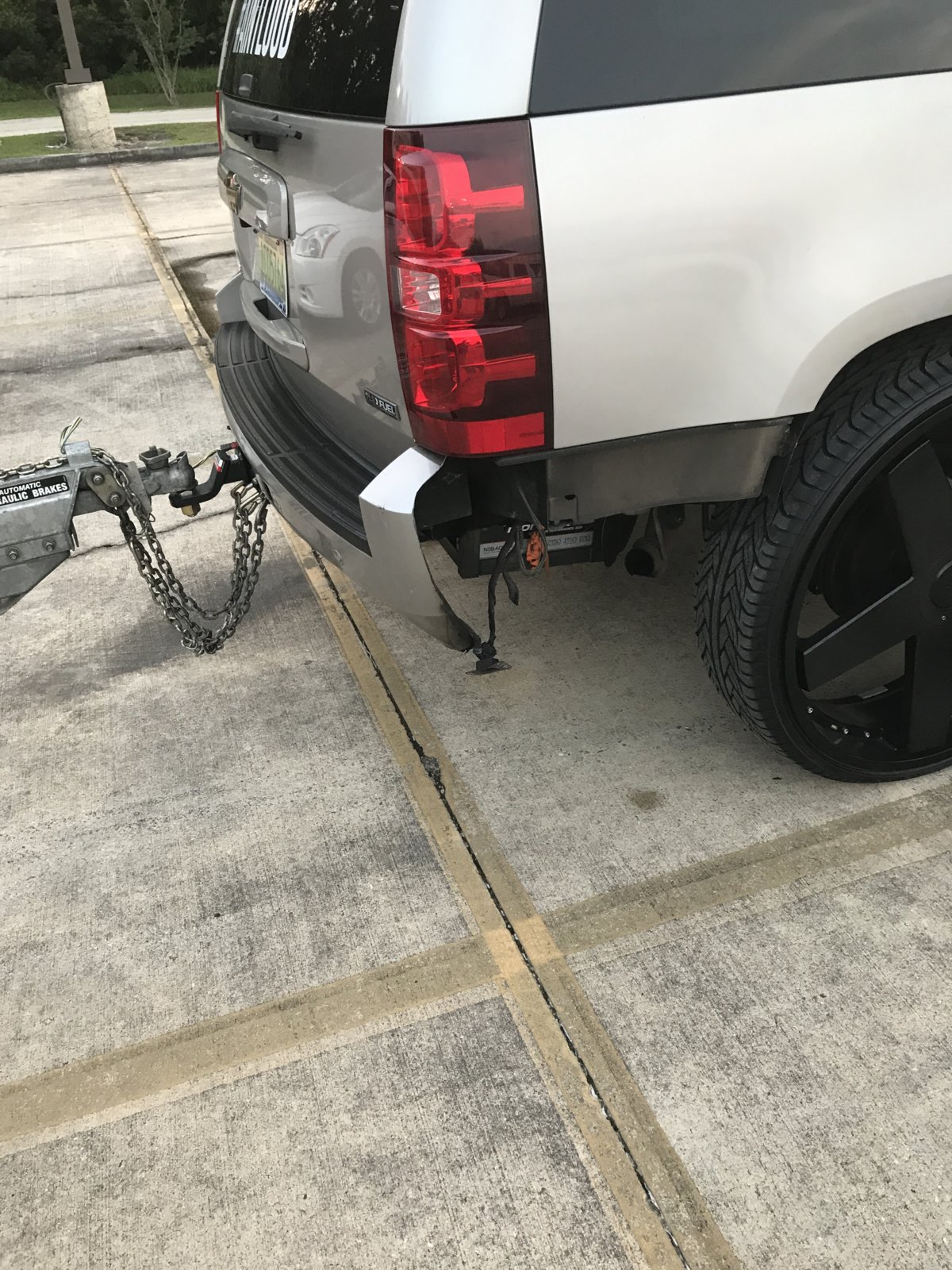

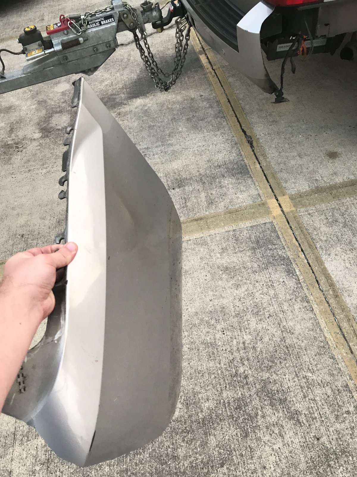

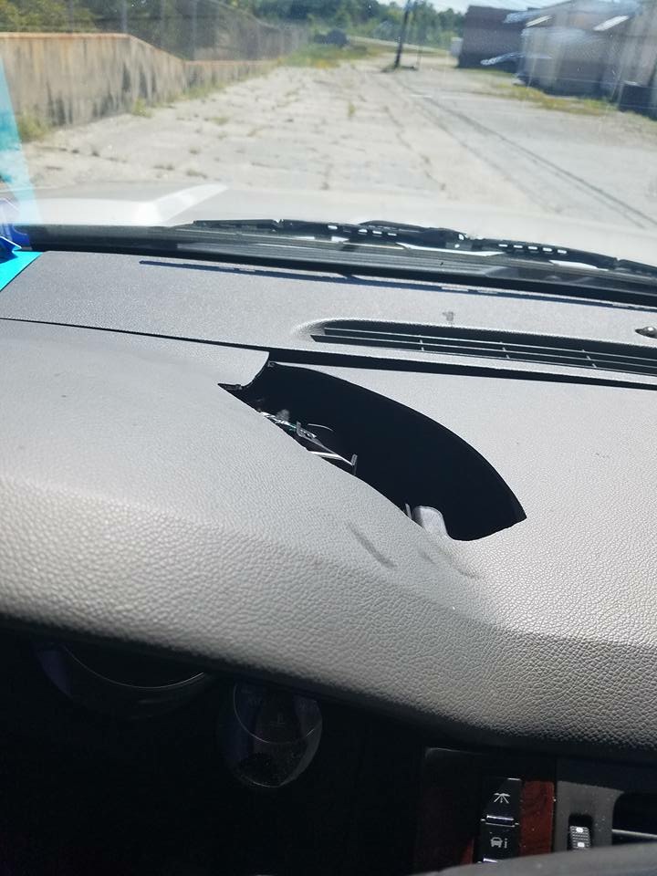

I got my truck a year ago at 112k miles since then my motor went out at 135k, dash desinigrated and I got a dash cap, carpet on driver floor came out so I put n a rubber Matt, backs came off of my front seats, back part of passenger side mirror fell off, door handle fell off, gas cap won't open unless I pry it open with keys, and bumper split n half on me. Man this is my favorite vehicle I've owned but the maintenance is like a BMW! I've read all over the forums seeing that these are common problems. But it seems like it's been hit by a rock instead of like a rock!

Here's more pics of the damage. Most of the truck has been repaired and I'm getting the rest handled n the shop right now. But I am on the prowl for good seat covers.

Didn't the back bumped break because u have 30" rims and the tires rubbed and broke it? My guess is your hauling a trailer in that picture and it made the tires rub and rip that side panel off

You can't call it a "lemon" as it's had so many owners and is obviously well-used and even abused. The parts that have broken are common failure points when these things are handled roughly. Well, other than that back bumper thing. I don't know what to say about that other than agreeing with Nate that maybe the trailer caused the back to come down a little too far and the oversized wheel caught it. Kids yank outward and downward on the flimsy plastic door handles and they rest their feet on the seat back pockets which pulls the panels off, so that probably explains those issues. They're all relatively easy fixes, though. My '08 has 172,000 miles on it and it looks like it has maybe 30,000 miles of use. I'm the third owner. The original was some sort of professional that apparently didn't have kids, and judging by the nicks in the hanger hooks, I'd say they bought a full-sized 4-door SUV just to be able to hang their business suits in the back when they carry them to and from the dry cleaners. The second owner was the wife of the used car lot owner from where I bought it. So, it's all in how well it's taken care of. The rest of the issues are gonna happen no matter how well you care for it because they're design flaws. Mine has the cracked dash, broken motor mount and failing hatch lock assembly. Your motor going out so early was probably due to the AFM system failing, which could very well be from poor maintenance by the previous owners (irregular oil changes/cheap oil causing sludge buildup in sensitive AFM lifters).
