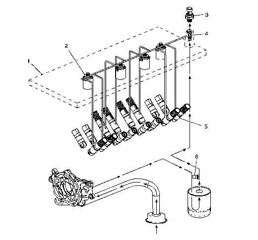

See that # 4 filter ? It's a bugger to get out. But take it out and clean or replace it. And as posted above keep your oil and filters clean.
992dr
Oct 8, 2009
3,287
1,355
Eastern N.C.
See that # 4 filter ? It's a bugger to get out. But take it out and clean or replace it. And as posted above keep your oil and filters clean. View attachment 231595
Thanks for this info. In all honesty, this is the first time I've seen this filter brought up. At least that I can remember.
How often is it supposed to be changed?
What is that filter called, I cant remember for the life of me.
Thanks
Thanks
Oil pressure sensor filter.
