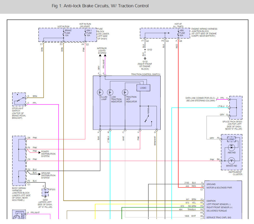

exp500
May 14, 2017
2,026
1,985
3 MPH on a drive around? According to print on post 24 the VSS wires straight to pcm. I wish you had a VSS plug so you could jack rear wheels and see if you have AC output from VSS.
