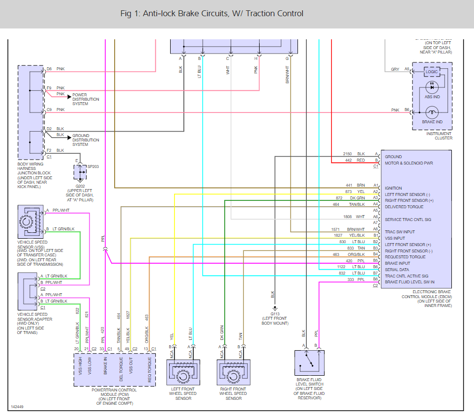

From what i have read the rear abs on your tahoe gets its signal from the vss in the transfer case.4wd top left of transfer case .2wd left rear side of transmisson i bet thats your problem.Again just go to autozone it will take 5 minutes and they will give you the code.Buy a new vss if thats the code takes 5 minutes if that to replace.I have to add talked with my chevy tech buddy he said sometimes they dont throw a code also-just have similar problems like you have.

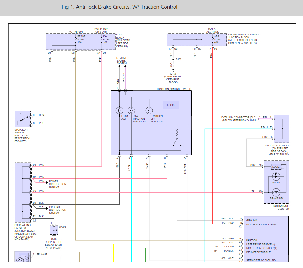

Awesome thanks for the schematic, ive already changed the vss in the trans and still the same issue. Now that i have the layout ill start removing loom and testing wires.. im afraid to drive it to our parts store as it only runs in second and thats a 40mi round trip. I should be getting a snap on scanner loaned to me soon, codes would help alot if it has them. Also i see on the schematic its suppose to have a fluid level sensor, once again mine doesnt have one. I wonder if it being a ppv with hydroboost setup has something to do with it. Ill keep everyone informed on what i find, REALLY appreciate the help

Ok so you have a 2wd vehicle then right.Here is the rest of the diagram

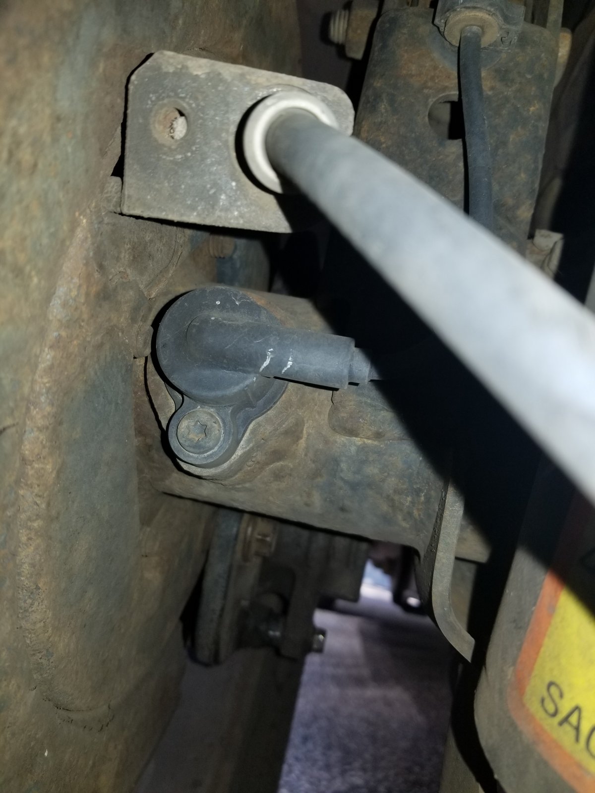

Rear sensors are in the axle I believe. Near the wheels.
No their not sorry-gets signal from vss in trans for rear input-i think that fix in your module should take care of it.If it had that many problems and you changed the vss already if not.Get ready to track down wiring.

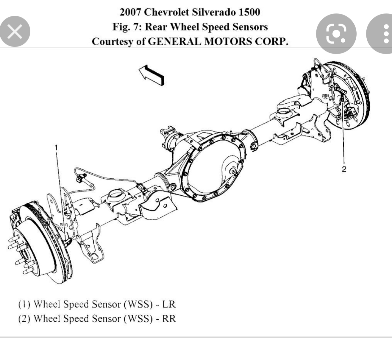

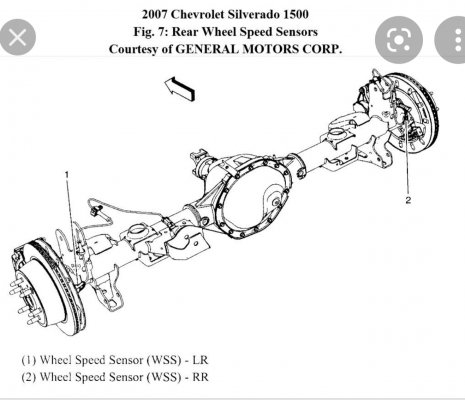

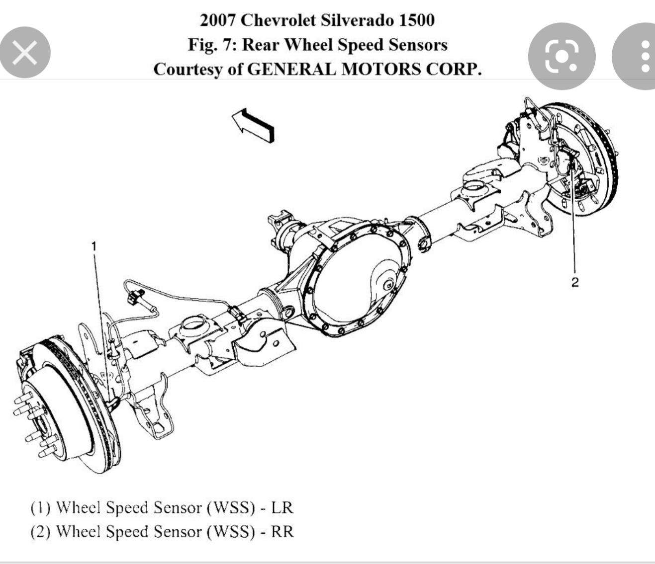

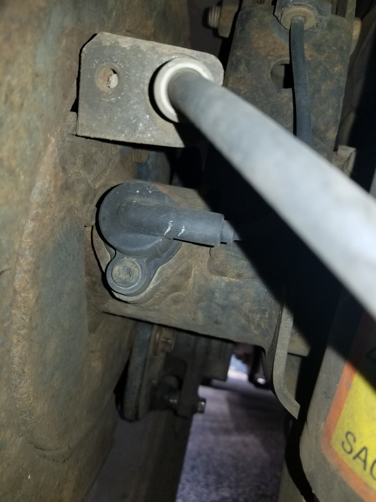

OP has '05 Tahoe right? They're in the axle on my '05 Yukon. (see pic) And here's also a illustration of an '07. We talking about the same thing?
