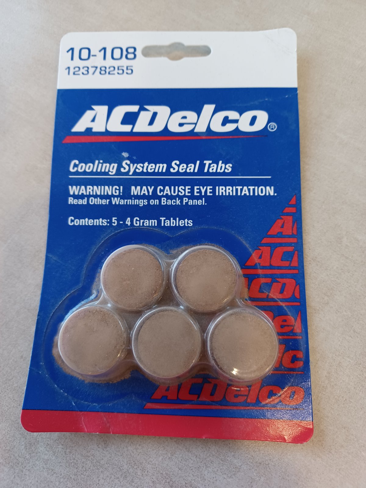

These have been known to help too.

I should have been more detailed. I was referencing @Tonyrodz post. I have seen people get more miles down the road with this band aid for very small leaks in the entire cooling system. Hell I have seen, but do not recommend, pepper clog small leaks and have never seen it but heard of a raw egg doing the same. Redneck band aids for sure but have seen/heard of them.
Those are old school fixes for sure. Never tried those myself tho.

When i worked at the GM dealer in the early 2000s thise were the dealership fix. Not kidding.
That's where I heard about them when I was in my shops. Band-Aid at best but like lots of things in a dealership, it was "good enough".
exp500
May 14, 2017
2,026
1,985
From the 70's up they all left factory with 2 pellets! I don't know if that ever stopped.

Ive used the pepper trick back in the early 90's on a small leak on a radiator to get me by until I could get the radiator fixed (brass tanks). It kept me going for a month or so.
