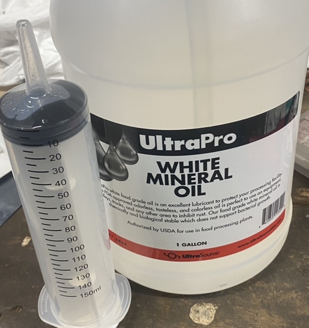

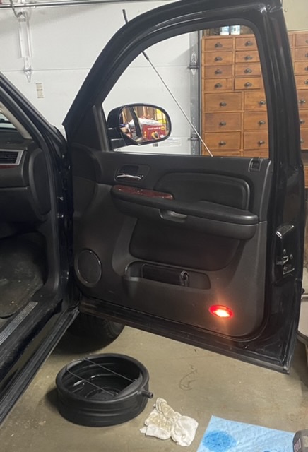

I have some catching up to do and also some updating to do but I’m treating the most common rust spots today on my vehicles and I don’t believe I’ve ever shared this and what I do so I figured I’d throw it out there.
Starting with the doors, the bottom and back side of the door skins are prone to collect moisture and debris where the outer door is folded around the inner door. It’s always best to remove the door panel and clean out anything that has collected in there while it’s dry. Doesn’t have to be perfect but a blow gun to loosen it up followed by a vacuum is the way I do it. I don’t have any pics of that because today I’m only treating it do to limited time.
There are a few different things you can use, ATF works great because it has a lot of detergents in it but it does leave a smell for a few weeks. Petroleum jelly warmed to a liquid is also a good treatment but takes a little longer. You can melt it in microwave or by using a heat gun in a metal bowl or container. What I find easiest and cheap is mineral oil. You can pick up a gallon for under $20 and it doesn’t need to be heated or have any smell. Baby oil works for this too.
The syringe I got off Amazon a while back, they’re cheap. Like $6 for a pack of 3.
Then I take a piece of 3/16” brake tubing and cut it so it reaches the bottom of the door thru the window channel and leave some extra so I can do all my vehicles and also reach in from the rear after removing brake light from my truck and get to the top of wheel arch.
Just roll down the windows and feed the brake tubing in between window and seal. For the back of the door I like to start high and allow the oil to run down the seam. Then fill up the bottom of the door by moving the tubing to 3 different places along bottom. I use about 100ml of oil for each door and attach to brake tubing with a piece of 1/4” hose. Just put some towels and drain pain down to catch the oil as it drips out.
I’ll go in from under the hood into the back of each fender and use about 60ml to treat the drains. Remove sill plates from inside doors and put oil into holes to get it inside rockers. I usually hit that the hardest. Couple different ways to get above rear wheel wells but you can get to it from removing brake lights. May have to put a slight bend on tubing to get the oil where you want it. Go crazy with it and get everything and anything coated. The more the merrier. I usually do this every 2 years. Last couple years I’ve been slacking so I’m really going to town this time.
Just sharing something easy and cheap to help others try to keep their vehicles and investments clean and as rust free as we can keep them.

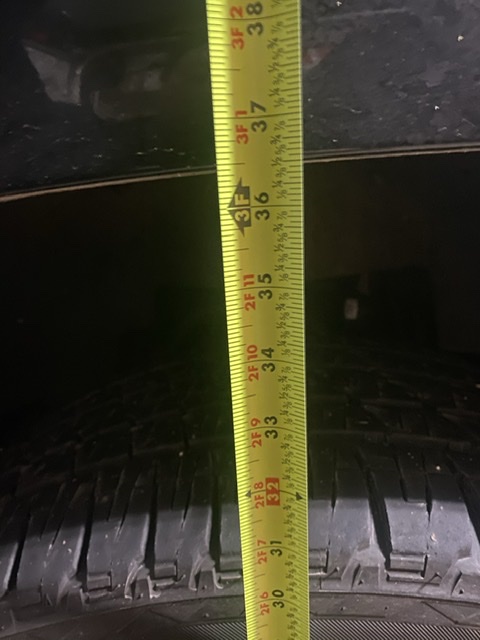

Back to where I left off on this rig. The place that was repairing that small crack and powder coating the wheel for me kept pushing me off because they were busy and telling me it was 2 weeks before they could get to my rim. I said screw it and had to put the wheel back on and give her the vehicle back. I’m losing about 2lbs every other day so I’ve been having to check and fill the tire until they call and tell me to bring it in. I almost think they have forgotten about me but I’ve been busy so I haven’t called them either. I need to do that.
But with wheels on, tire pressures checked I’m sitting at 36-1/2” to wheel well. I’ll check it again in a few weeks and see if it has settled any from the new springs settling in.
I wouldn’t say it rides any better or any worse. I wasn’t expecting a miracle but I can’t positively say the old struts were bad. They didn’t leak, but I’ve always thought this thing should ride better than it does. Idk, maybe my expectations are too high for a heavy SUV. It doesn’t “float” either or have body roll so I guess it’s as good as it should be. The new rear sway bar end link and bushing feel better though. I’m still waiting for my electronic struts.

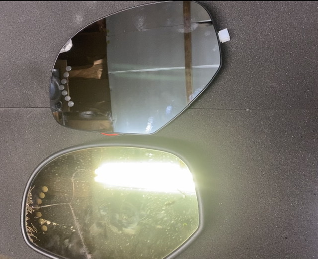

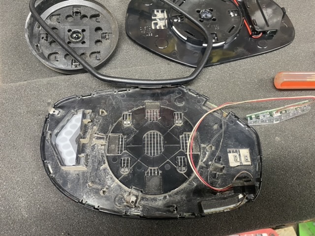

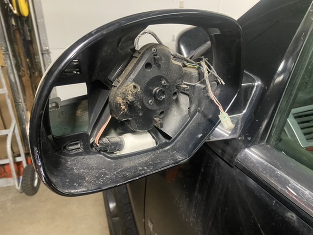

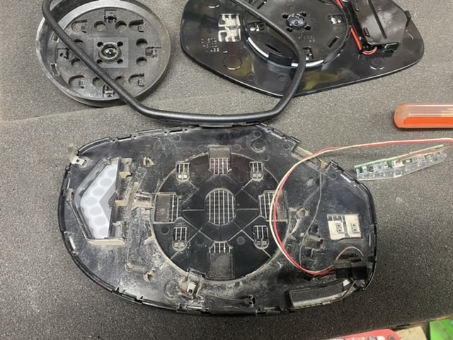

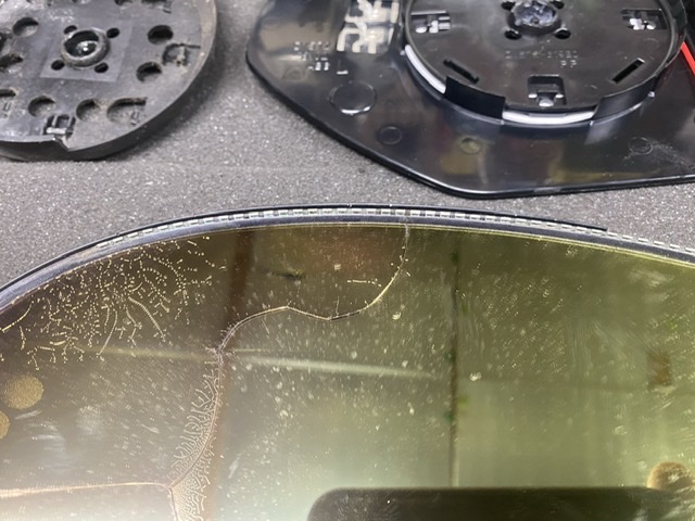

She took out the drivers side mirror on the garage door a while ago and I finally got around to changing that out. Started by removing the top of the housing and then you can get in there with a long skinny flat blade screw driver to release the tabs that hold the mirror to the motor plate.

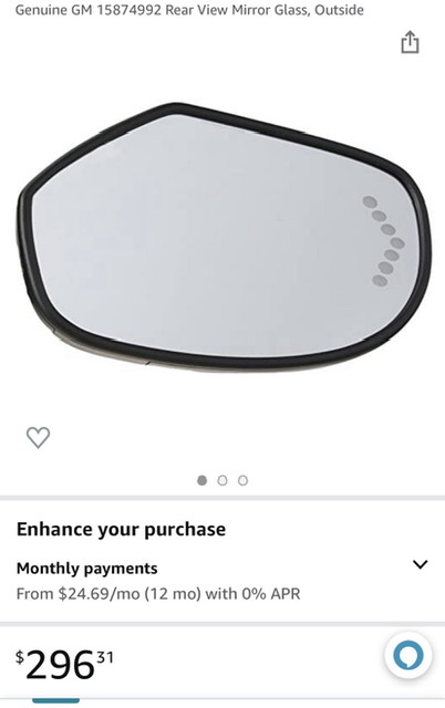

The replacement mirror is heated and has turn signal but it didn’t come with the light sensor for it he autodim. Kinda made me mad because it said it was a direct replacement.
Another thing you can see is the original has a trim ring around glass where the replacement does not. I was close to returning the replacement and ordering an OEM.

Then I found this and said, I’ll live with what I have.
I pulled off that trim ring to see if I could transfer it but I couldn’t. Probably could have glued it on but what’s the point.
Here you can see that sensor for the auto dim feature. I would like to keep it factory but $300 for a mirror, it’ll have to wait.
I didn’t get a picture of the finished product but it’s pretty self explanatory, it’s just a mirror. Turn signal works fine and it looks like factory so I guess I’m satisfied with the outcome. She is.
Maybe junkyard will have the whole mirror cheaper?
That’s definitely an option. I’ll have to call around or go on carpart dot com. Those motors aren’t cheap either so a complete used mirror might be a buck fity. And I need a motor for the passenger side because it won’t power fold. Maybe they are the same for both sides and I can kill 2 birds with 1 stone.
