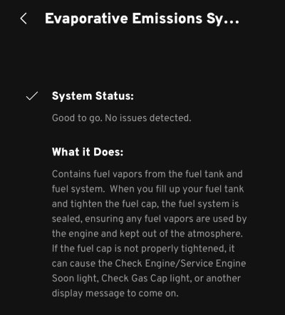

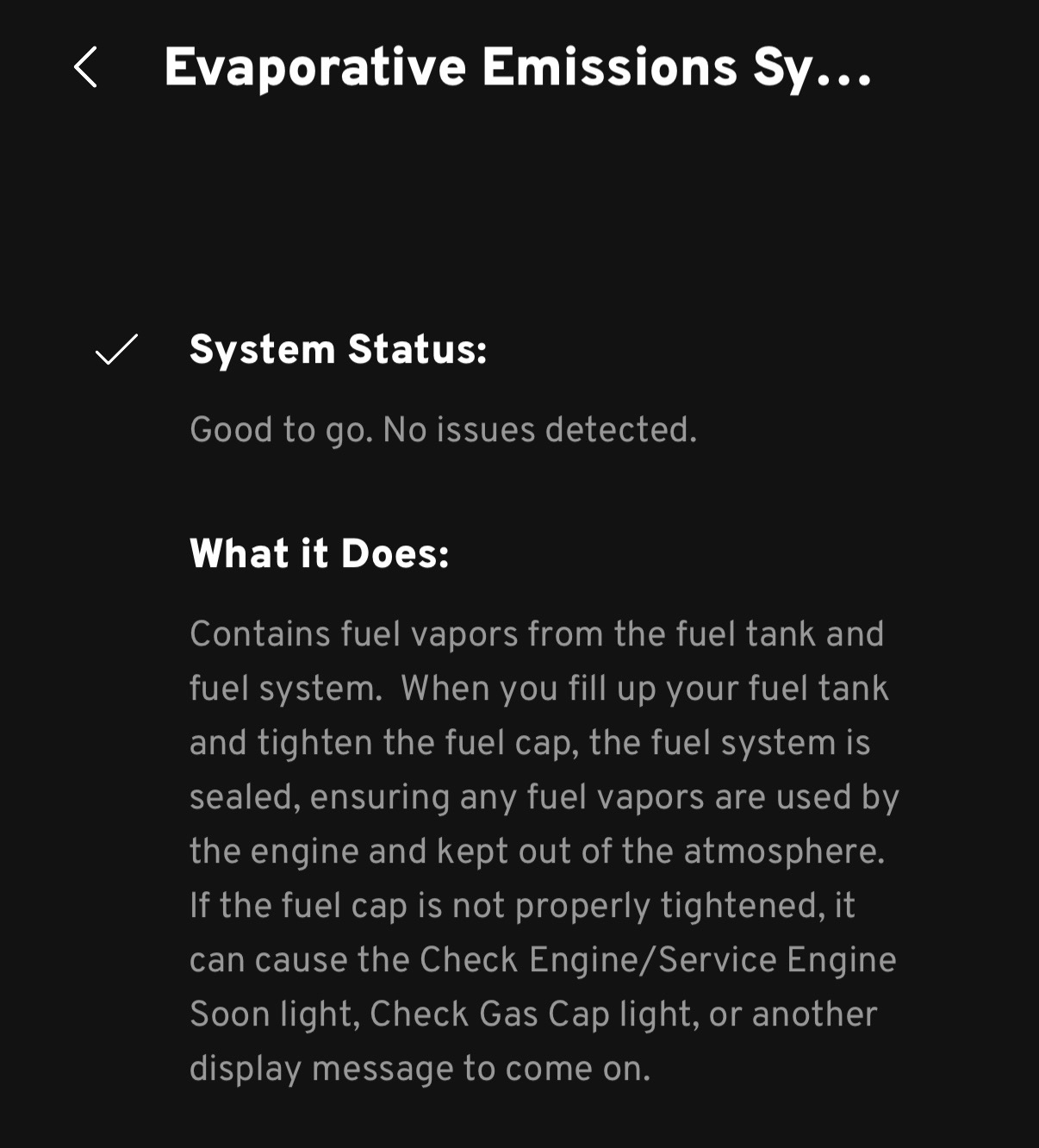

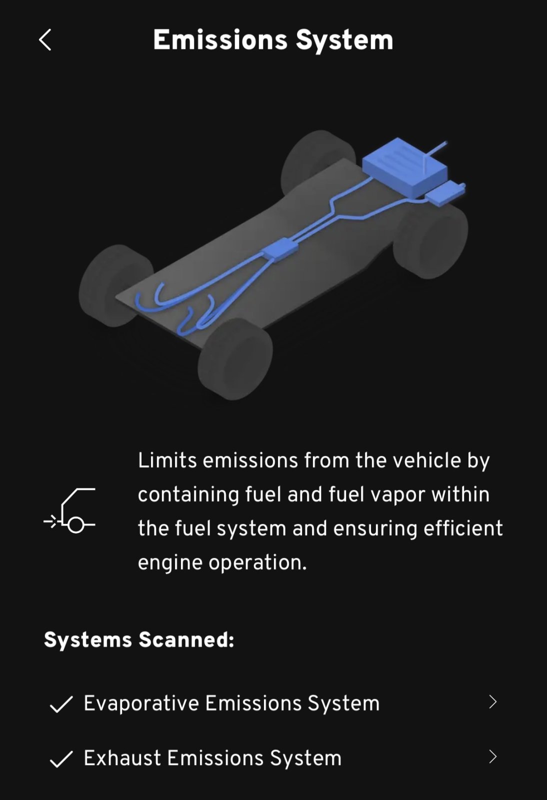

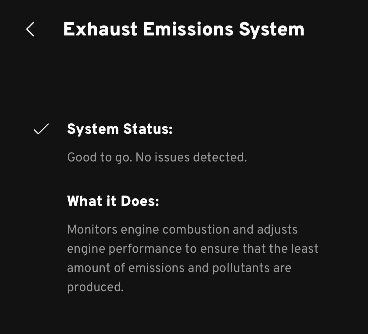

I started looking into that because I have that coverage reflecting as eligible on the myGMC app. It’s weird because the app says my emissions (evaporation and exhaust) are “Good to go. No issues detected “

I had read up on that just yesterday but had never heard of it. Was more surprised that I had already put 1,000 miles and it was still not ready.
