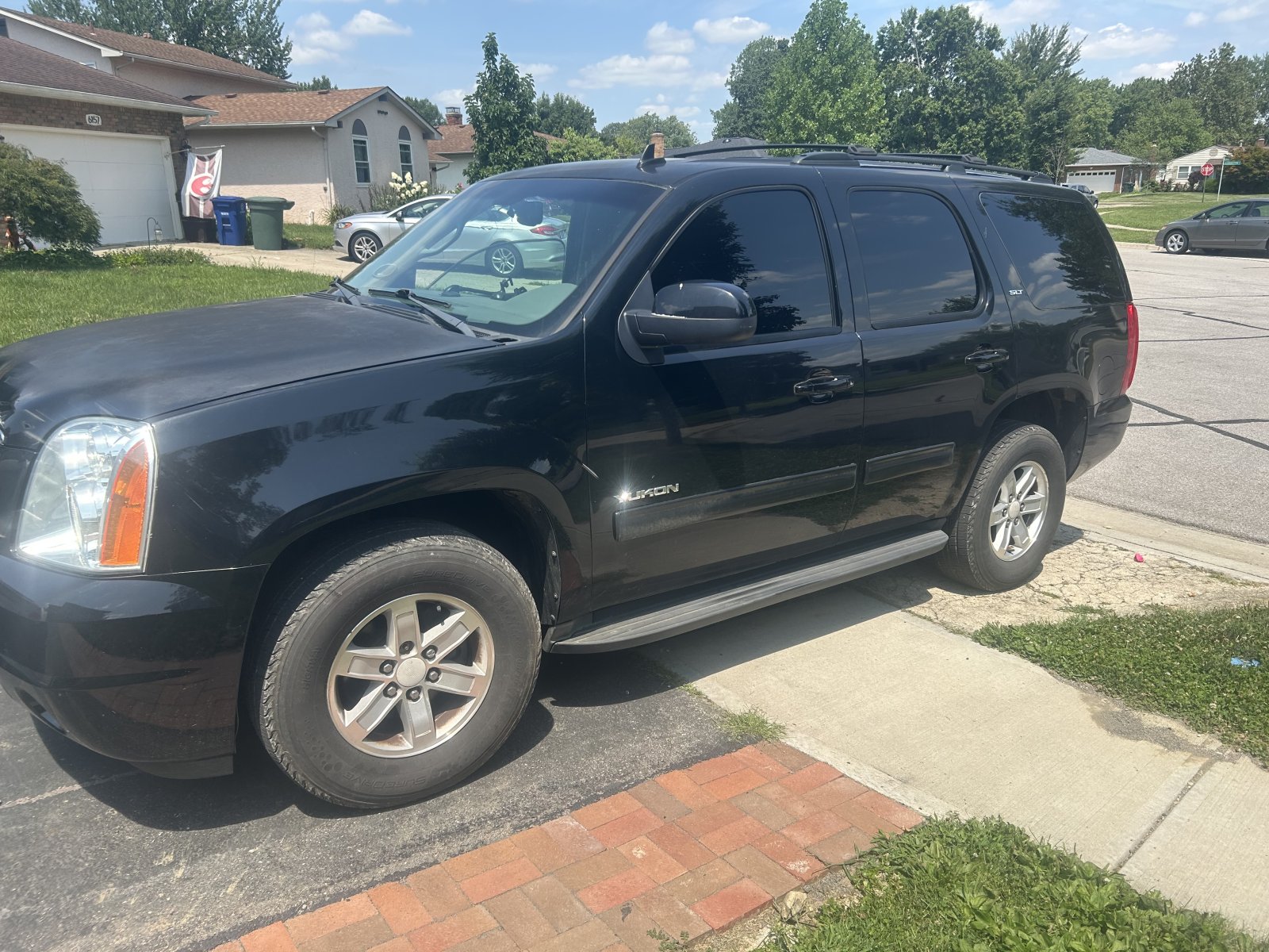

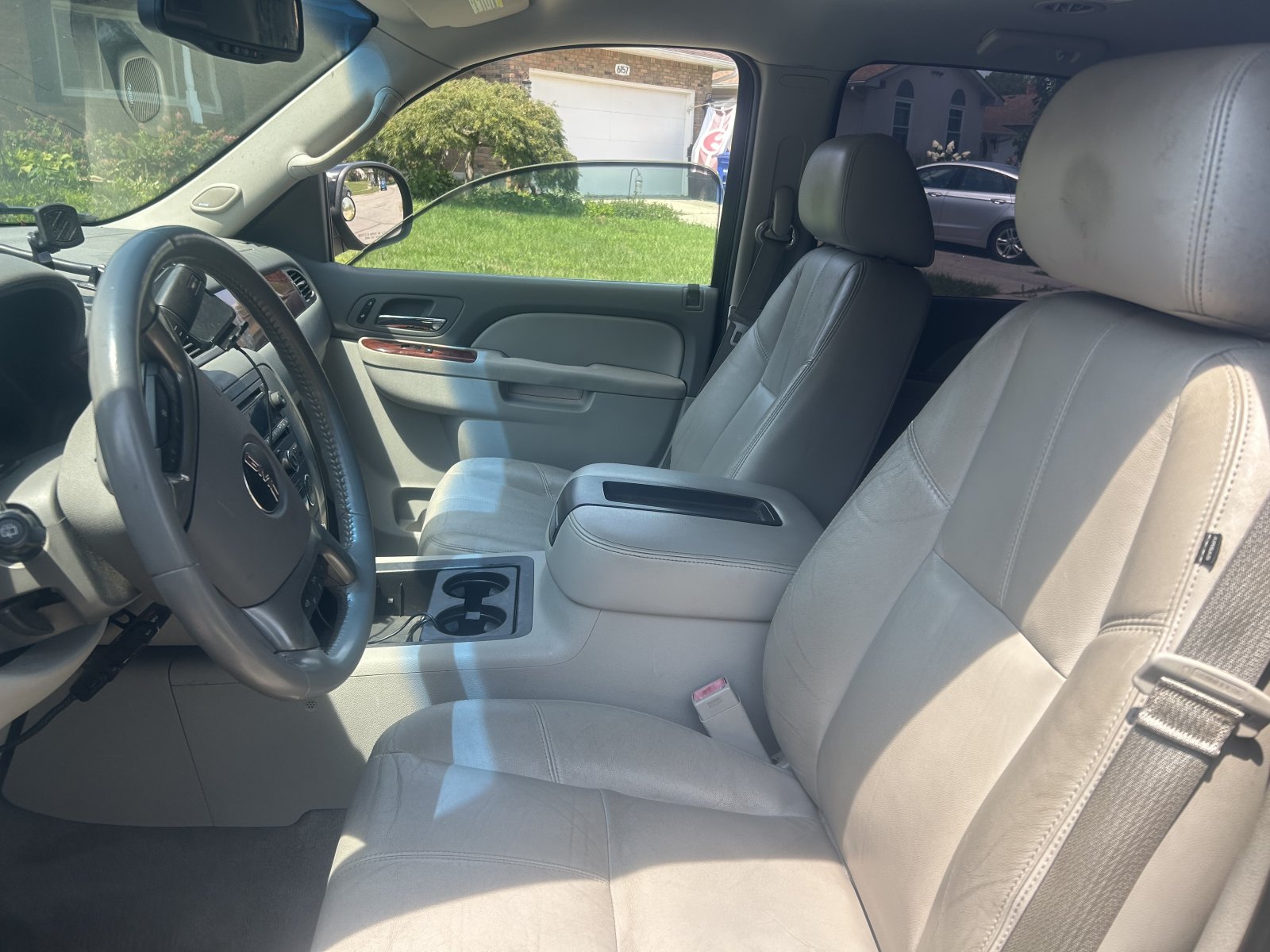

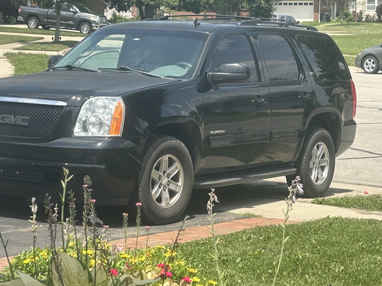

Greetings from Ohio!
I come from almost 20 years in an minivan and was looking for a family car that had higher ground clearance and could tow. After several months of the run-around used car market I am extremely thankful to have found a 2012 2wd Yukon SLT with 160k. I had her looked over by a mechanic after the sale: The transmission was rebuilt at some point previous but otherwise she is in great shape mechanically. Rust free and tires/suspension are good. All fluids were changed 2 years ago.
Ok forum, I have $1500 to put into the car! It will be a 2-3x a week commuter and a trip vehicle, so tell me where would I benefit to spend my money to ensure this baby is ready!
Thanks guys and gals. think I’m gonna fit right in at tahoeyukon!

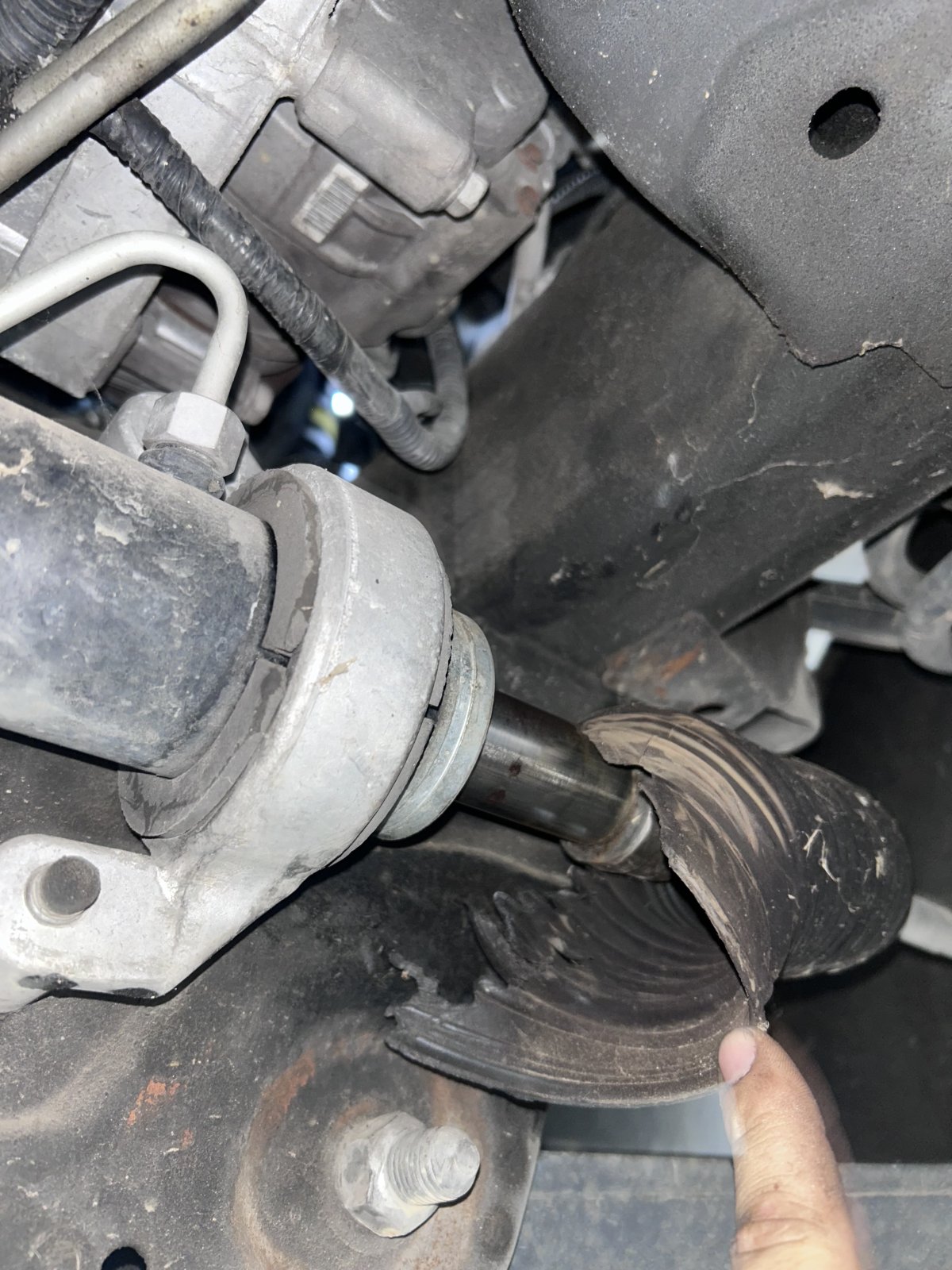

Hello OregonVet! unfortunately the car came with no paperwork. The lady selling it had a divorce in early 2025 and the vehicle was not maintained since that time. She bought another vehicle and it sat for the last few months. It needs a power steering pump and an oil change right away. Also, the rubber boots on the steering components are ripped. The steering seems solid for now, so I would probably regrease it and replace the boots for the time being? The previous did put LED headlights on the car due to living in a deer-rich area. It also has trailer brake control inside. Besides these things , it seems to be stock condition.

No paperwork. How do you then know that all fluids changed 2 years ago? That would have been before the divorce. Did she just volunteer that the fluids were changed? Did you ask and that is what she said? If it cannot be proven, then assume that it was not done. Like @Joseph Garcia said, the fluids are very important. Reason for p/s pump replacement? Does the pump leak? How are the hoses? Is that something the inspecting mechanic found? If boots on front axles, tie rods and ball joints are ripped, then components likely are needed and not just boots. Again, is that what the mechanic found? Rebuilt transmission proof? How was that determined? IMO, you have an easy way to spend that $1500 pretty quickly....and then some. Trailer brake control means that it was used to tow and that could be why the transmission needed a rebuild, if in fact the transmission was rebuilt. So many times the stock transmission cooling package is not set up for the towing that is done and the rear suspension can suffer excessive wear from the towing. Again, it would be great to know what the inspection mechanic said.
Please don't think I and others are picking on this purchase. There is just a lot of assumptions and that always costs money. Better to know for sure so that money is spent wisely.

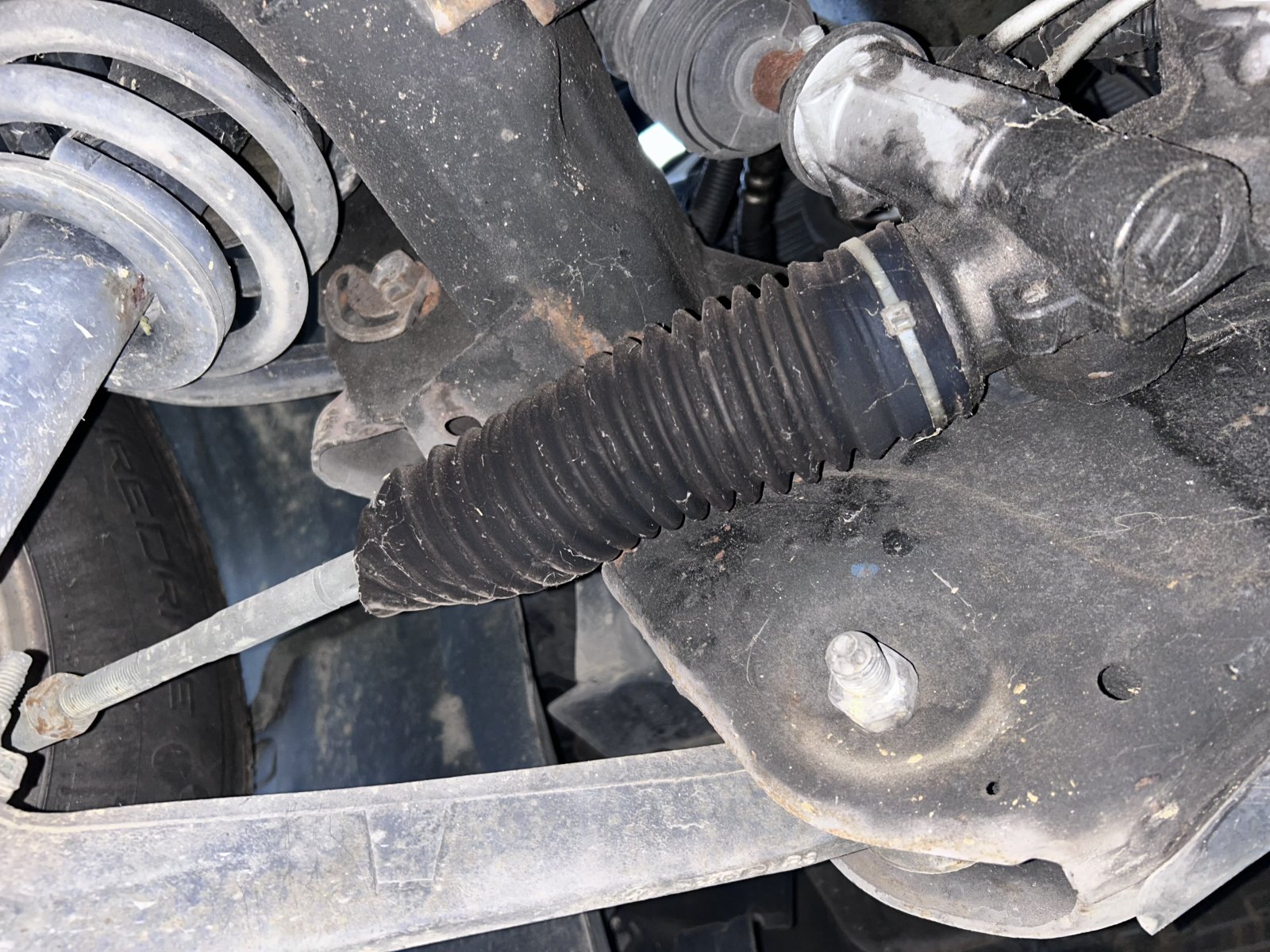

No that’s great! I appreciate your detail. Unfortunately in the private seller used market these days it is tough to get any maintenance records, and more so with this particular vehicle. I’d agree with you it’s probably safest just to go ahead and start with replacing all fluids.
The power steering has a noticeable whine and the seller had an OEM new pump in the vehicle that she just never got to installing. As for the transmission, my mechanic works at a transmission shop, so I’m taking his word for it from the inspection. I think he said he saw a note on the top of the transmission.
I attached a picture of the boot from the rack/pinion
