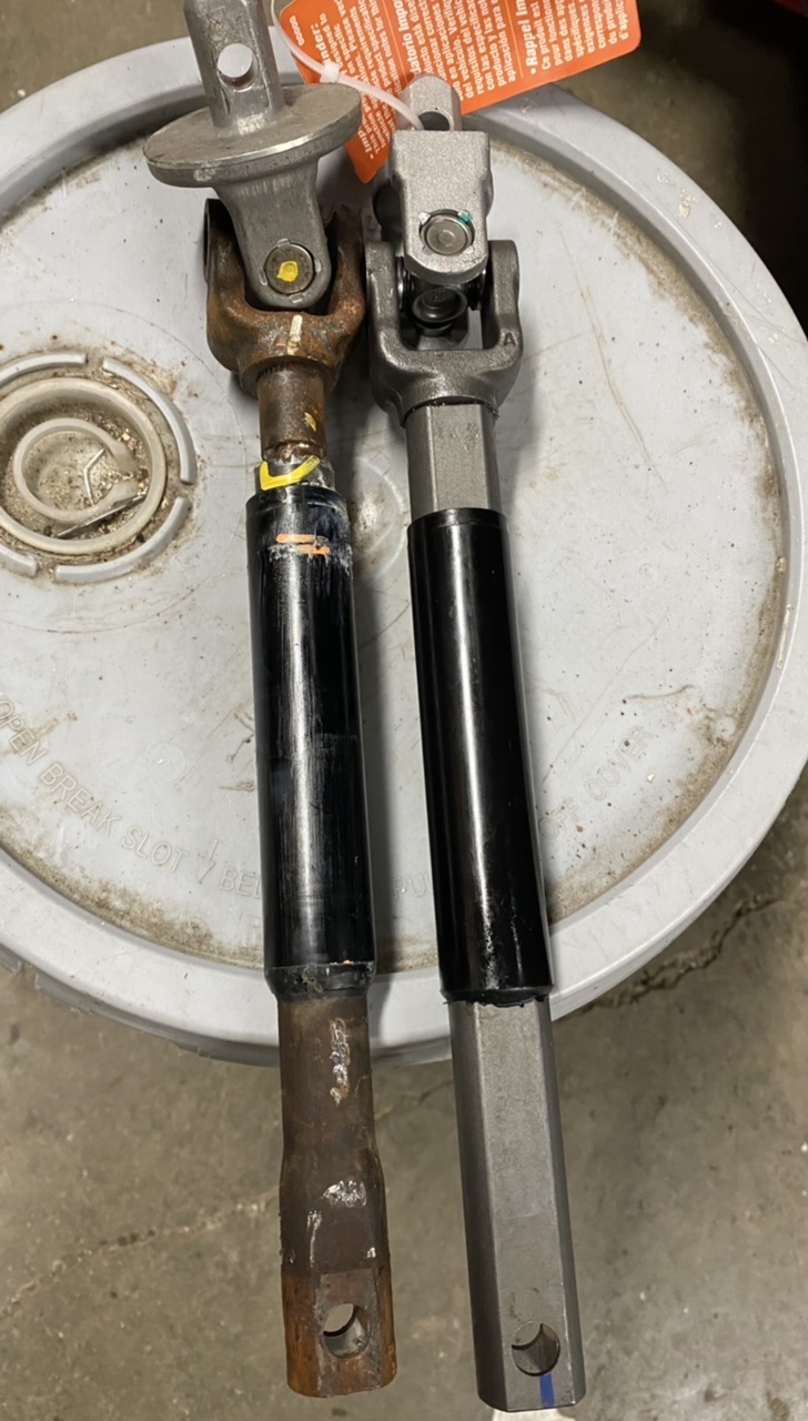

I didn’t get back on this vehicle until 7pm. I really gotta stop staying up all night. I got the new intermediate steering shaft so I started with that. I had to beat the old one apart and then cleaned up the inside with some sand paper. The replacement is a much heavier duty unit.
Put some antiseize on the end and put the shaft together. Then installed it back on the truck.

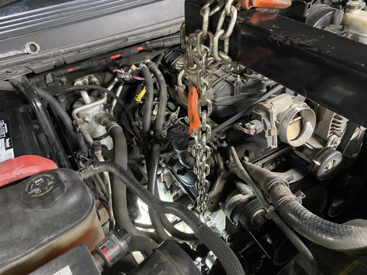

Next I removed the top engine cover and air intake then hooked up the engine hoist to the passenger side head bolt.
With all the ac lines and coolant overflow tank in my way I decided it would be easier to go thru the wheel well to get this side out.
I had a better vantage point from here but it was still a pain in the butt because the angle of the bolts on engine and the limited amount of space to get socket, swivel, and short extension in there and then attach the ratchet. You can’t get it all in there at once.

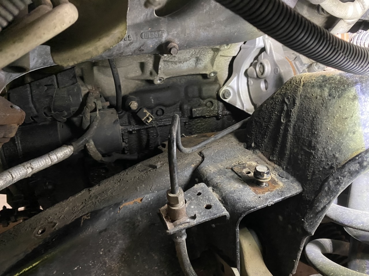

I decided to take the bolts out of the frame side first and lift the engine to give me a little more room. I think that helped but it still sucked. My engine bolts were not tight on this side. I don’t know why these things loosened up or why 2 fell out on the other side, that has me scratching my head.

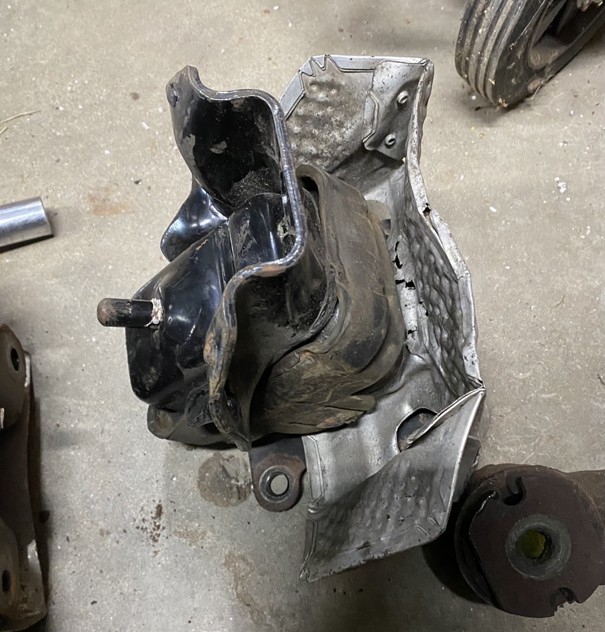

So once mount was free I twisted, turned and fought like mad to find a way to get the mount out but it does fit between the manifold, starter and frame rail when it’s turned and tilted the right way. Don’t ask me how, it just worked.

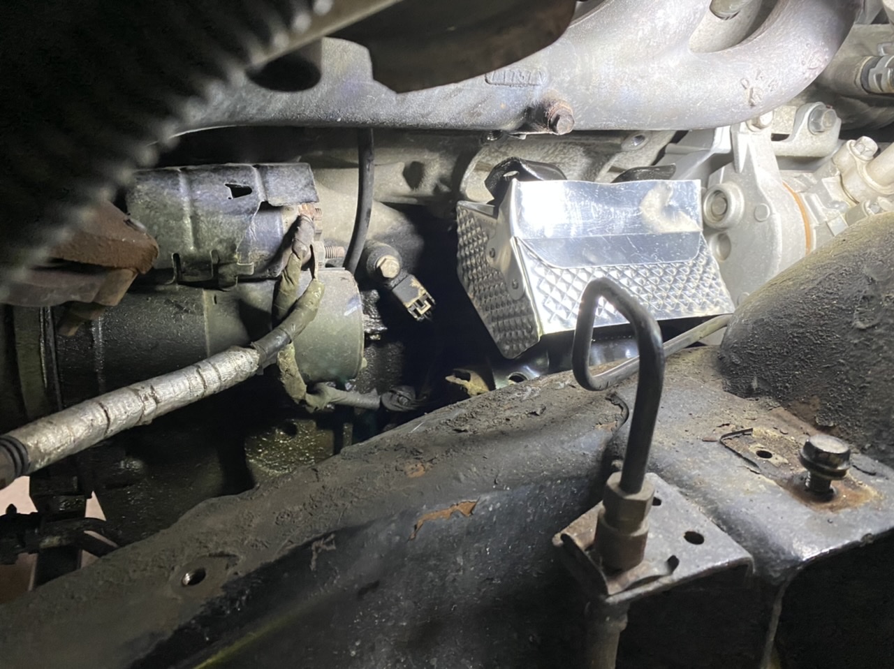

I grabbed the new mount and hurried up and got it in while it was fresh in my mind how I got the old one out.
With the engine still raised I used a liberal amount of Loc-tite on the bolts and fought them back in. Set the engine back down and the frame bolts go in easy.
After that I put the ride height sensor back on, the inside splash guard and then the tire back on.
This engine mount wasn’t bad but this side usually isn’t the one that goes bad. I’m glad I did it though just because the bolts were loose and knowing both are new now.

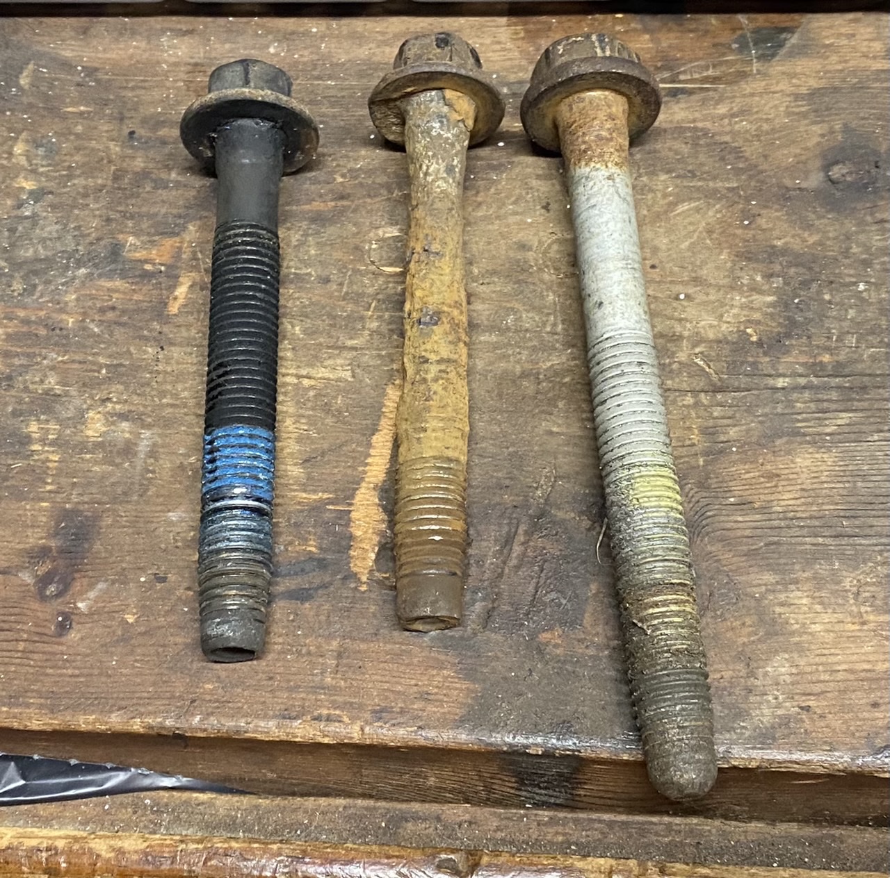

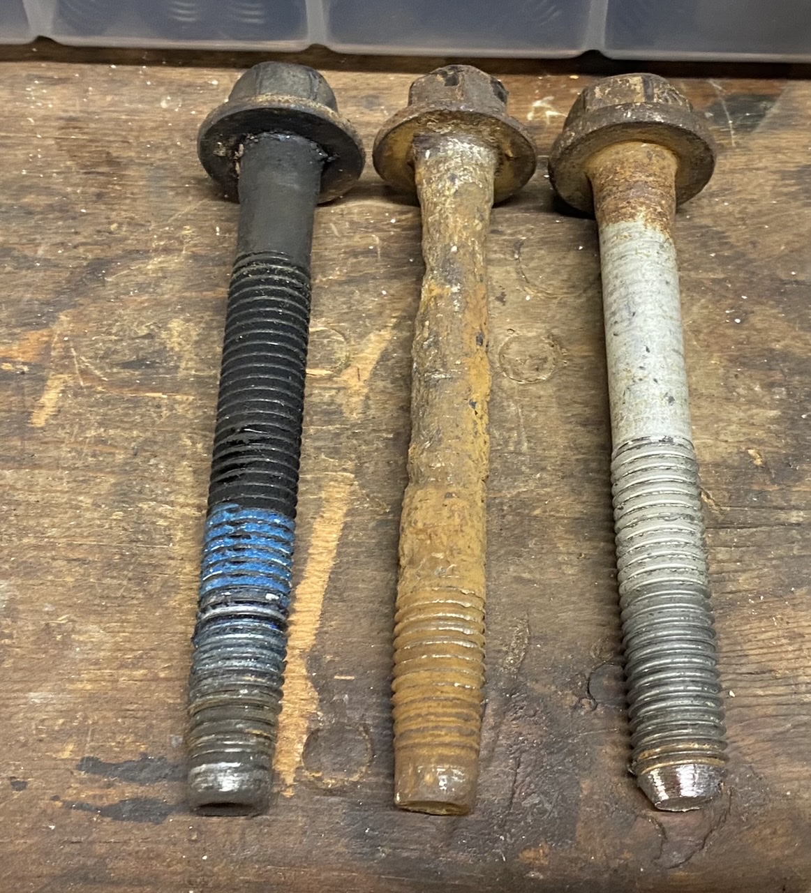

So I went straight for the air hammer today when I got out to garage. Took a little more than I thought it would to get it to come out but I got it. The bolt was pretty nasty and there’s no way I’m putting this back in.
The front bolt compared to the rear.
So now what? It’s 6:30pm on Sunday and I need a metric m12 bolt that has a 10.9 hardness rating. Wait, I might have something. This sucks because I’ve never organized my garage since I’ve moved in because I plan on adding on to it so why bother and I’ve been too busy with everything else so I’m digging thru boxes and pulling stuff off shelves and bingo! I found the body mount bolts I pulled off my Duramax when I installed the nerf bars. It’s a little longer but it’s the right size besides it having an 18mm head instead of the 15mm that the originals have.
I’m a lucky you know what for saving stupid stuff like this. Little trim with the cut off wheel and a little buzz from the grinder and I have a bolt!

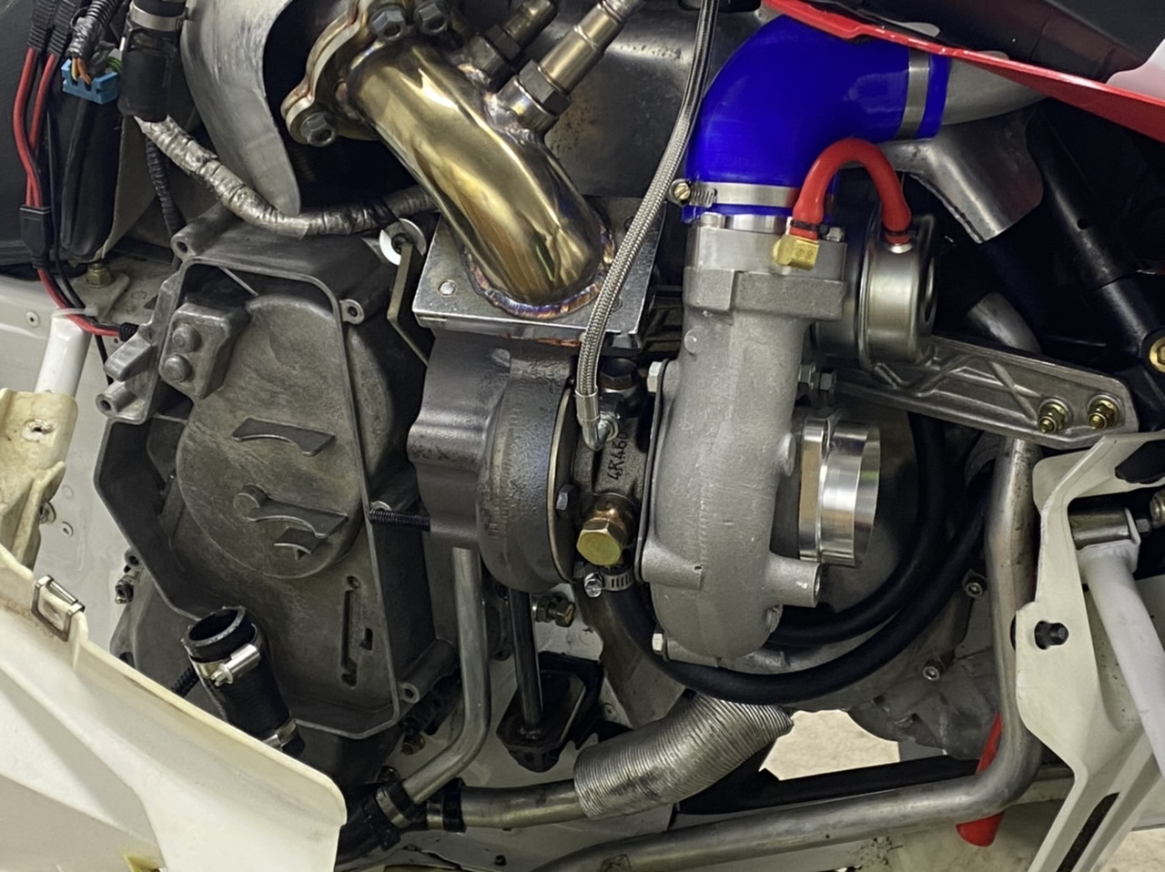

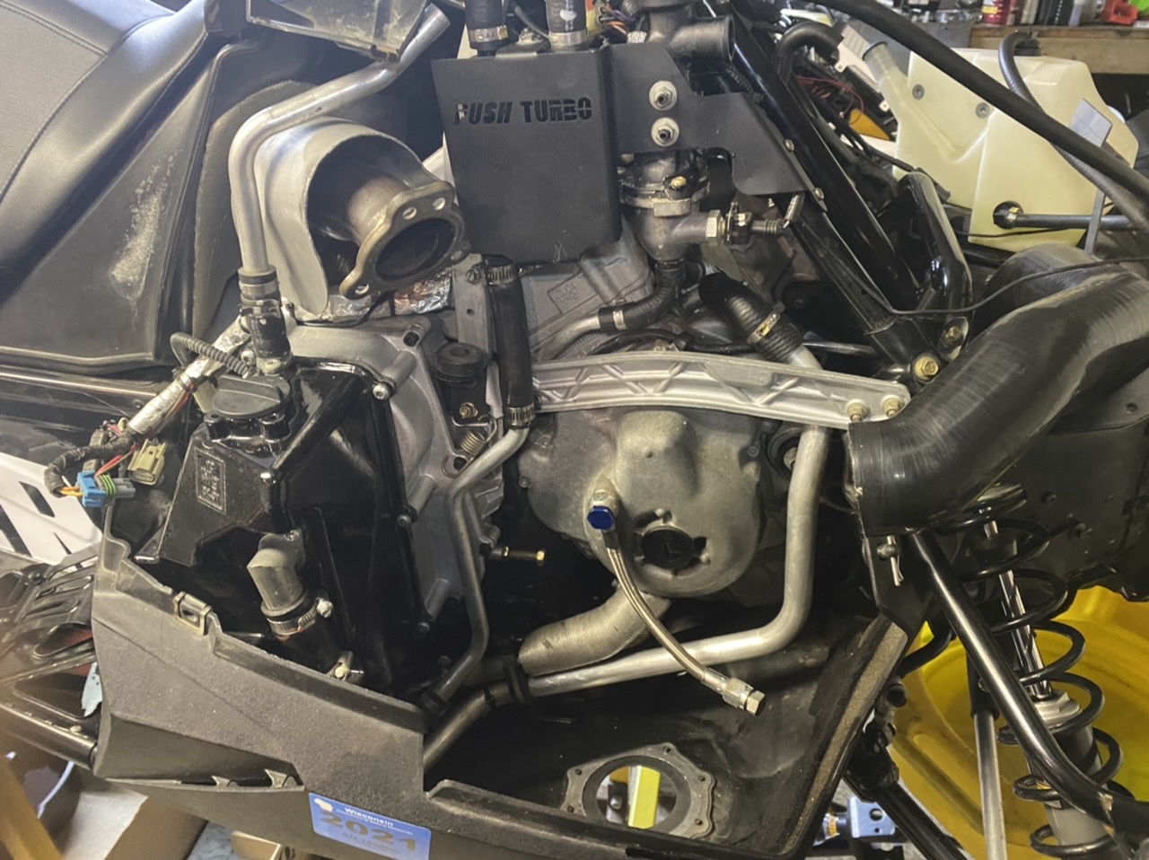

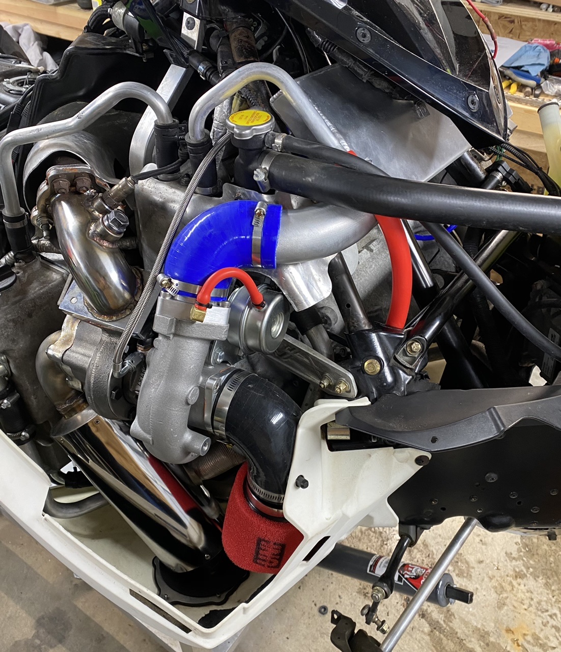

Made the trip up without issue. Truck runs great. Got here about 2pm on Wednesday. I worked on my sled getting it back together until about 1am and was almost done.
Turbo had to come back off to get the chaincase and oil tank back on.
Had a few minor issue that slowed progress but nothing major. Thursday I wired in my new fuel module and had the primary and secondary clutches apart a few times playing with weights and spring tensions. Had to adjust preload on my rebuilt shocks, hood finally went back on for what I hope is the last time for a while.

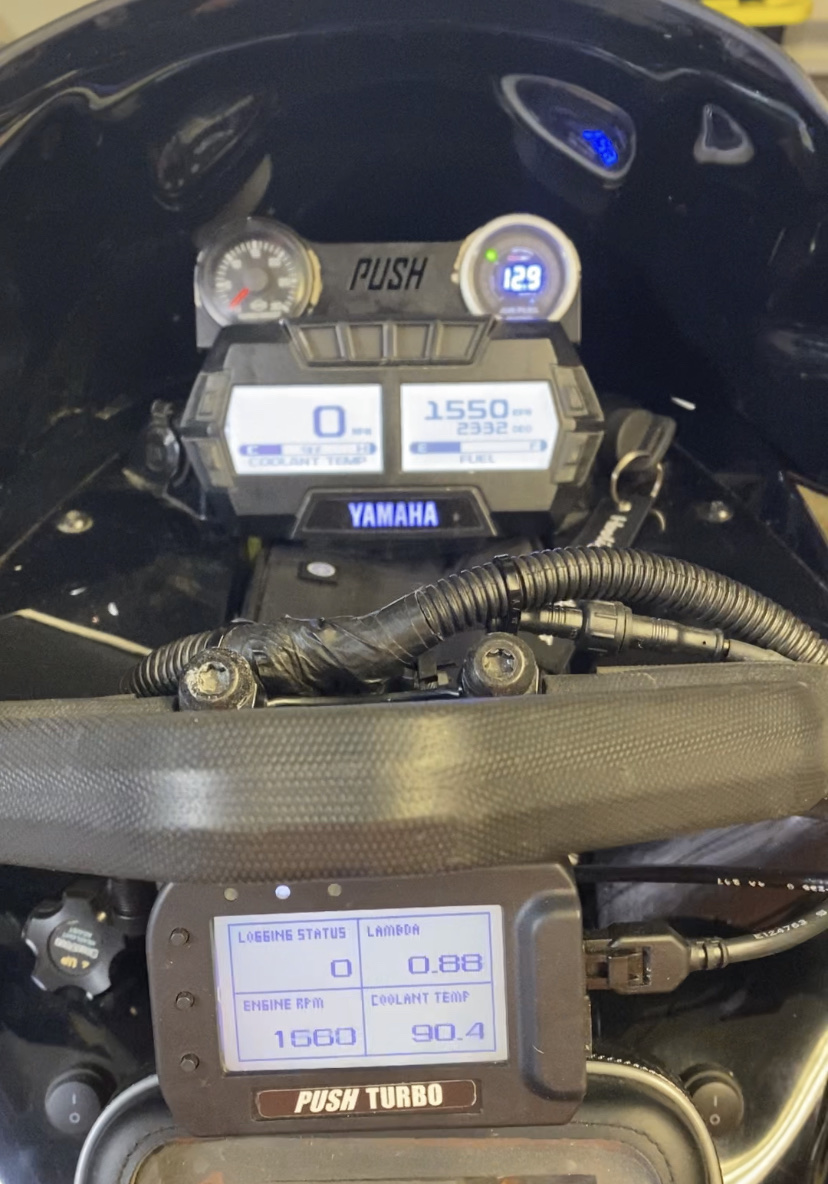

It got to be about 7pm on Thursday before my brother and I were done and ready to ride. I had to relocate my AFR gauge because now I have a 2 pod setup with the boost gauge.
It was about -8° at that time so we decided it would be better if we just waited until morning before loading up and heading out for a shake down run.

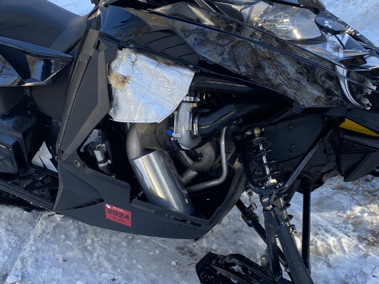

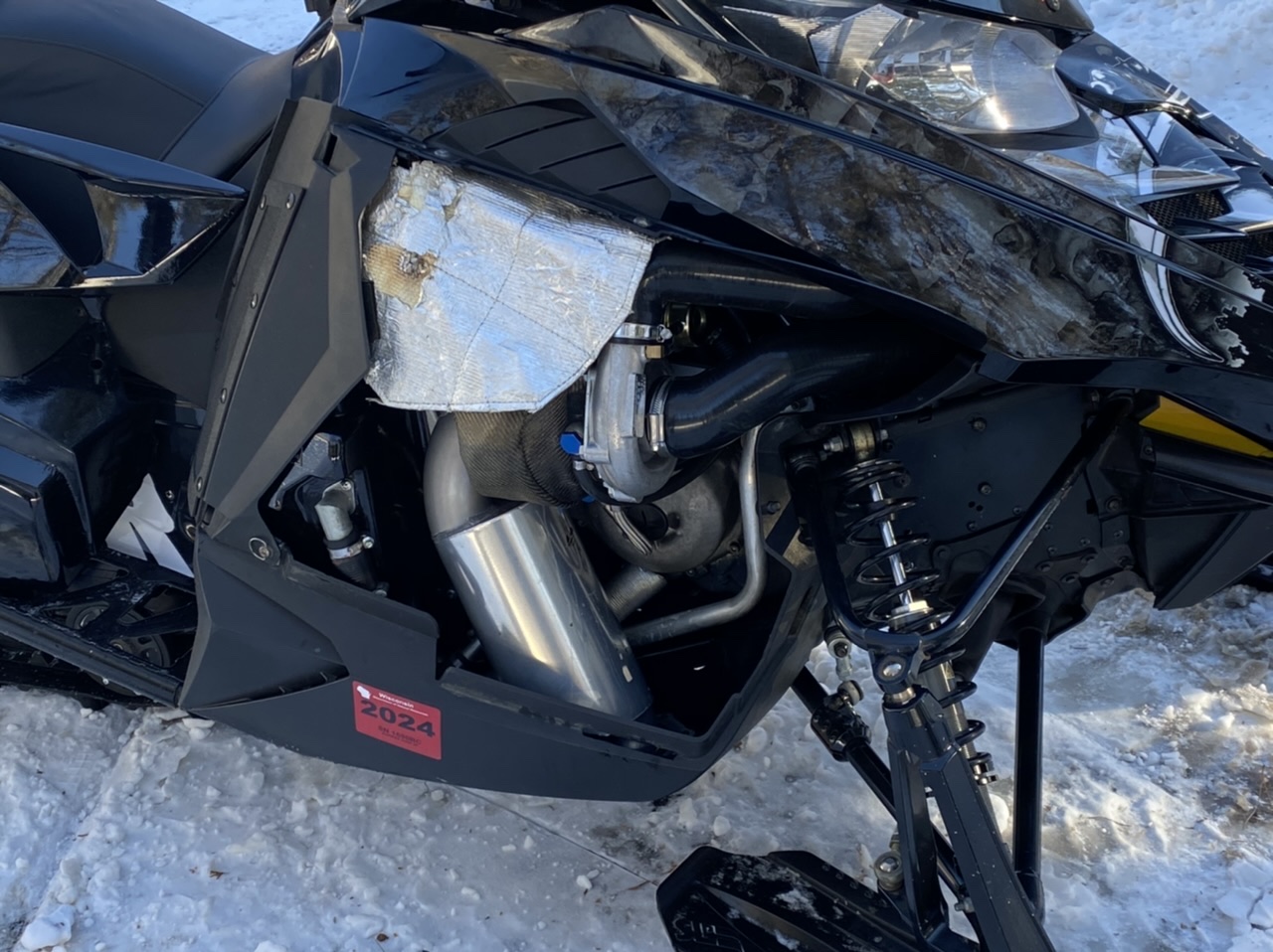

After 2 blasts back and forth across the lake I had smoke rolling out from my side cover on the turbo side. Pulled the panel and found a coolant leak at the banjo fitting on the turbo. It was on the outside of the turbo so it was an easy fix.
My AFR’s are about 13.8 at cruising speed, goes to roughly 12.3 as boost creeps up past 3PSI and hits 11.1 when I squeeze down hard. It’s a blast to ride now. It’ll pull the skis 10-12” off the ground at a 30mph roll.

I’m seeing right around 7psi max boost which is on the high end of where I want to be but I’ll keep it there and won’t hold it at that point.

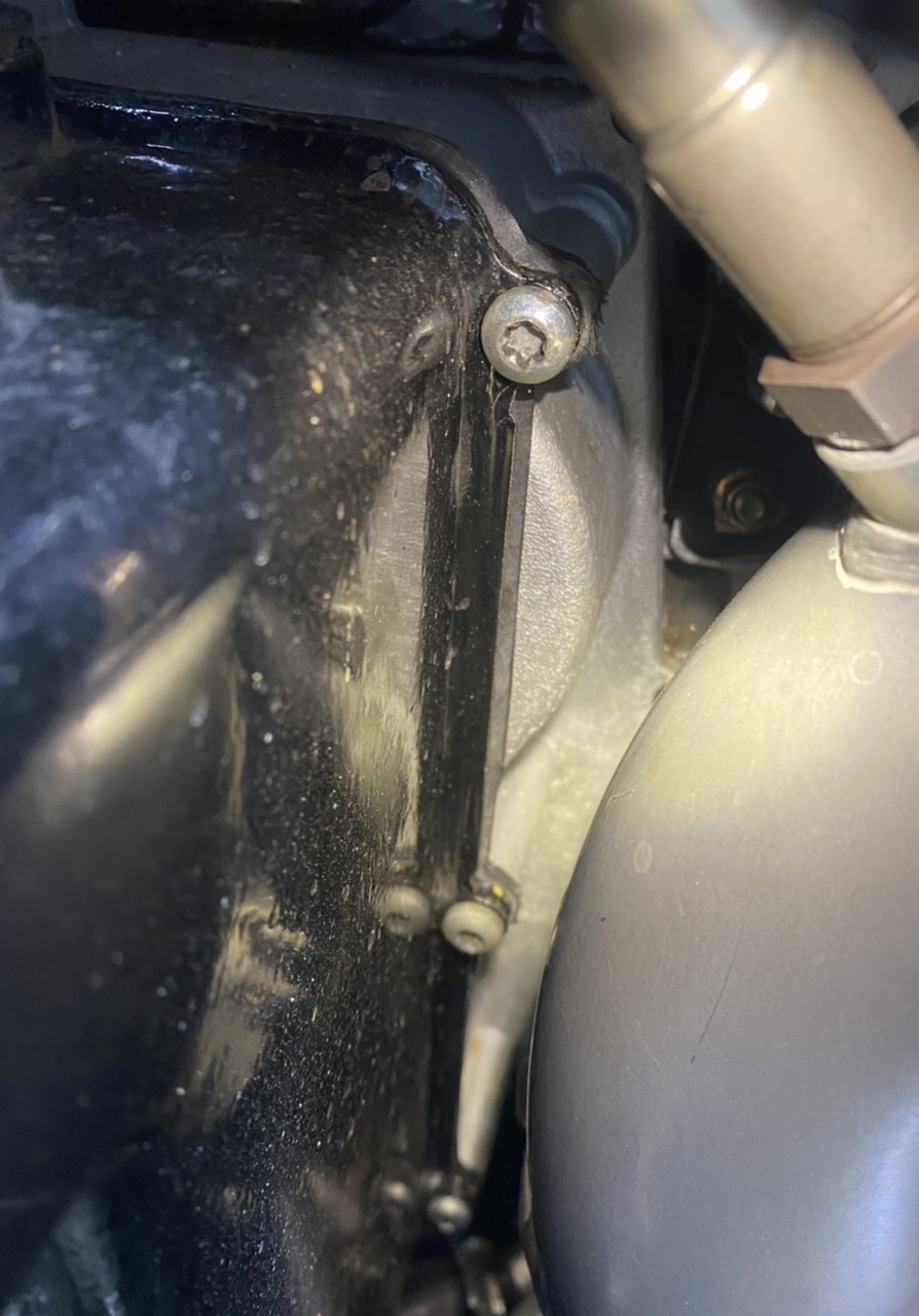

I feel bad because I’m the one who talked him into using the gasket. But it was installed 3 weeks ago, the gasket wasn’t squeezed out prior to this so I doubt he overtightened it and it sat with oil in it for that time too and not a drop. I’m thinking it has to have something to do with the heat from turbo and down pipe right next to oil tank.
So now the oil tank is siliconed back on and he swears off that gasket like it’s the devil. I told him I don’t know what happened or why but if you look at the gasket I put on mine it’s still right where it should be. But he seems to think it will fail on me because his did. Now I just have to prove him wrong.
