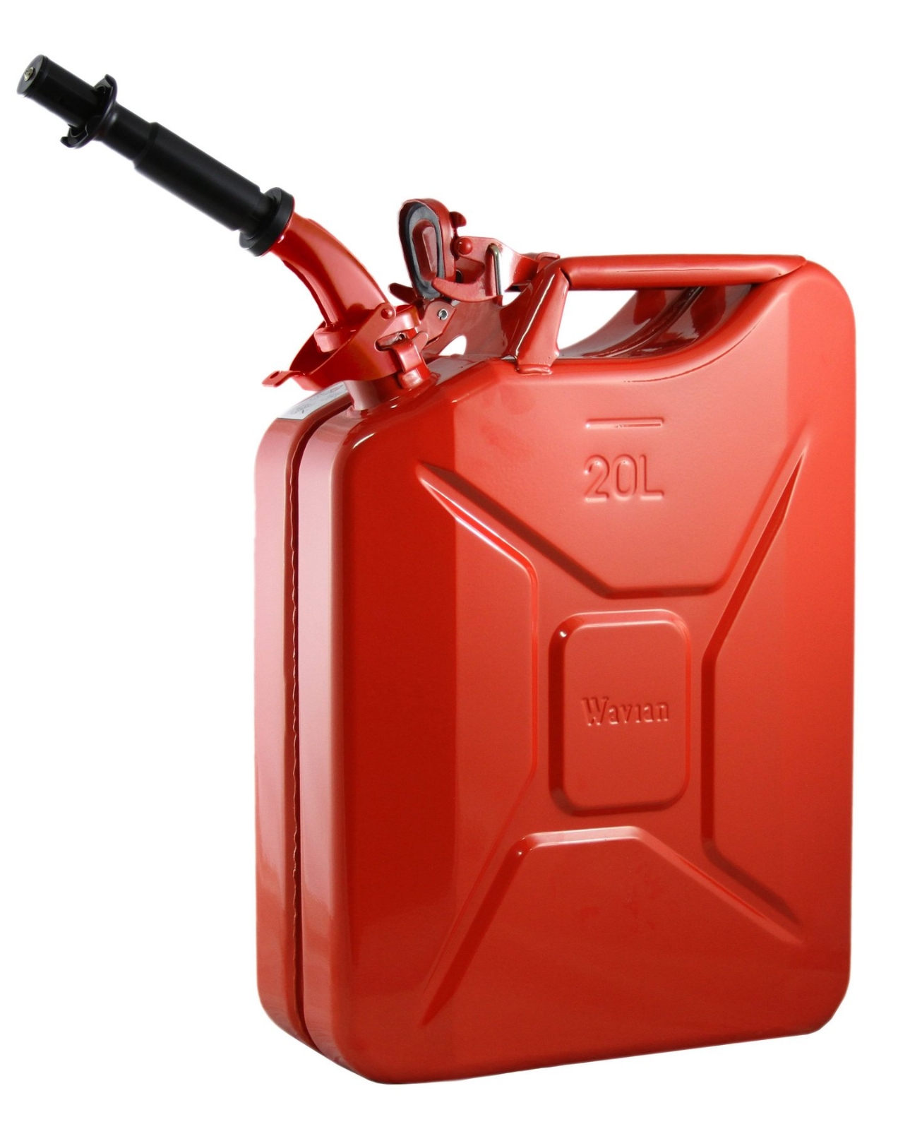

You can also stock up on REAL gas cans, Jerry cans by Wavian. These will not leak or smell inside your truck and with the original spout, not spill when pouring.
https://wavianusa.com/products/steel-fuel-jerry-can
Thanks on the jerry can link they seem very good rated.
