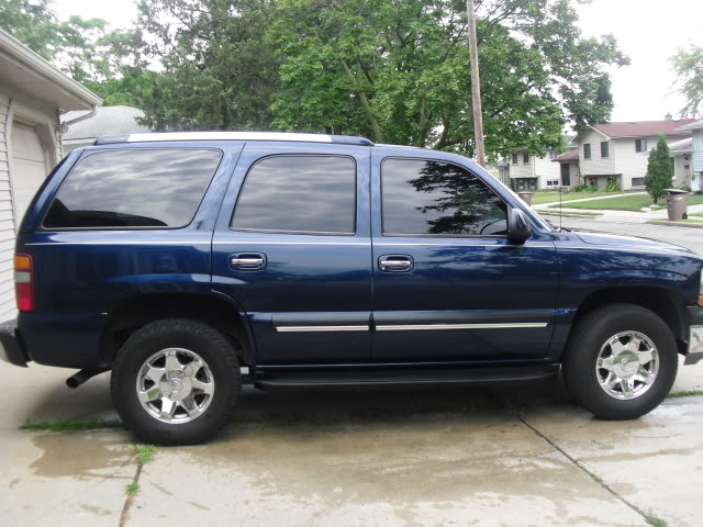

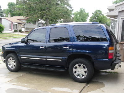

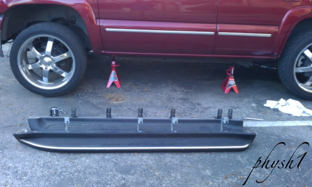

Board removed. Escalade board in front...stock in back. Notice the Escalade board only uses 4 brackets...not 6...

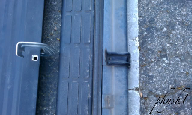

Stock board/bracket on the right, Escalade board/bracket on the left...notice that the stock brackets have 1/4" holes for the hardware...the Escalade boards have HUGE provisions. This is why we need to use fender washers with the stock hardware to make things fit & be safe...

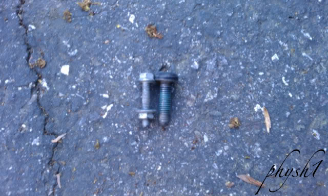

This is the hardware you're removing...T40 Torx bolt on the right, 10mm body bolt on the left...

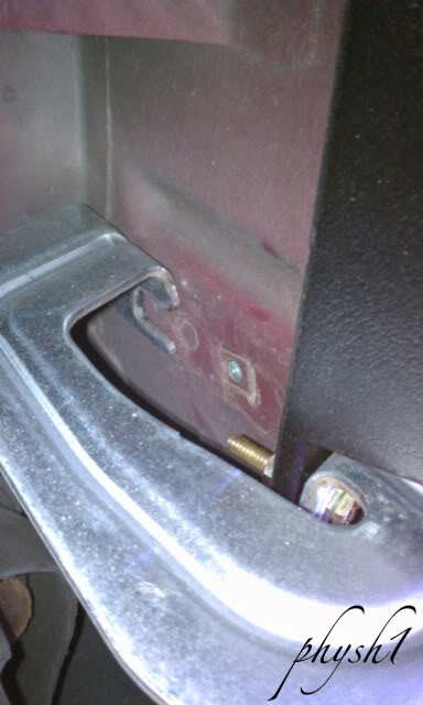

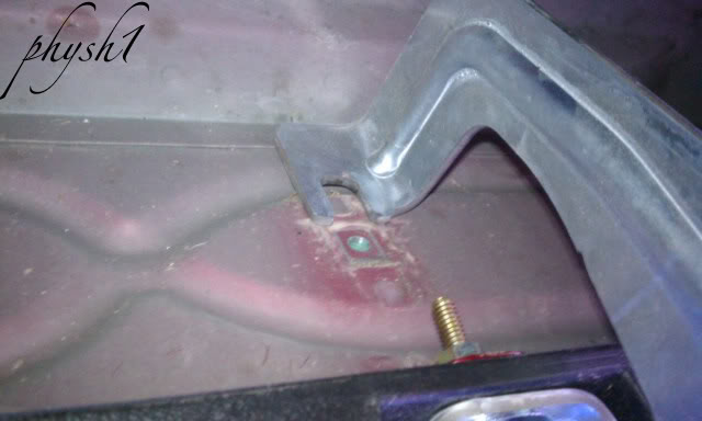

The body bolt locations on both boards are the same. You can use the stock hardware but washers will be needed. With the Escalade board held into place with 2 body bolts you can see we have an issue with the Escalade brackets being too tall. These, at this point, cannot be bolted up...

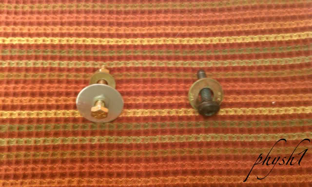

Here is the hardware I'm using. The T40 bolt (right) now sports a 3/8" G8 washer. I replaced the 10mm nut & bolt with 1/4" G8 hardware as mine looked a little rough. You don't need to do that BUT you do NEED washers! I used a 1/4" fender washer & a 1/4" standard washer...

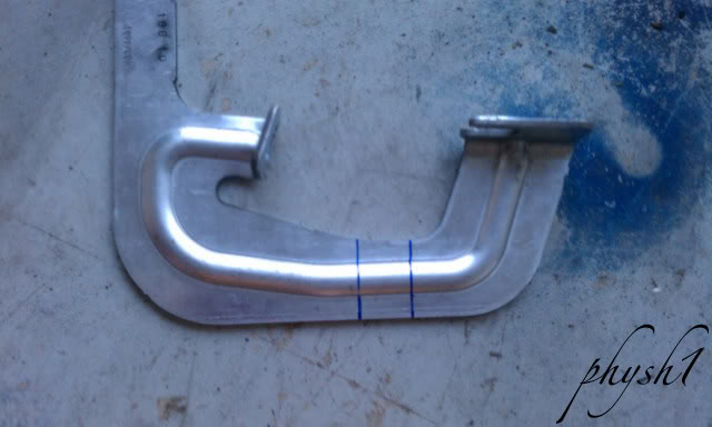

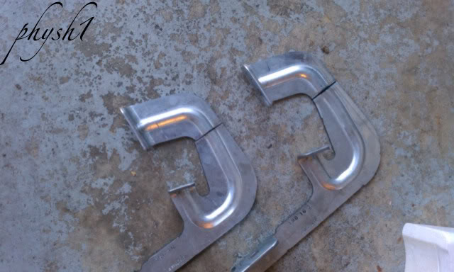

In order to bolt the board hangers to the body each bracket has to be sectioned. In my case, from front hanger to rear, they needed to be sectioned 1", 1", 1", & 1.5". Here is the stock setup...
Here is 1 bracket with the 1" section to be removed marked in blue...

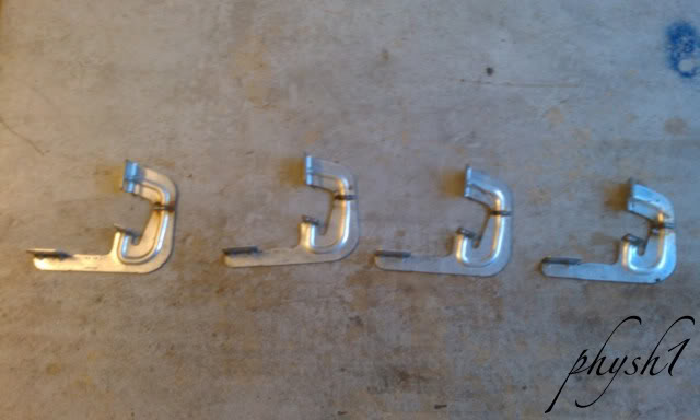

Two sectioned & ready to get welded...
All 4 sectioned, welded, & ready for install...

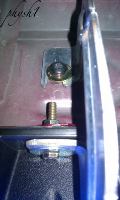

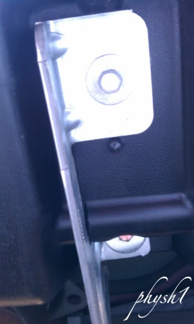

Sectioned brackets now bolt up to factory locations...note the washers...the T40 bolt head could slip through the bolt slot on the bracket...you can clearly see the body bolt as well...I replaced mine but the factory hardware will work perfectly fine with washers too!

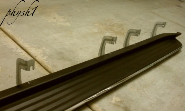

Underside of Escalade board...

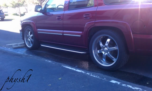

Driver side board re-installed with 9 total bolts. These boards have a much better build than our stockers, better brackets, & only 9 bolt holes. No more needed...

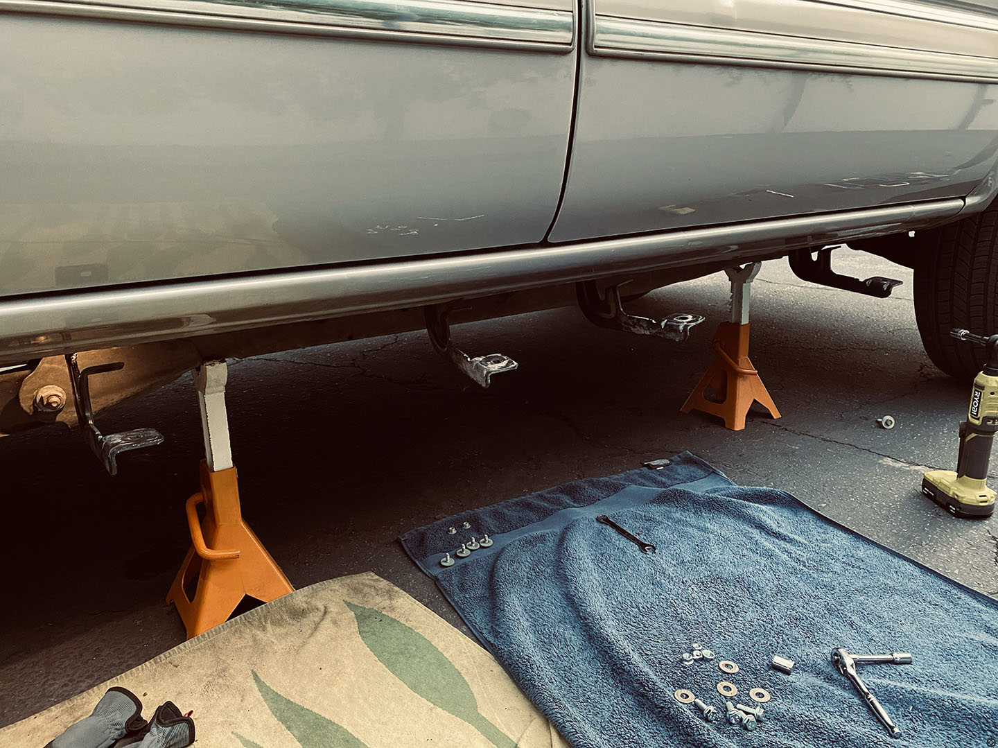

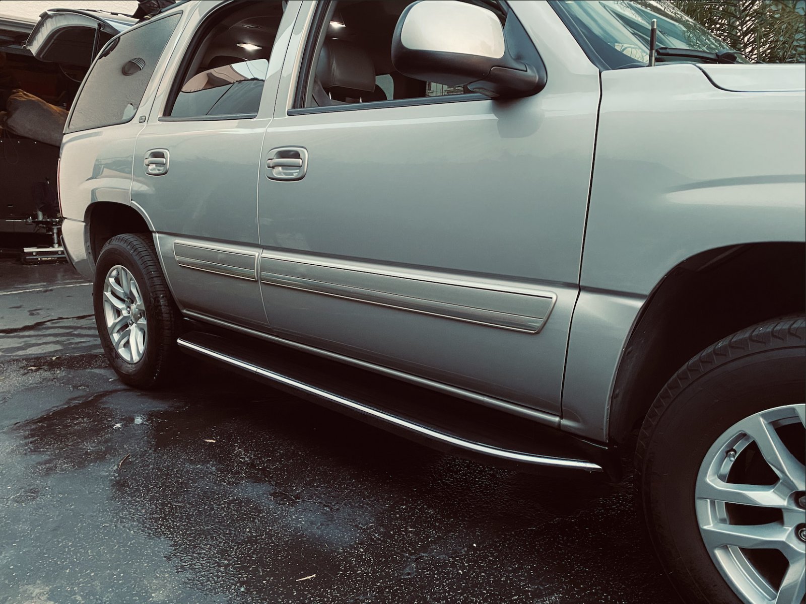

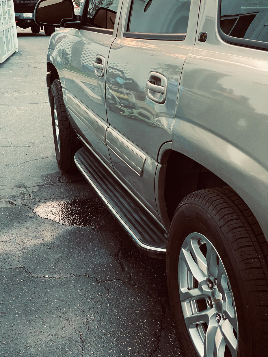

I'm installing NNBS Esky running boards on my '04 Tahoe. The OEM Tahoe boards are too chunky for my taste.
The stock Esky brackets allow you to hang the running boards from two inner brackets for a test fit. There's wiggle room to push the running board in and back for slighlty for better alignment than is shown in the attached photo. I found only two hanger mounting points that don't line up on the driver's side.
The front and rear brackets will need to be shortened differing amounts to line up with mounting points on the body. That's why I've quoted iTahoe as my experience is similar to his. Not all brackets need to sectioned. The OP's original shots (attached again) are a perfect preview of the differences. When I have those measurement I'll post 'em up.
Other than notching hangers on the passenger side to clear rear heat/AC lines, I expect the passenger side experience to be equally drama free.
Edit: Driver's side front hanger sectioned 3/4", middle two good as is with addition of two fender washers, the rear bracket was sectioned 1 1/4".

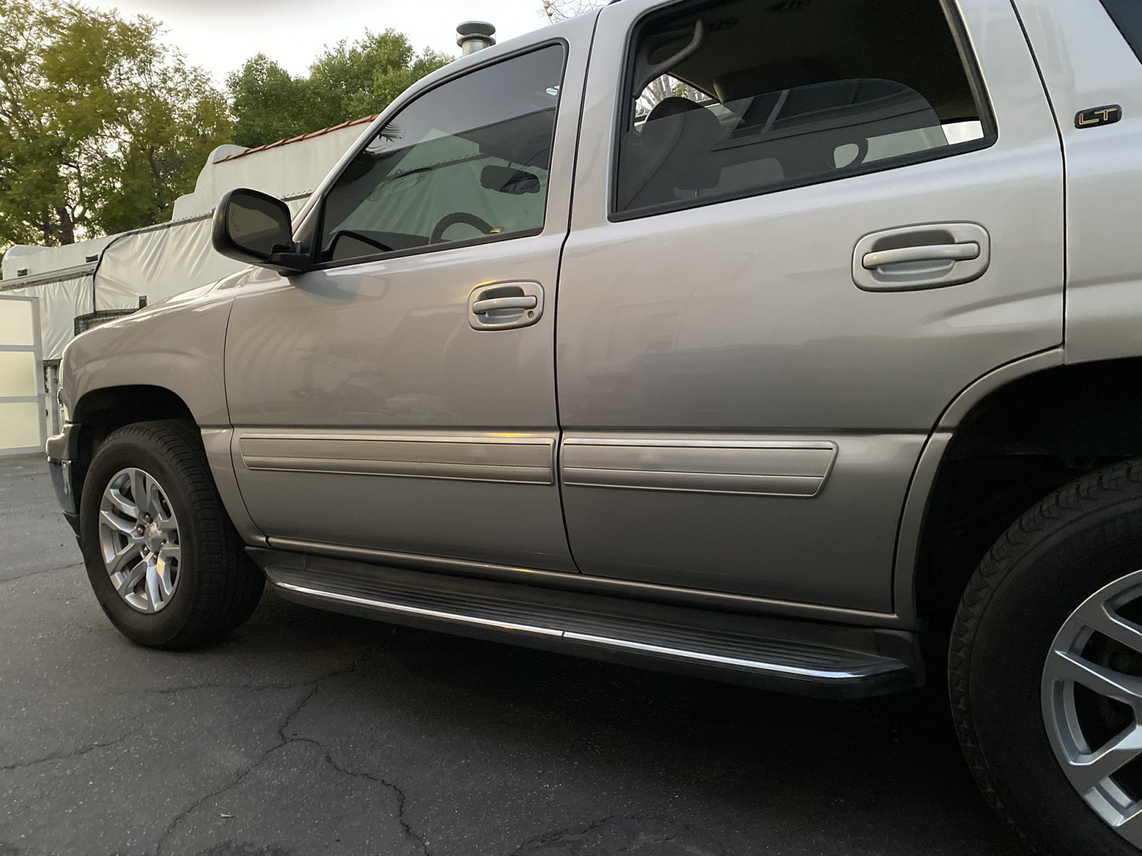

The passenger side is done. As Physh1 stated, it is a pain to fit the hanging brackets in and around the rear heat/AC lines. The AC line mounts were unbolted and clips undone to provide more clearances for the middle two brackets. That area is the tightest to work in.
My bracket sections removed where 3/4" for the passenger side except for the rear bracket at 1 1/4". I'll venture a guess that we trimmed differently in allowing for the AC lines. I found it easier to trim for line clearances first, snug up the brackets for a test fit and then measure clearance needed before sectioning each bracket. Photo attached of brackets hanging loose before sliding in the running board.
Once the running board was in place everything was snugged up. It fits as well as the driver's side and worth the effort. Photos will be posted after they get a good scrub.
Side note: My '01 Tahoe did not have running boards. My current '04 had them based on its RPO but not when I took ownership. So, I don't have a reference of removing NBS boards to add NNBS & the differences in brackets. If there's a simpler way to make this swap I'll find it after the next LKQ run. :p
