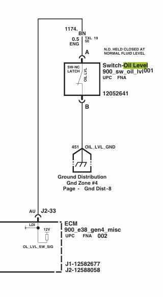

What @SpareParts said... Looks like you ground that brown wire...
