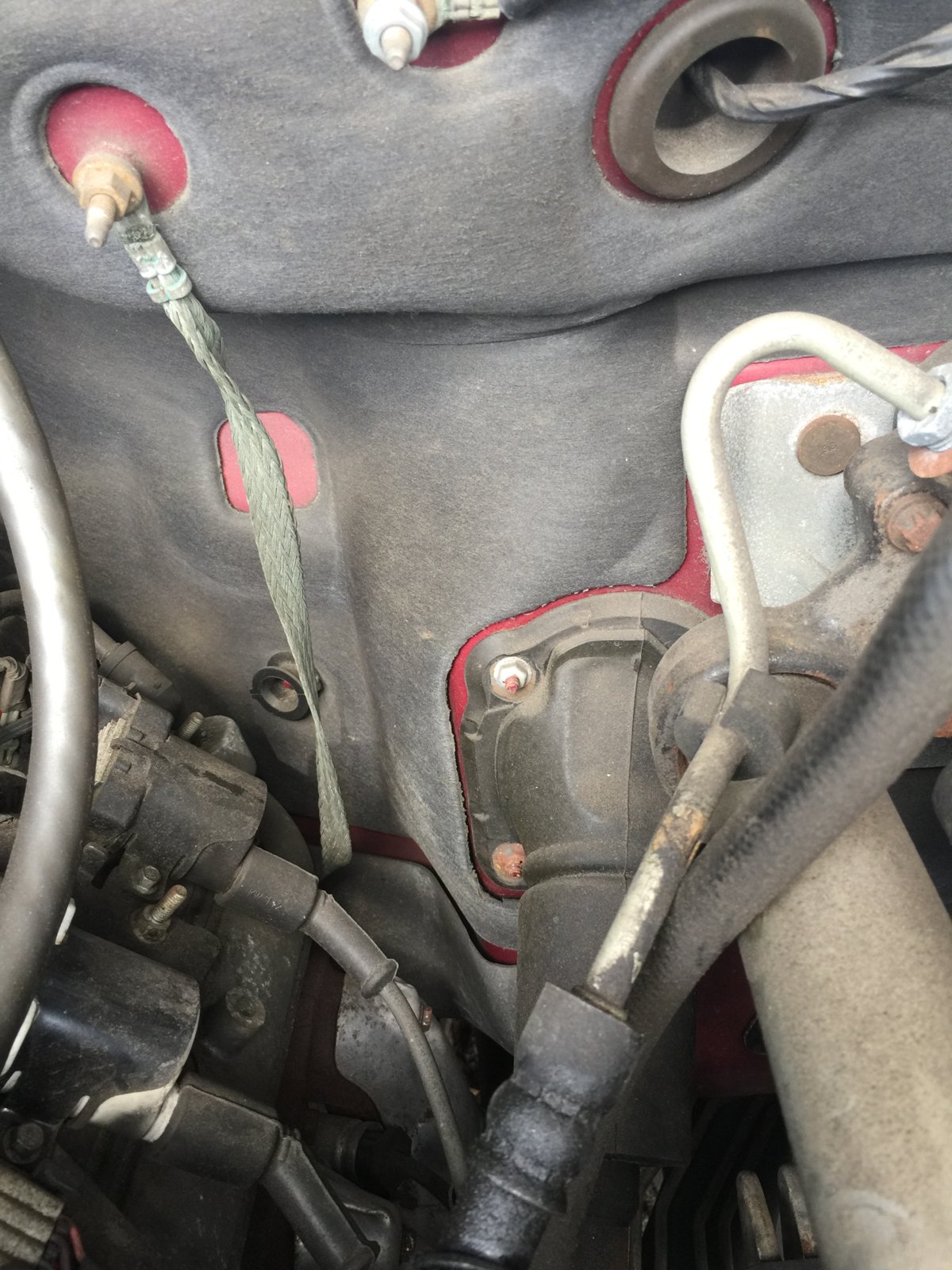

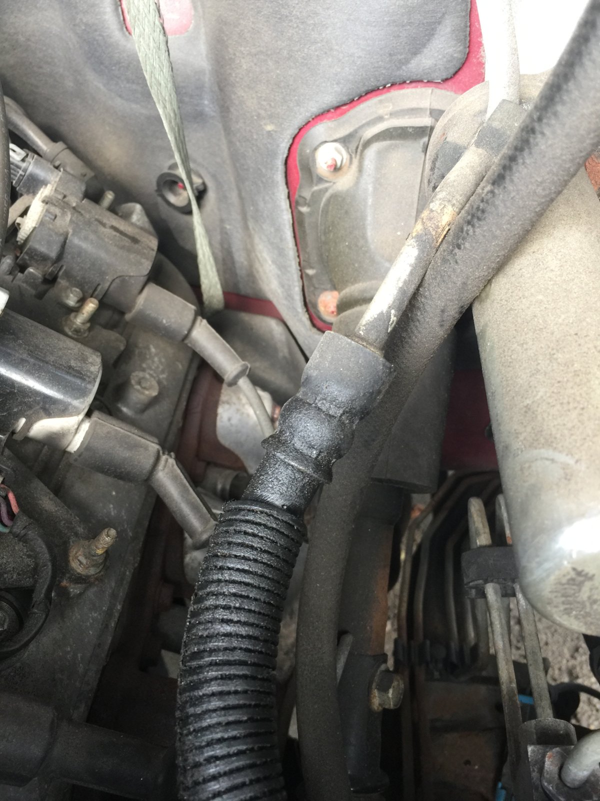

FroKinda hard to tell from the picture but my vote is the hose end is leaking a little. I'd try a new hose first.
Just when I thought this would be a simple fix...I noticed something weird about my brakes this evening after my ride home from work. Mind you the car is in park when I noticed this but Theres a slight pressure releasing sound accompanied with“squishy” feeling on the brake petal when press down on my brakes while the car was in park. When braking while driving around the car stops without issue. Does this sound like a symptom of the seepage/leak that we’re talking about here? I’ll post a video tomorrow of the sound.Kinda hard to tell from the picture but my vote is the hose end is leaking a little. I'd try a new hose first.
