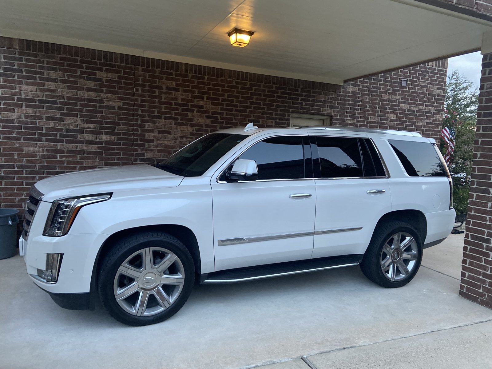

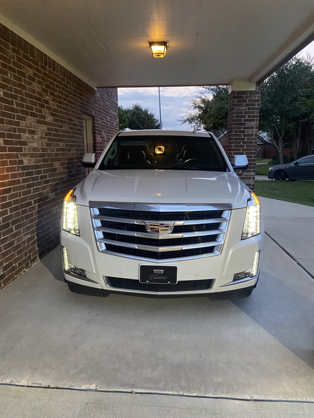

My favorite is the 2018-2020 Escalade luxury. This has all the options except the electronic problem steps and ACC cruise. It does have regular cruise. There are many members that have an issue with the ACC cruise module. I also don’t care for the look with the electronic steps. I like the fixed steps. The Escalade has the 16 speaker Bose not 10 speaker like the Denali. I also love the ultra led headlights, 360 camera, camera mirror, HD cluster, CUE stereo, sport/winter/tour mode, auto parking, lighted front back door sills, lighted door handles, cool looking key fobs, nicer leather seats, and more. The Denali is a very nice truck too. I just like the extra options for not much more.
