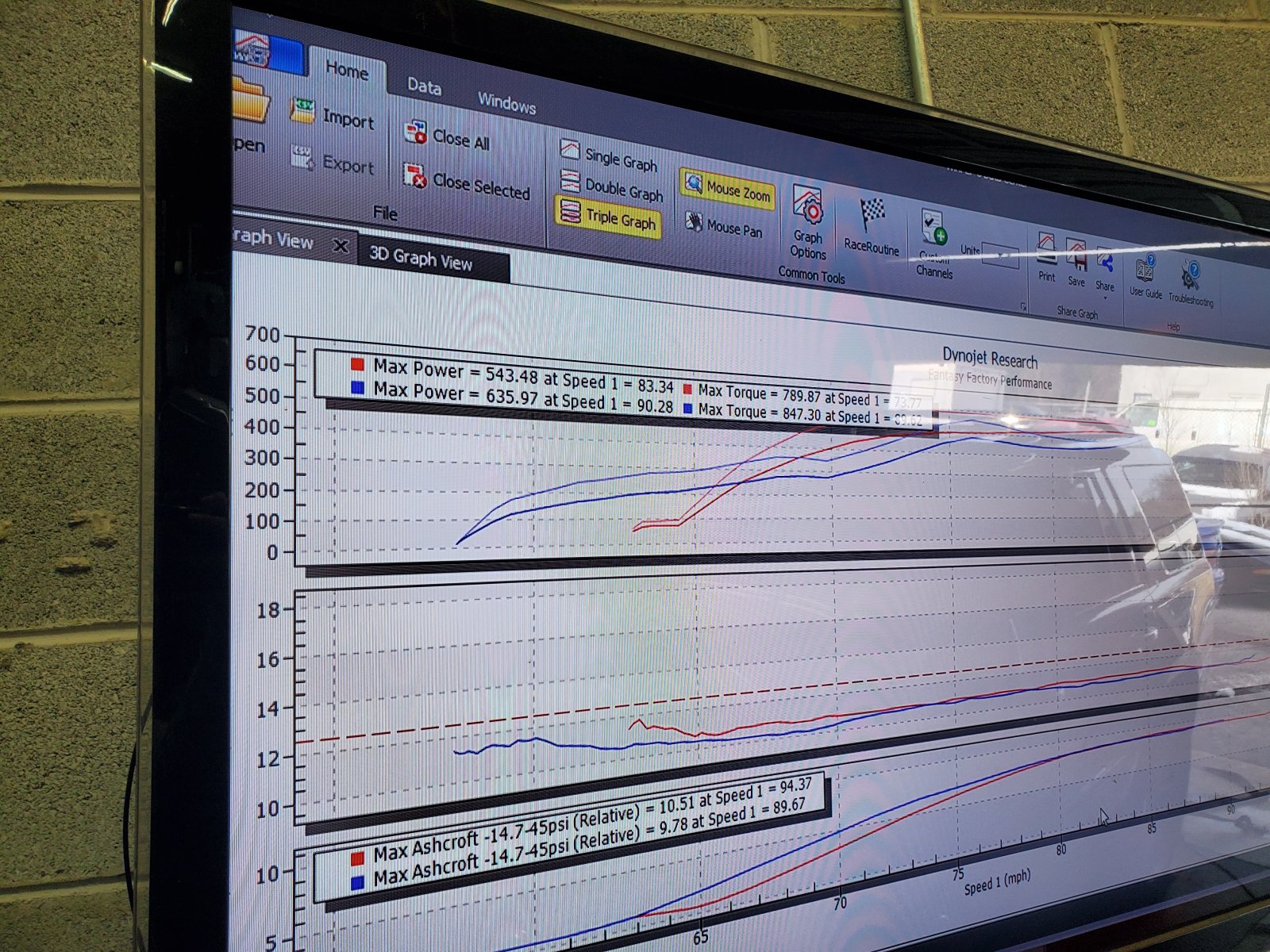

We got on the dyno and did 4 pulls before we had to shut it down. The LT4 fuel pump was throwing an error code so we had to abandon the tuning session for today. Tomorrow we will be pulling the top off to re-check the LT4 upgrade install and sort the gremlins.
The good news is that even with all the issues, the Esky still managed a best run of 634/847. That was on low boost and barely any tuning done. There still should be a lot left after we sort the high side fuel issue out but I'm good with those numbers if I end up being stuck there.
The attached video is of one of the runs + the dyno chart of our best pull.

Holy Torque Monster!!! Look how flat that torque line is. It's hard to tell from the graph photo or maybe I'm not reading the numbers along the bottom right; But what RPM are you at peak torque and HP?
I bet it's a blast to drive!
maxpsi
Oct 10, 2021
52
27
A/F looks rock solid and where it should be. Not bad given the fuel problems.

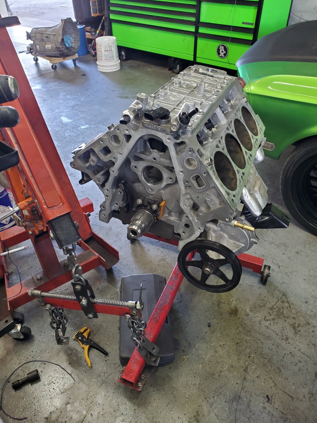

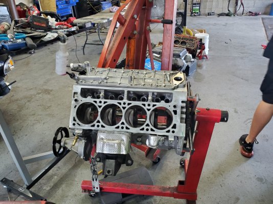

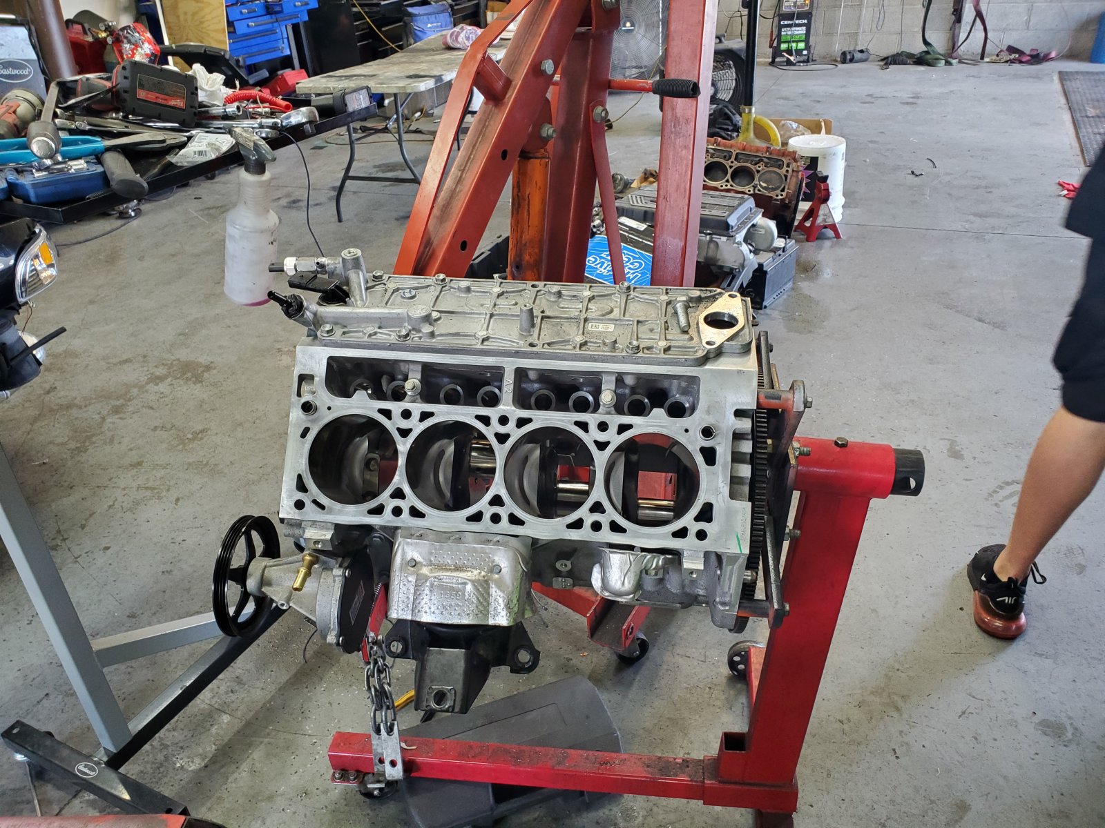

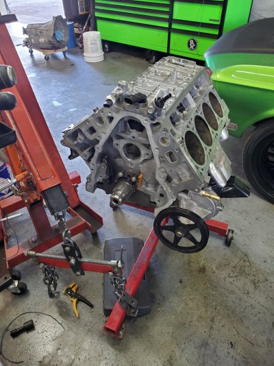

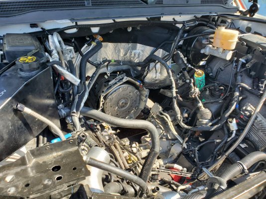

I've been hella busy with work and home improvement projects but I managed to yank/tear down the engine this week. The original plan was to just do a DOD delete kit install but that project quickly snowballed into the decision to also do drop-in pistons and a mild cam.
Also trying to figure out a better solution for the A-Pillar gauge pod. If anybody has any ideas for the gauges let me know.
Once I get this thing back together and on the dyno I'm hoping for 800hp at the wheels with low boost.

What are your choices on cam and pistons? Curious on your cam choice since you are boosted. Any thoughts on mild porting or clean up on the heads?
RThomasII
RThomasII
Jun 25, 2016
207
305
Nothing special....
GPI drop in pistons
Callies compstar rods
VVT-2 Cam - 32% fuel lobe
No plans to port the heads. I would love to dig into the motor more but I'm waaaay over budget as it is.
