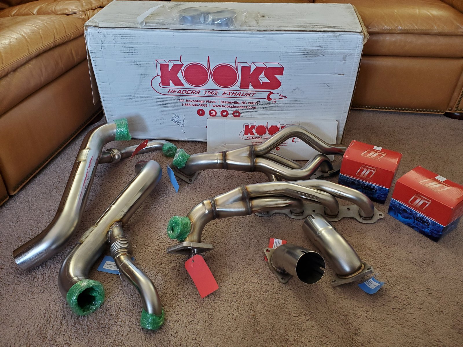

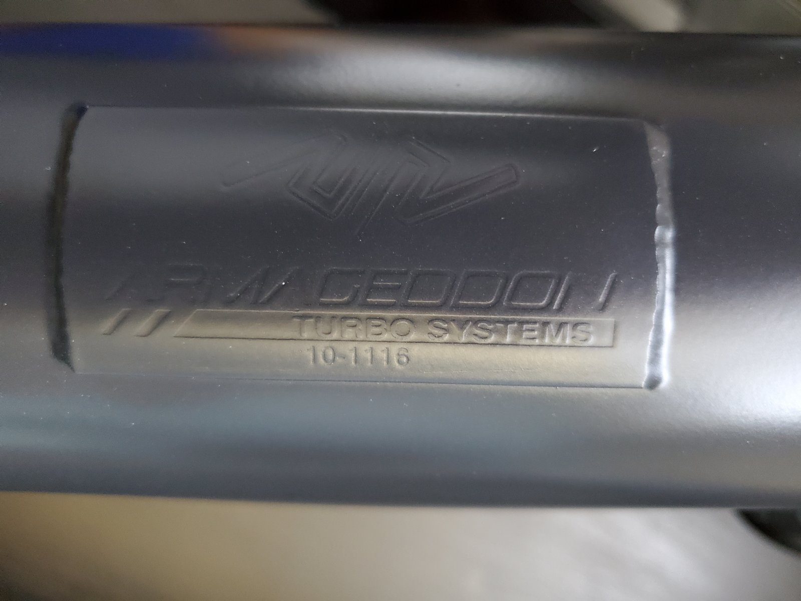

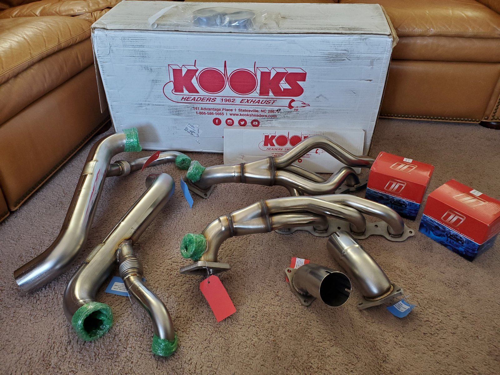

So after a bunch of debating back and forth between various forced induction options, I finally decided to pull the trigger on the Armageddon Twin Turbo System for the Caddy. The "Hot" side just arrived. Still waiting on the Turbos and "cold" side to be delivered. Will be dropping everything off at the coaters on Monday to get the hot side ceramic coated. Hopefully that will keep the under hood temps down a bit.
I also plan to update this thread as progress continues. Kinda boring right now I know but I'm super excited to FINALLY get this project off the ground.
Any questions.... Feel free to ask....

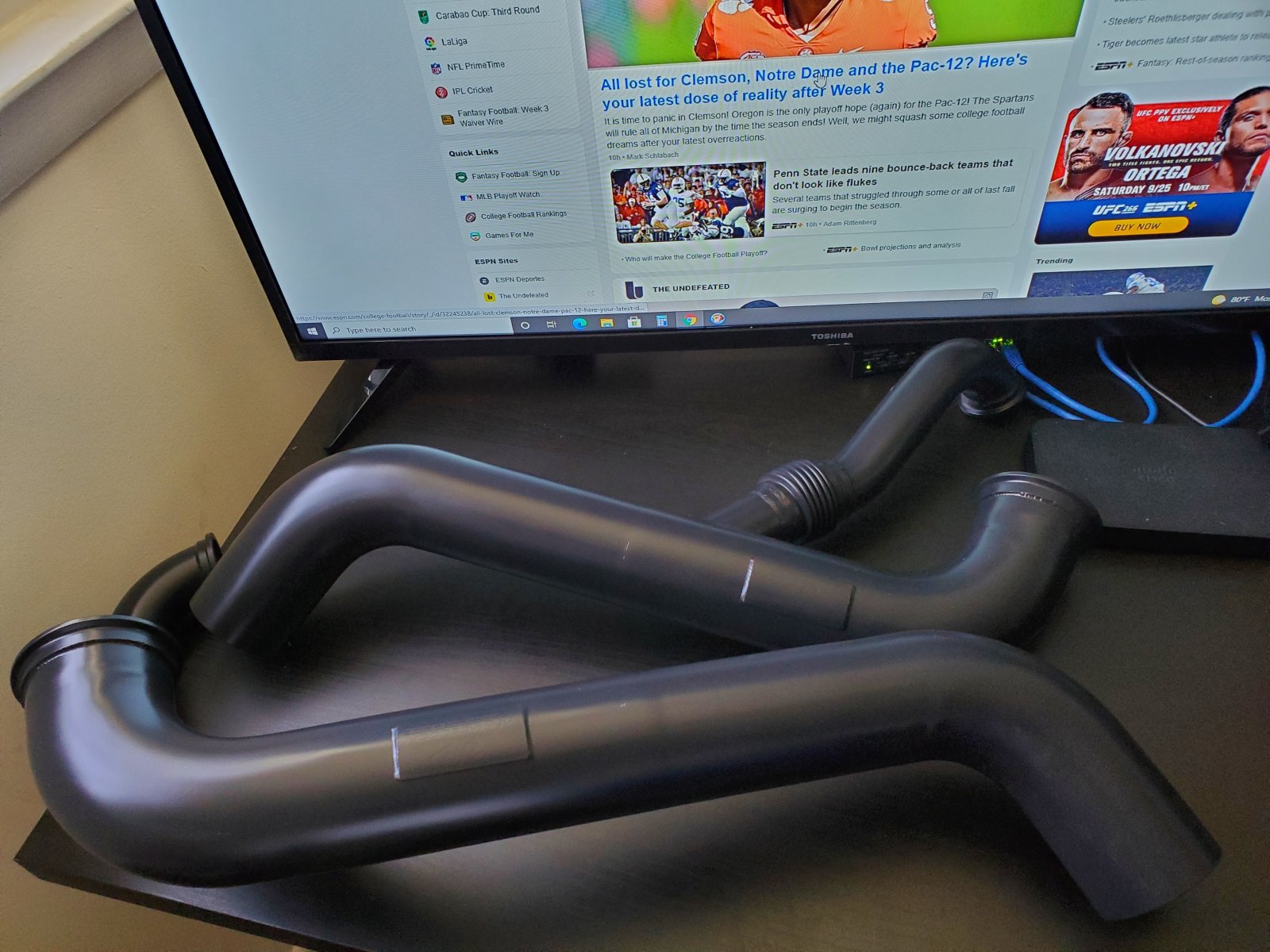

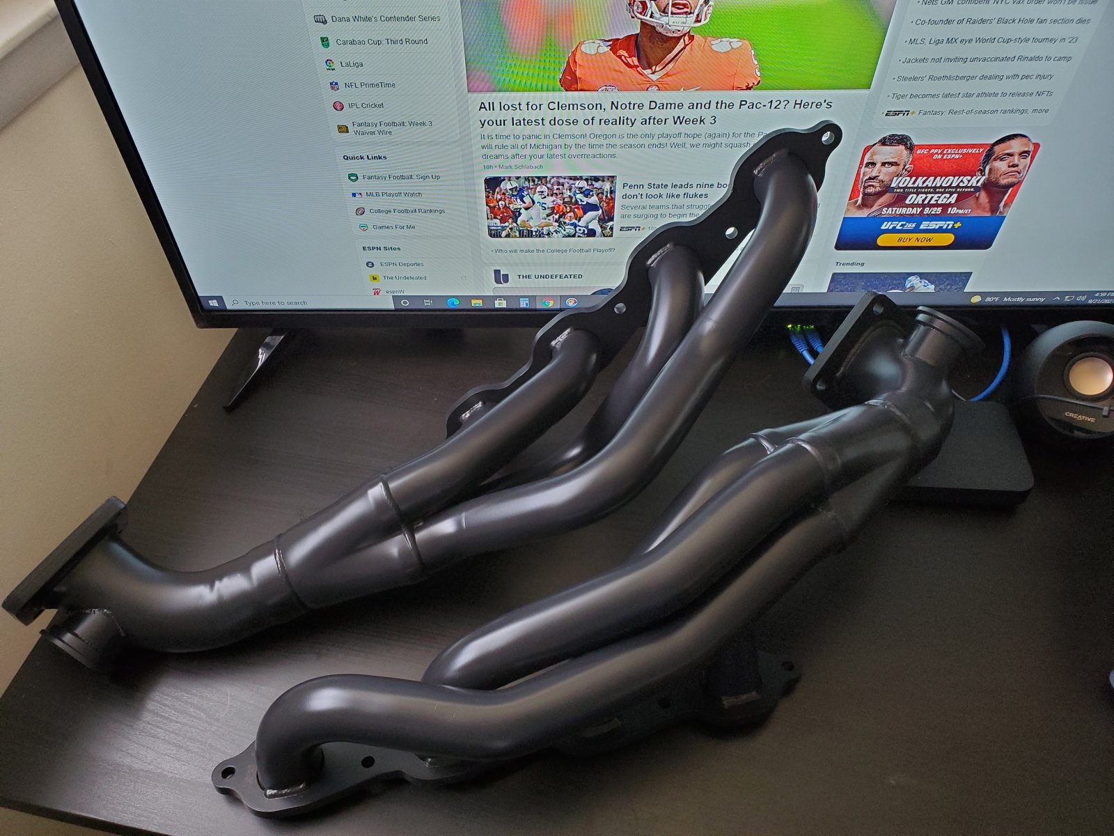

Just a quick update....

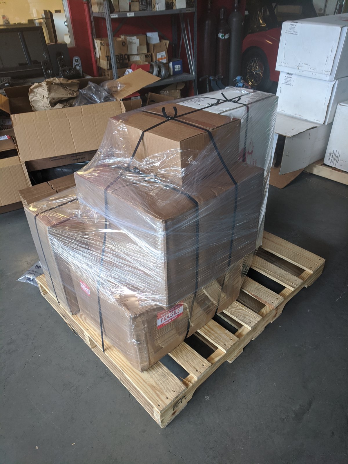

Picking the headers and downpipes up from the ceramic coaters today. I just went with satin black... Nothing special there. Also, Armageddon shipped the remainder of the kit on a pallet over the weekend. Assuming everything arrives on time, I should be dropping off to the installer on September 27th. Delays in part availability at Armageddon and my daughters graduation from Naval Station Great Lakes boot camp this past weekend pushed out my timeline a bit.
Now I just need to figure out gauges and a gauge pod to mount everything up and still look somewhat oem. Thinking TurboSmart and Aeroforce but still undecided at the moment.

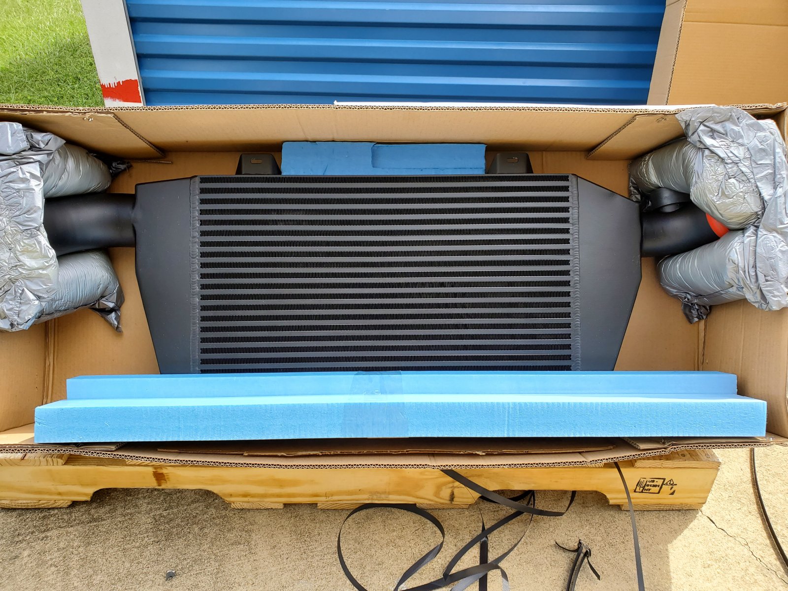

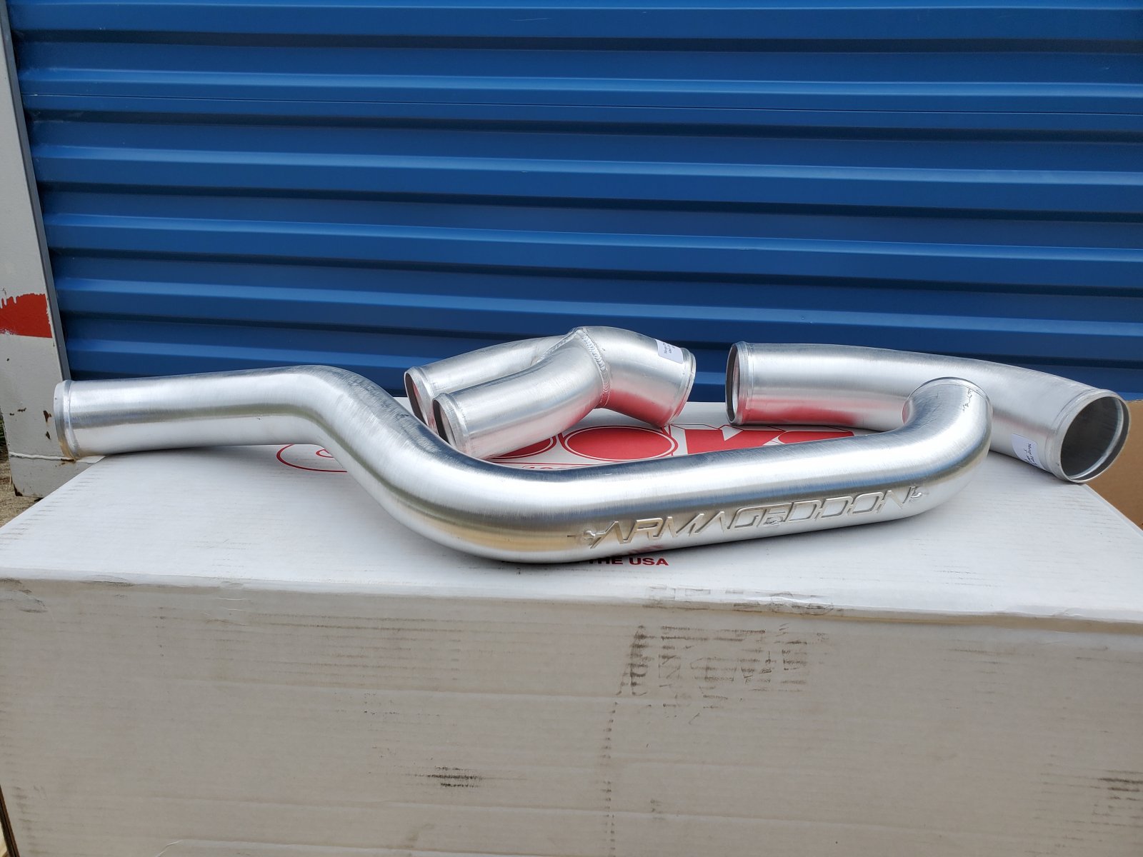

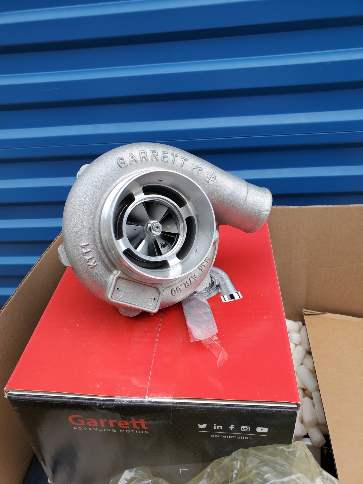

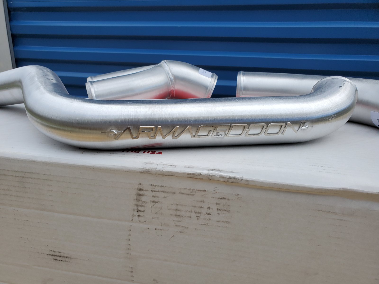

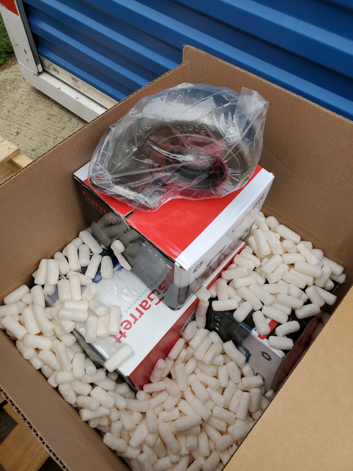

The "cold side" and turbos just showed up. I'll go through everything for inspection this evening after I'm done with work but here are a few pics I managed to take in between Teams meetings....
Enjoy!

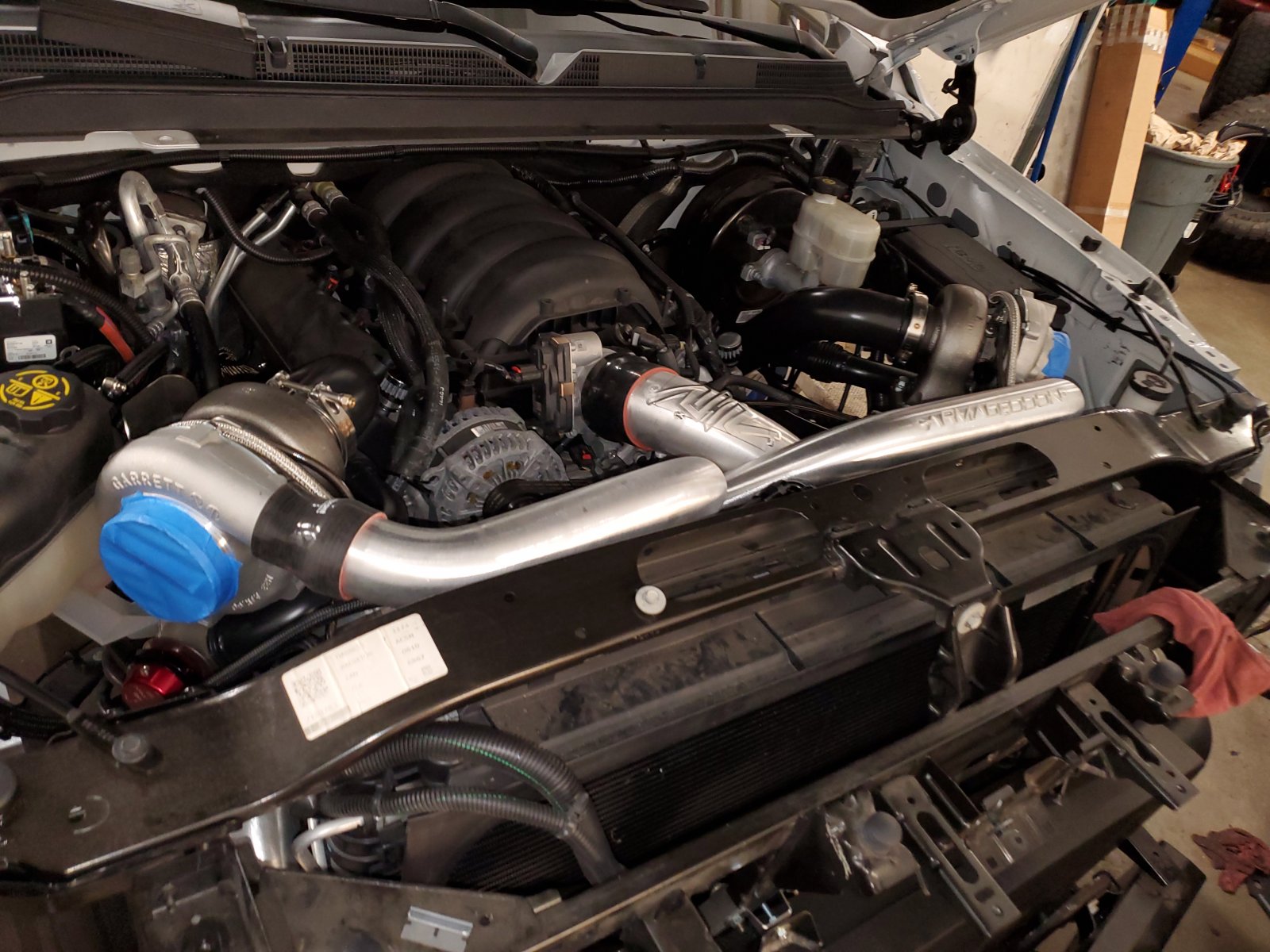

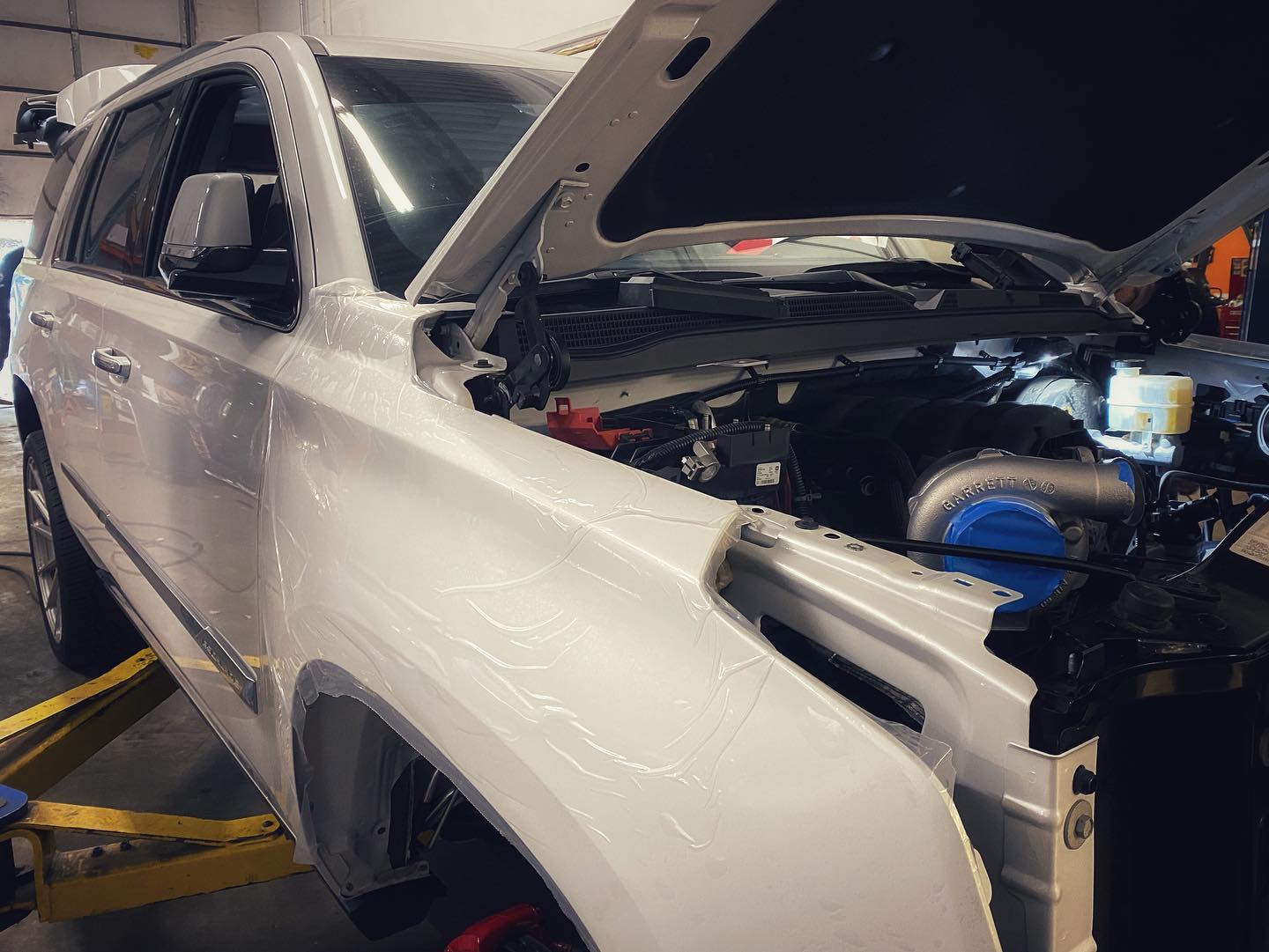

Install progress. Everything is SLOWLY coming together. Also, I will probably ditch the EBoost2 and go with a AEM Tru-Boost instead.

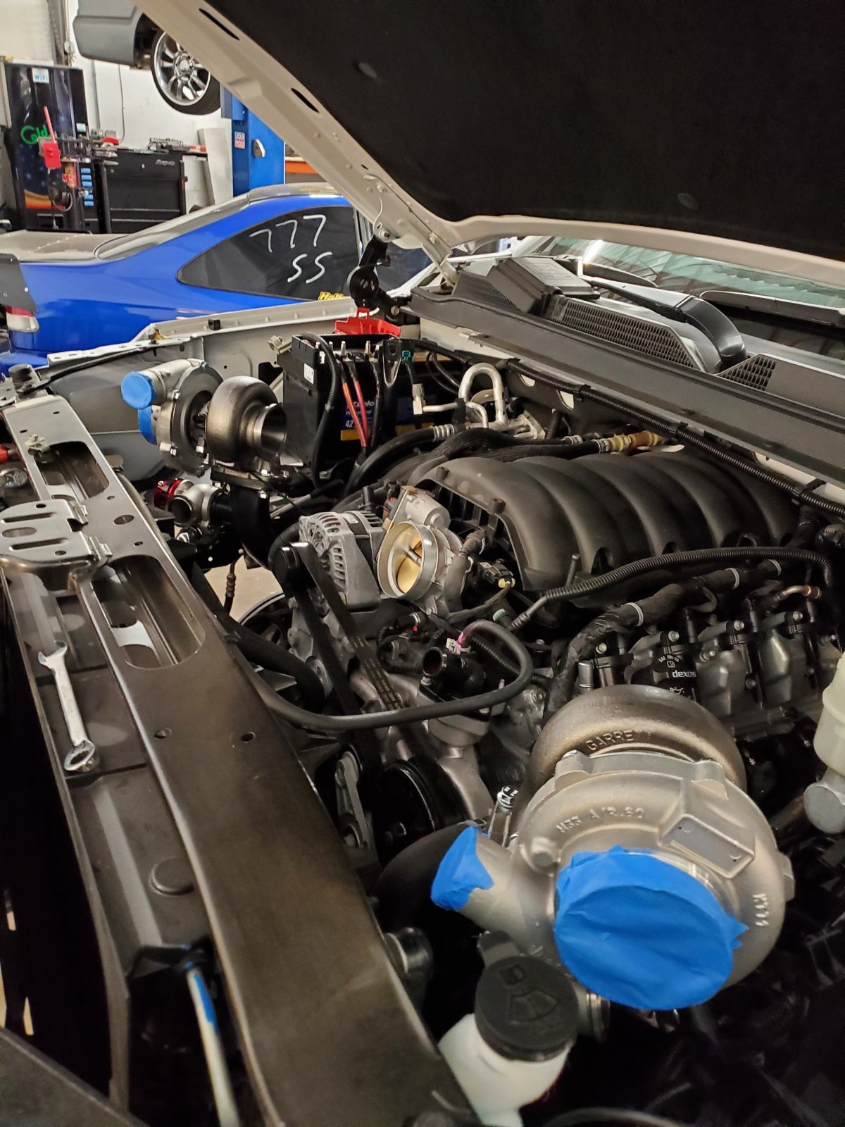

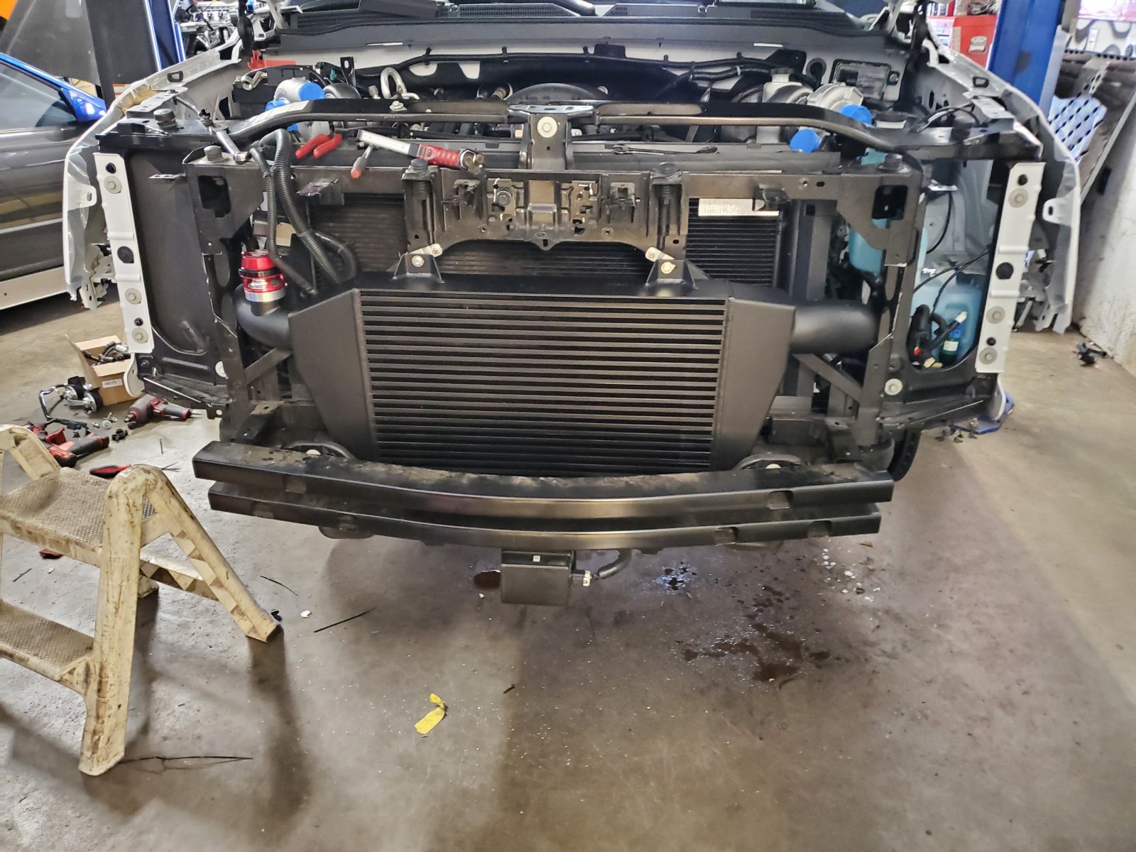

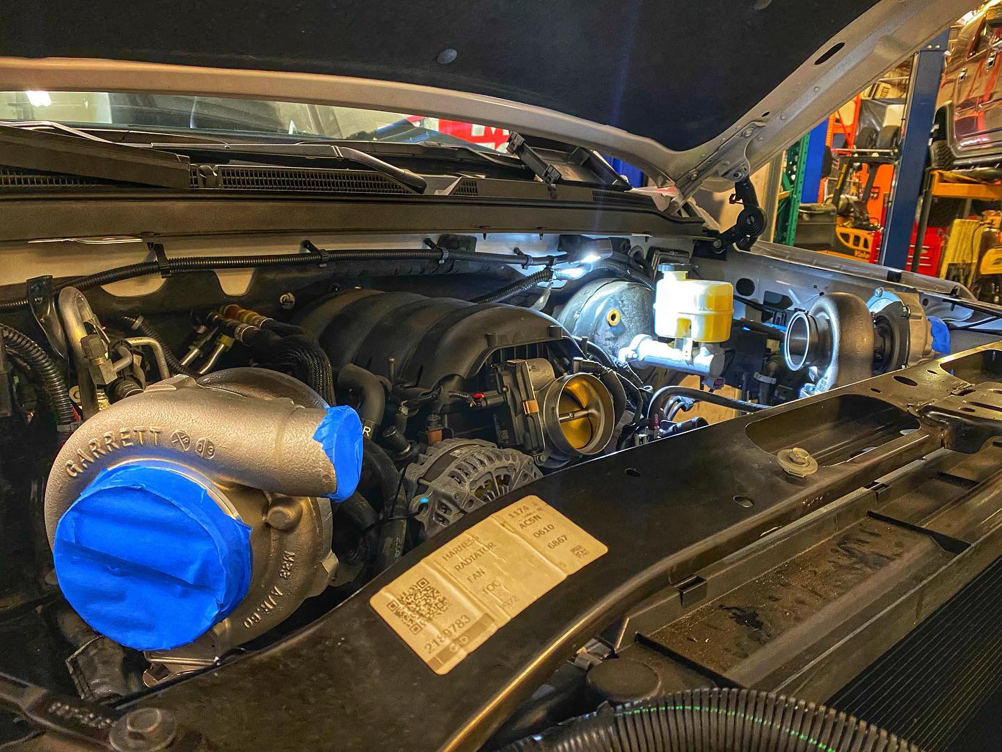

Charge pipes and down pipes being test fit. It's TIGHT!! Also finished up the oil pan modifications and started running the oil lines. Custom catback/cutout exhaust work should be starting soon. Unfortunately, ran into a intercooler fitment issue getting past the radiator on the driver's side so we're working through that as well.

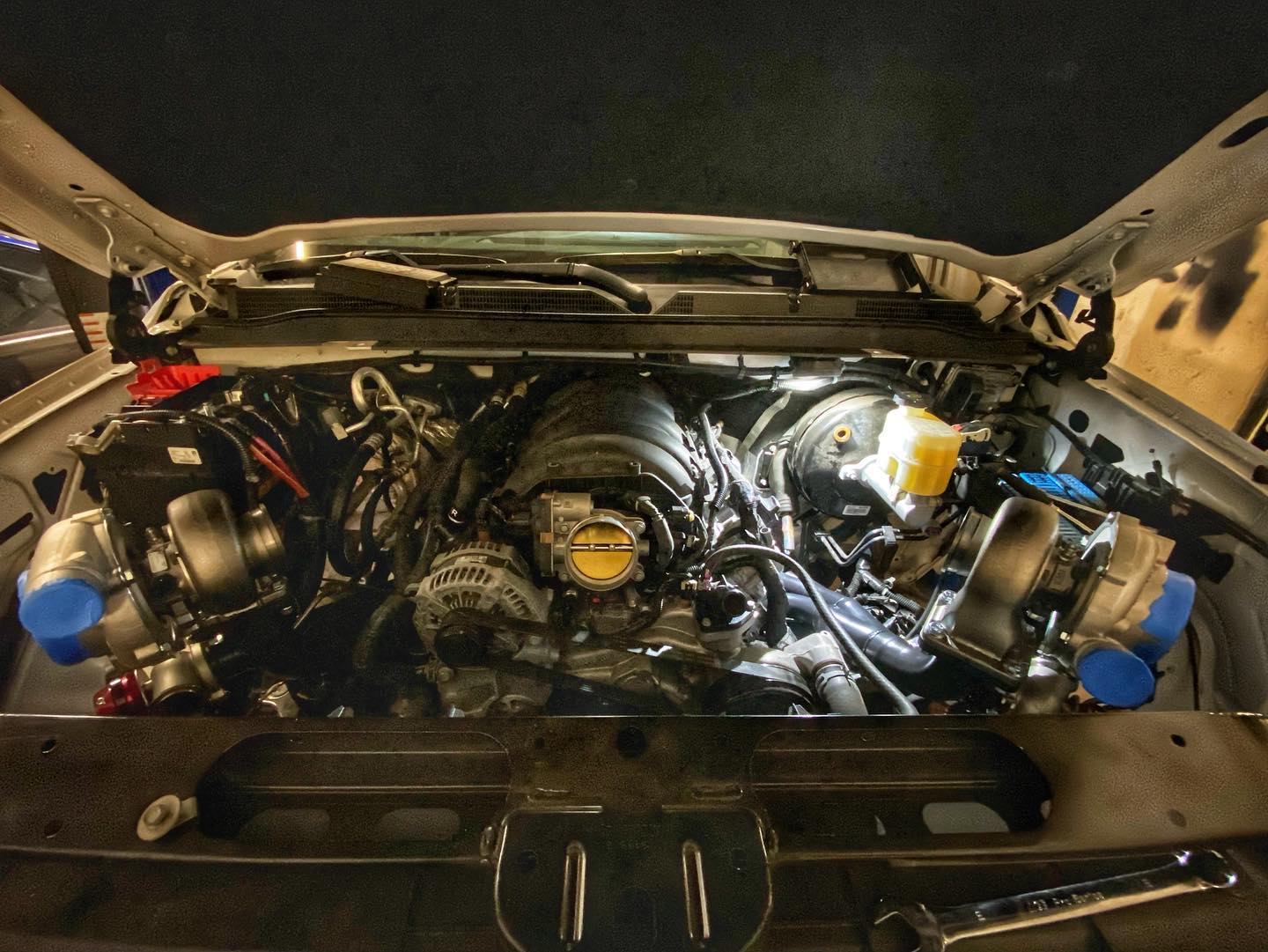

Forgot to snap pics of everything completed to date but here's an updated shot of the engine bay for your viewing pleasure....
