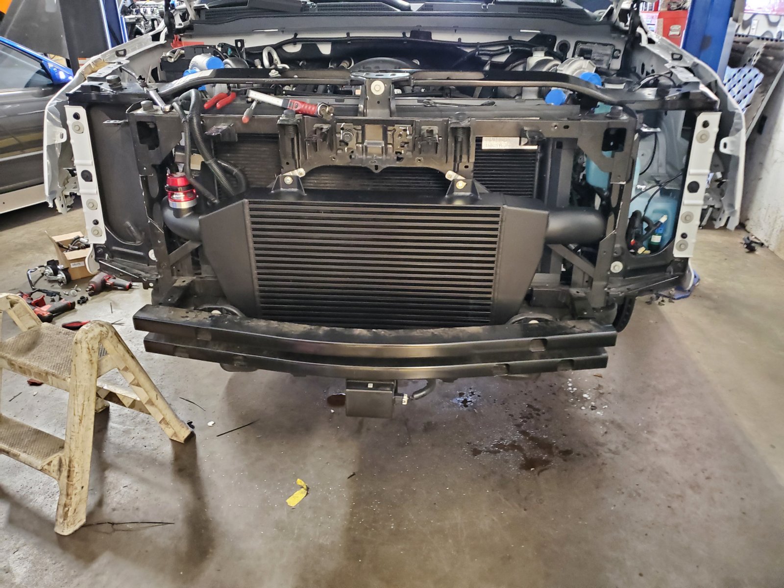

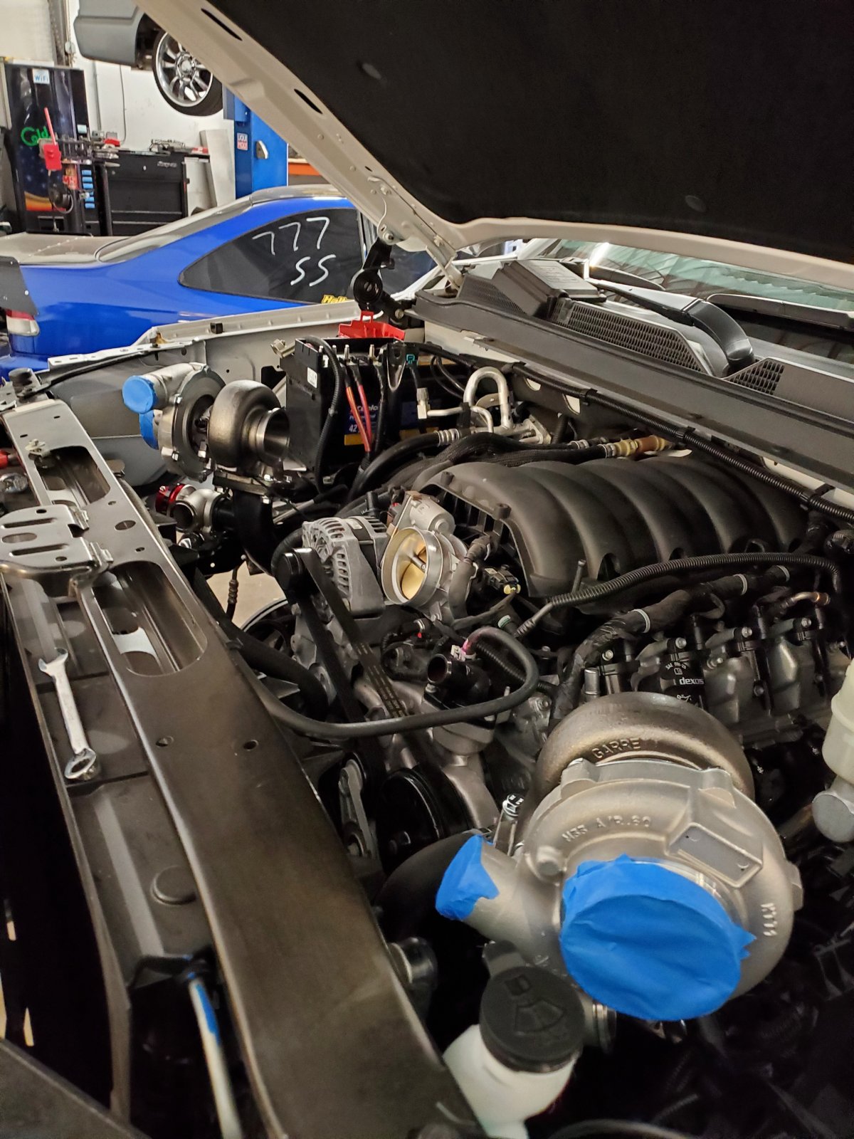

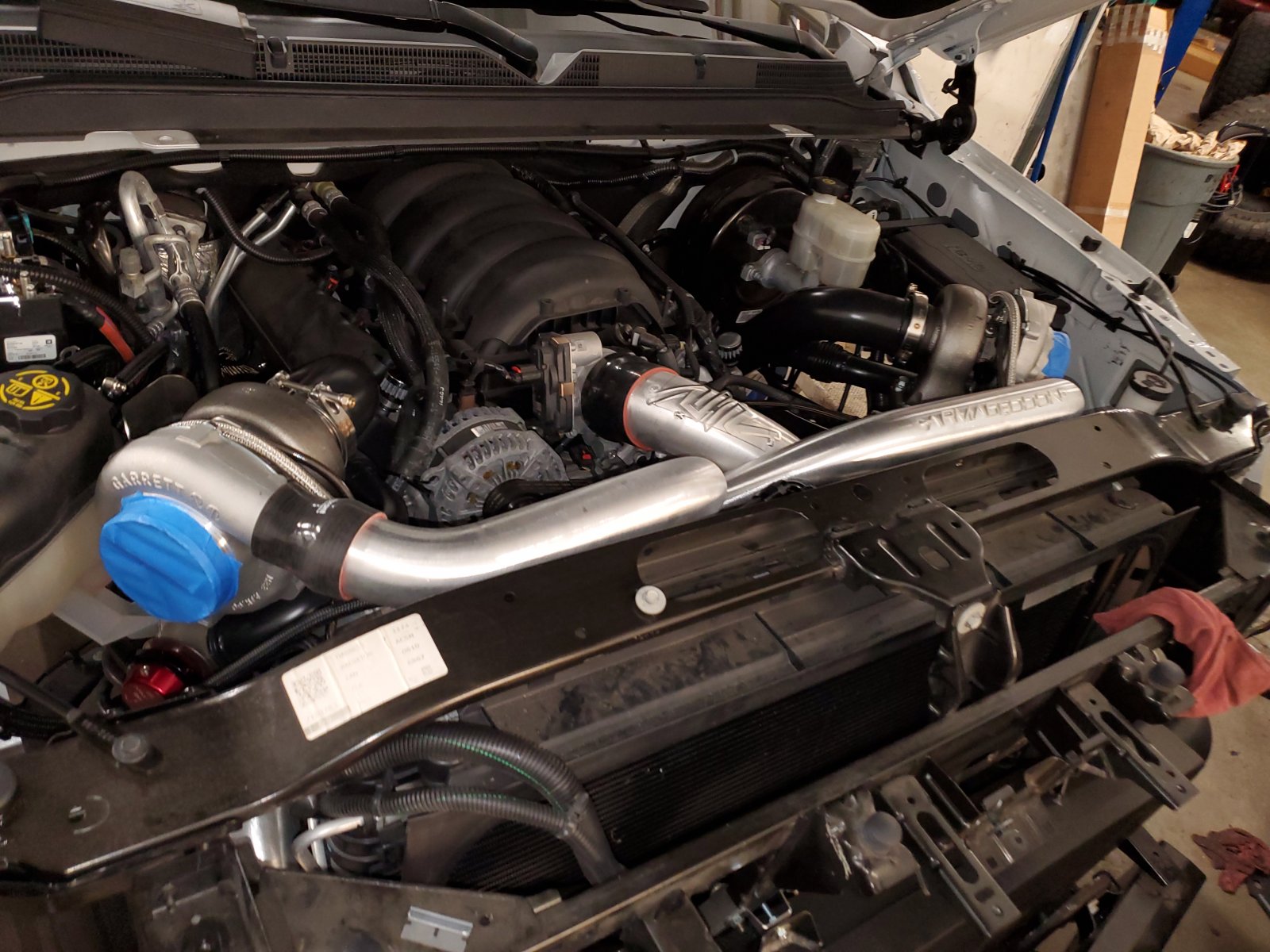

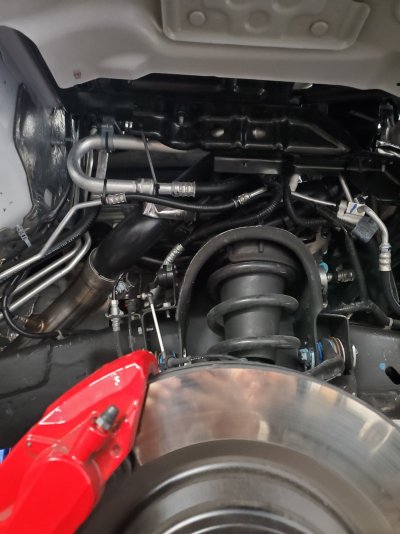

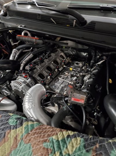

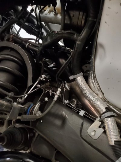

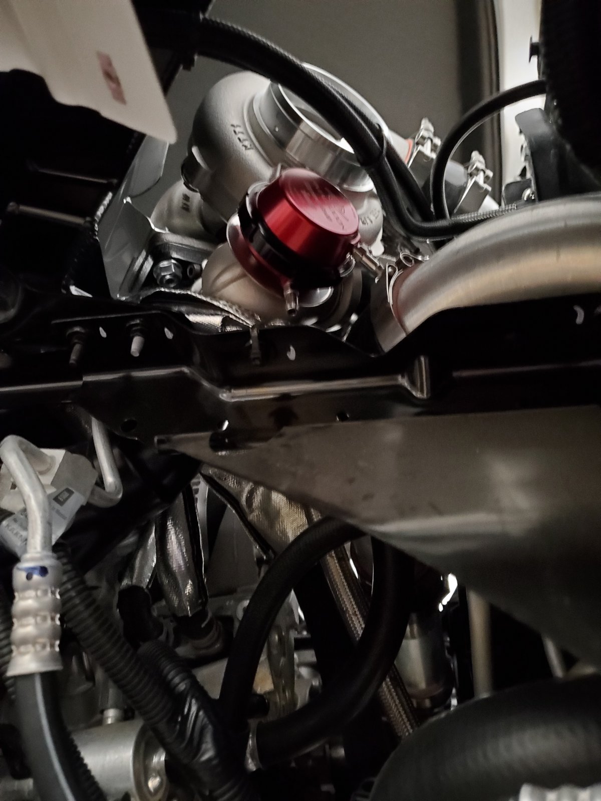

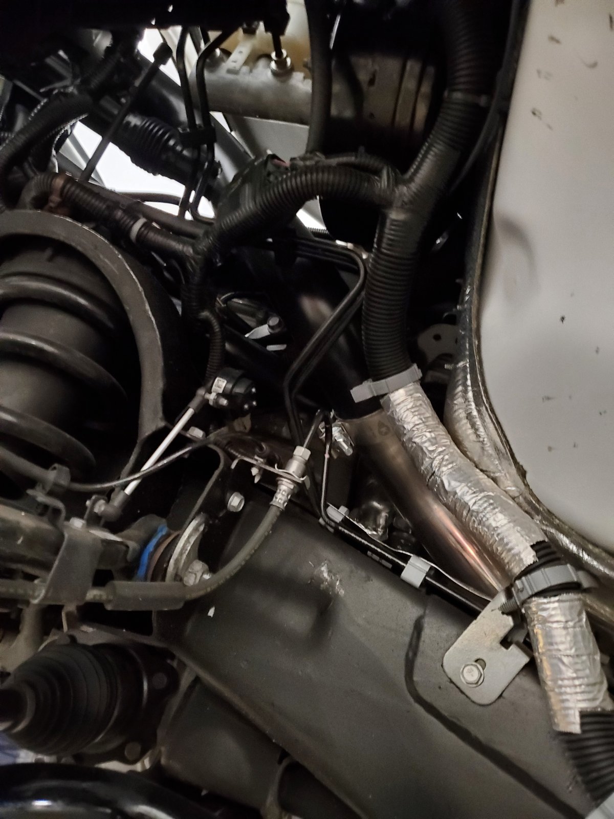

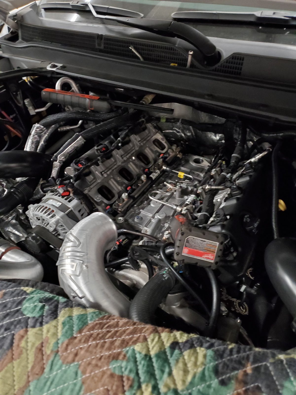

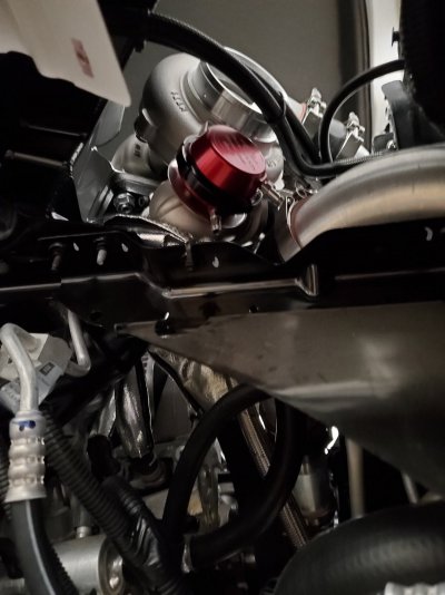

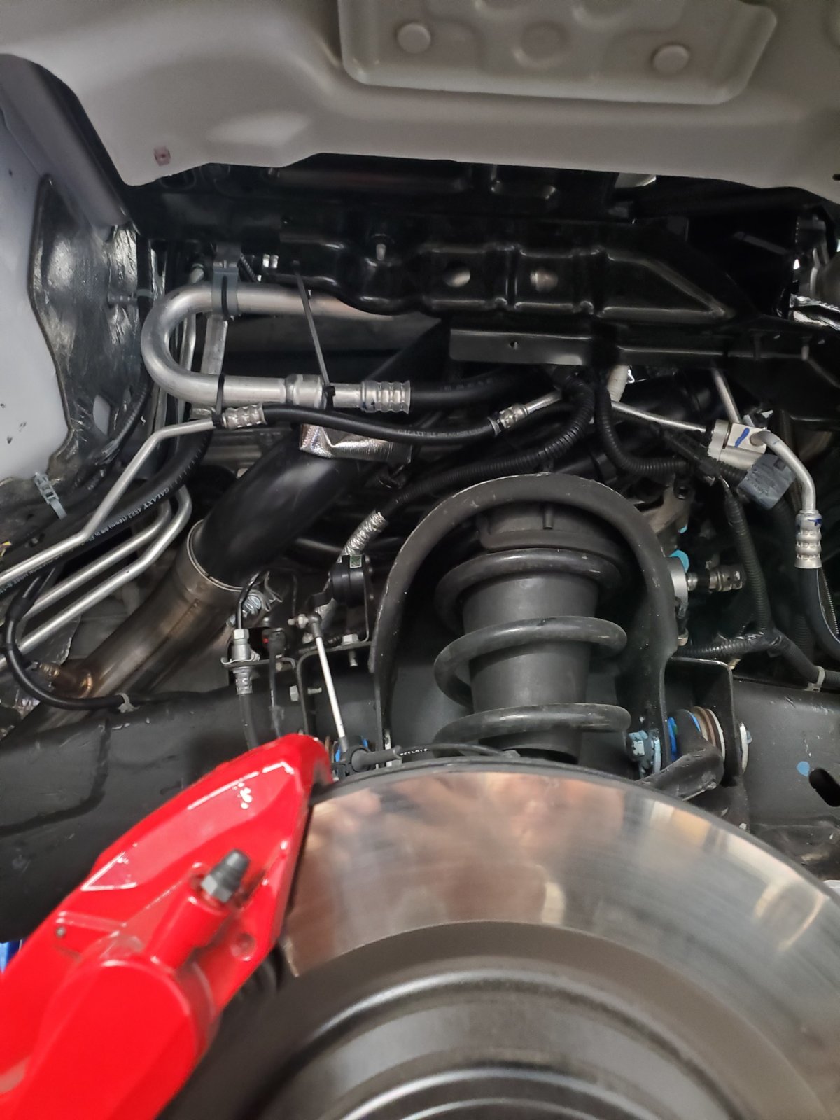

The install is coming along.... The Twin turbo install is pretty much done at this point. We are at the stage of just making final adjustments, cleaning up wiring, and fit and finish quality control, gauge installs, etc. The custom exhaust install has started as well. Cutouts also need to be installed. Here's a few (really bad) pics of the exhaust and a video I put on YouTube of 1st start. The truck sounds MEAN. My cell phone video does not do it justice.

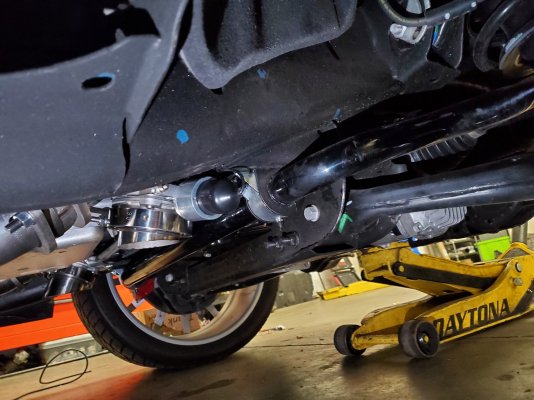

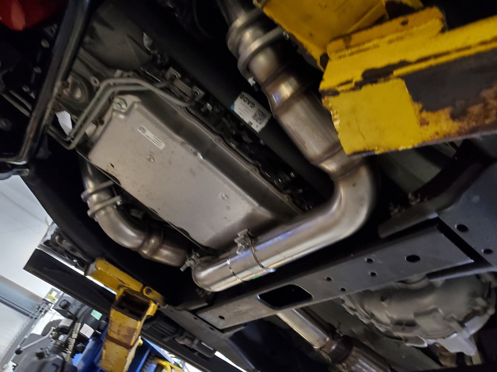

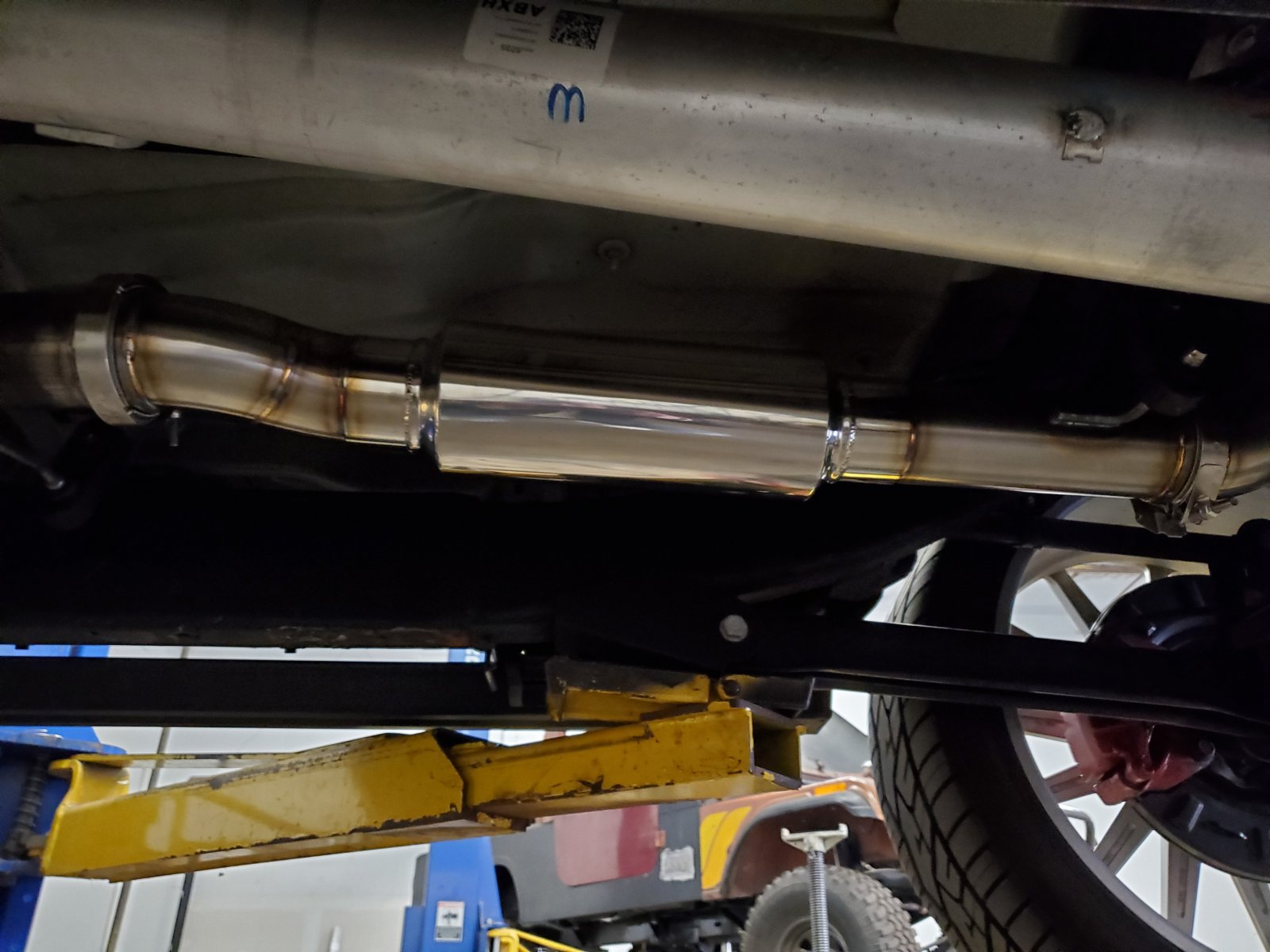

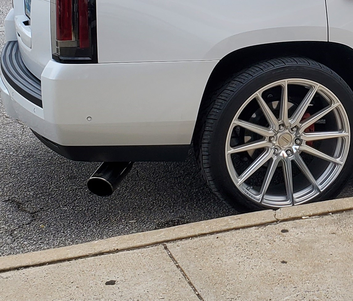

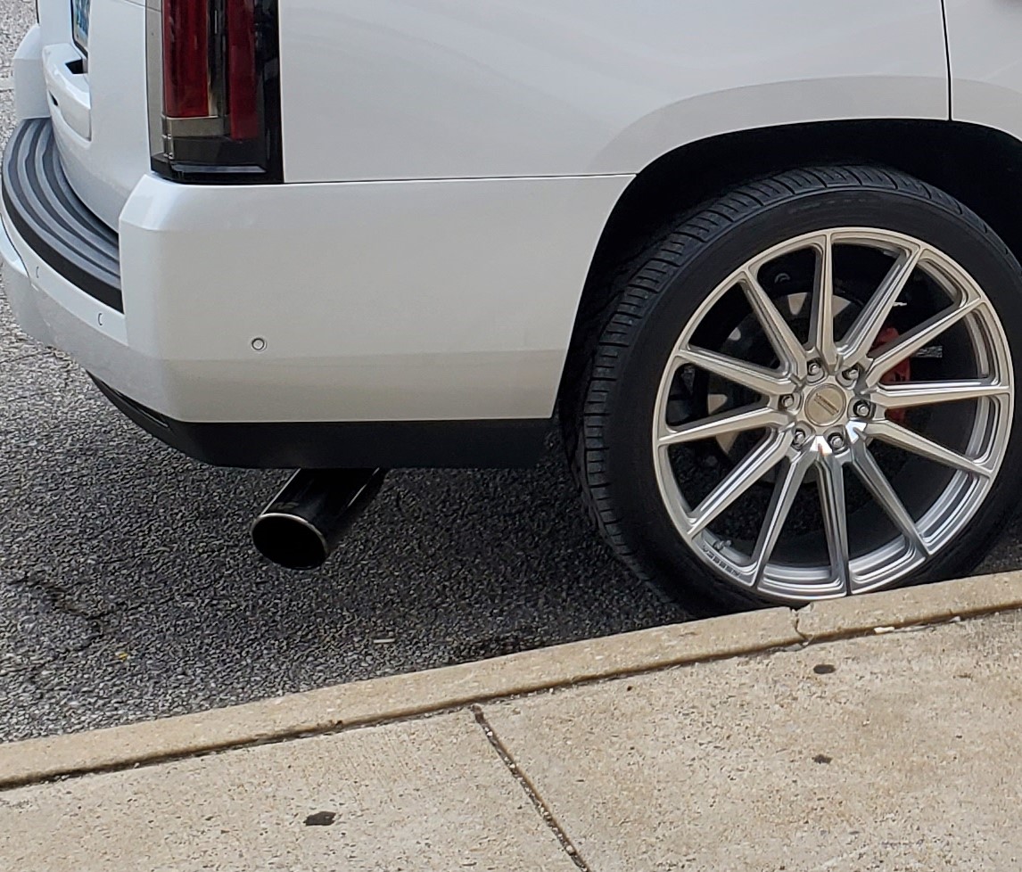

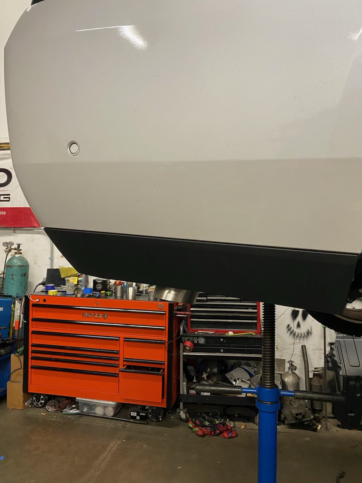

I was trying to go back to the OEM look for the exhaust tailpipe exit (I hated the Magnaflow tip) and we ended going from this:
To this:
Neither look is really my style so I'm having the tailpipe cut flush with the bumper for a hidden tailpipe look. After that it should be time to mock up and install the cutouts.
To this:
Looking good,
Can’t wait to see a driving video, maybe a few drags at a stoplight against another ride ?

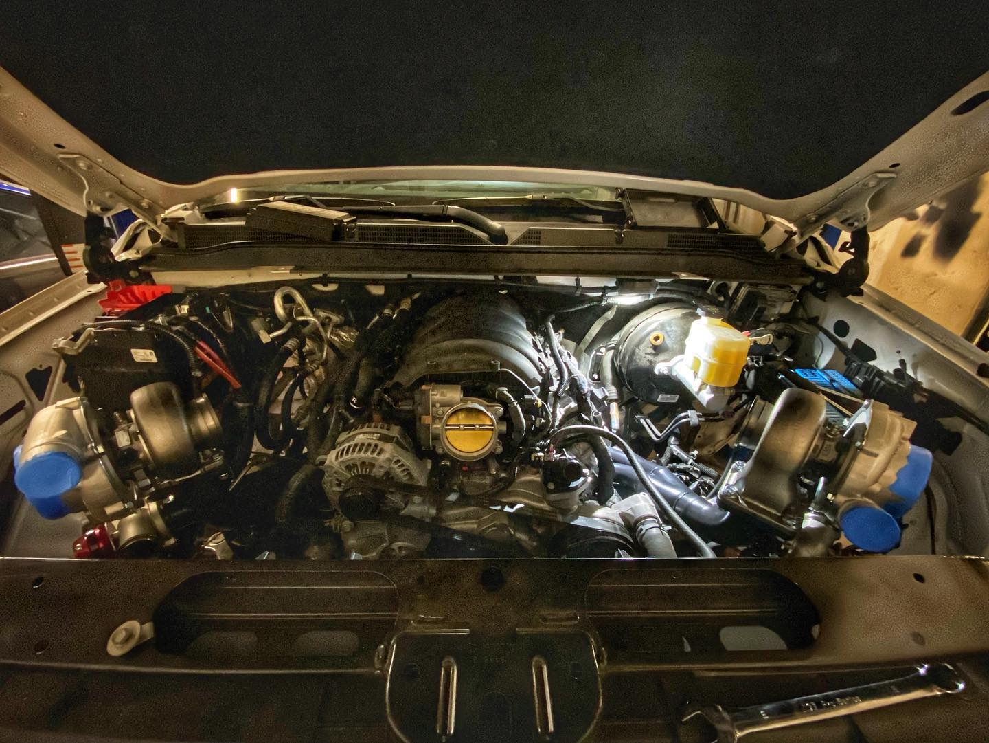

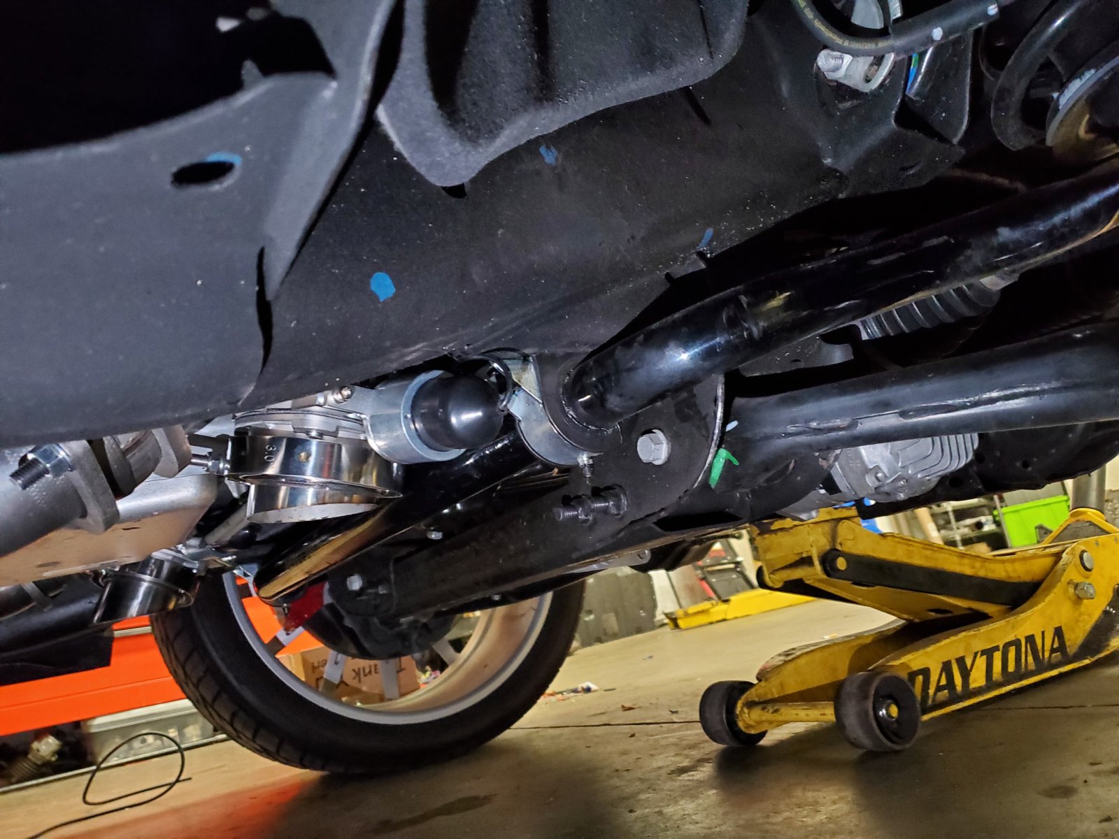

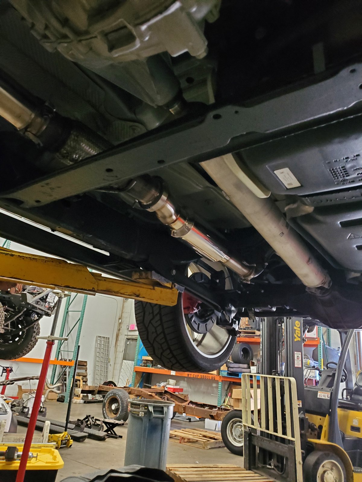

We got the cutouts installed and the engine torn down to do the LT4 pump and injectors. Also got the gauge pod installed. The pod looks better than I thought it would but I'm going to look into having a custom pod made to match the interior for a more OEM look.

Update: The install is done. FINALLY! The Escalade is being transported to the tuner on Thursday afternoon. We're scheduled to get on the dyno Friday morning. I'll share the dyno results as soon as we have them. I also have a ton of pics and several videos that I need to edit and post online.
