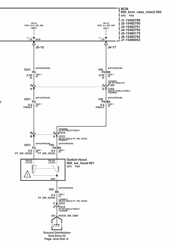

I have no voltage at neither the purple (hood closed) nor the pink/black (hood ajar) wires out at the switch wiring at the core support. However, I have roughly 10 volts at both wires at the BCM connectors (X5 #15 & X4 #17). Should I have voltage at both simultaneously? I thought it was one or the other?
BTW I should add that the ground tests good out at the latch wiring.

yes voltage on both.
purple wire grounds when hood closed
pink/black grounds when hood open
tested wires at core support with latch switch disconnected?
If so, you must have a break or bad connection with wiring.
If you left the latch switch connected, then the switch could be grounding out the voltage.
But it should only ground one of them, so your new latch could be bad, *if* wiring checks out.

The way I read the wiring diagram you shouldn't have voltage at either.
The hood latch is just a simple switch that either connects the purple wire to ground with the latch/hood closed OR provides ground to the pink/black wire when hood/latch is open.
The BCM is looking for a ground signal NOT power.
mikez71
Mar 9, 2023
3,340
4,146
I am assuming the meter is measuring power from the BCM, because something has to ground out, for it to know it's grounded.
If you look at the diagram, it shows BATT and SBAT which I assume is battery and switched power..
Guessing it wants to know hood is latched closed before you drive off, yet needs to know if the hood is open always, for security system & remote start.

I see what it says but it would seem to me that if the BCM is pushing power to that switch and the switch is connecting it to ground it would be a dead short.
