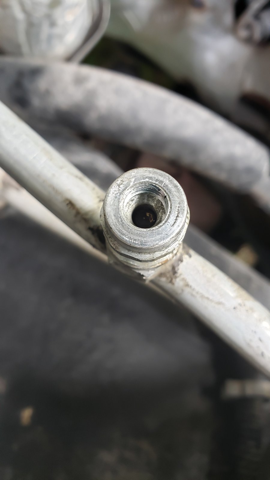

I went to to troubleshoot why my AC doesn't seem to function right and when I pulled off the dust cap for the high side port the refrigerant leaked out. So I picked up a repair kit this afternoon that has a new port and valve cores but I can't get the old port off the line. I have a vacuum pump hooked up to see if I could pull a vacuum but I can only get down to about 20" and when I shut the pump off I lose vacuum pressure. My though was to at least start with changing the high side port. Anyone have any tips where else to look? It's been a while since I've worked with AC.

@OR VietVet I do have the tool to remove the Schrader valve, just not the socket for the port. But the valve is covered by this little black cap so I can't actually get at it

That fittings screws into the line you have to change the fitting. And that's the OE ball style and not a black cap that you was thinking is removable
You can support her on line and use a adjustable wrench to change the fitting

So was doing a little research on the issue at hand. Turns out that the OE ball valve is a one time thing in that it fails after having gauges hooked up. Makes sense because I had gauged on a couple days ago to get an idea what system pressures were doing because the compressor was cycling so the system at least had refrigerant in it. Now today I just went to do deeper troubleshooting and had the leak issue. And turns out what I brought home is another port with a ball valve. Dorman does make a port with a replaceable Schrader valve though so this one I want to return.
