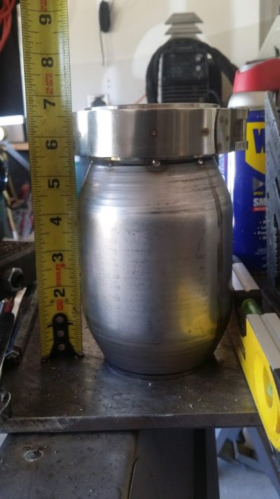

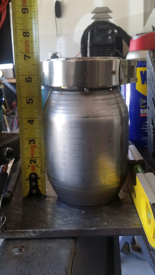

My previous 2dr had Thorley Tri-Y headers and maggy cats.
Yes, I do require them. And they have to be in the stock location, though, I think this has changed recently but still need to have cats. And personally, I like how they sound. Unfortunately, these will be going on my stock manifolds on my 07 but I will be making a new Y-pipe and exhaust all out of 3" stainless.
I had turned down a 59956 cat which is originally 2.5" to a 3" to fit with LT headers because of the space it shortened the cat to almost 6".
I try to keep the O2 as close to the factory location as possible when necessary, otherwise you can get extension for them.

Forgot to post the pic of the cat haha
