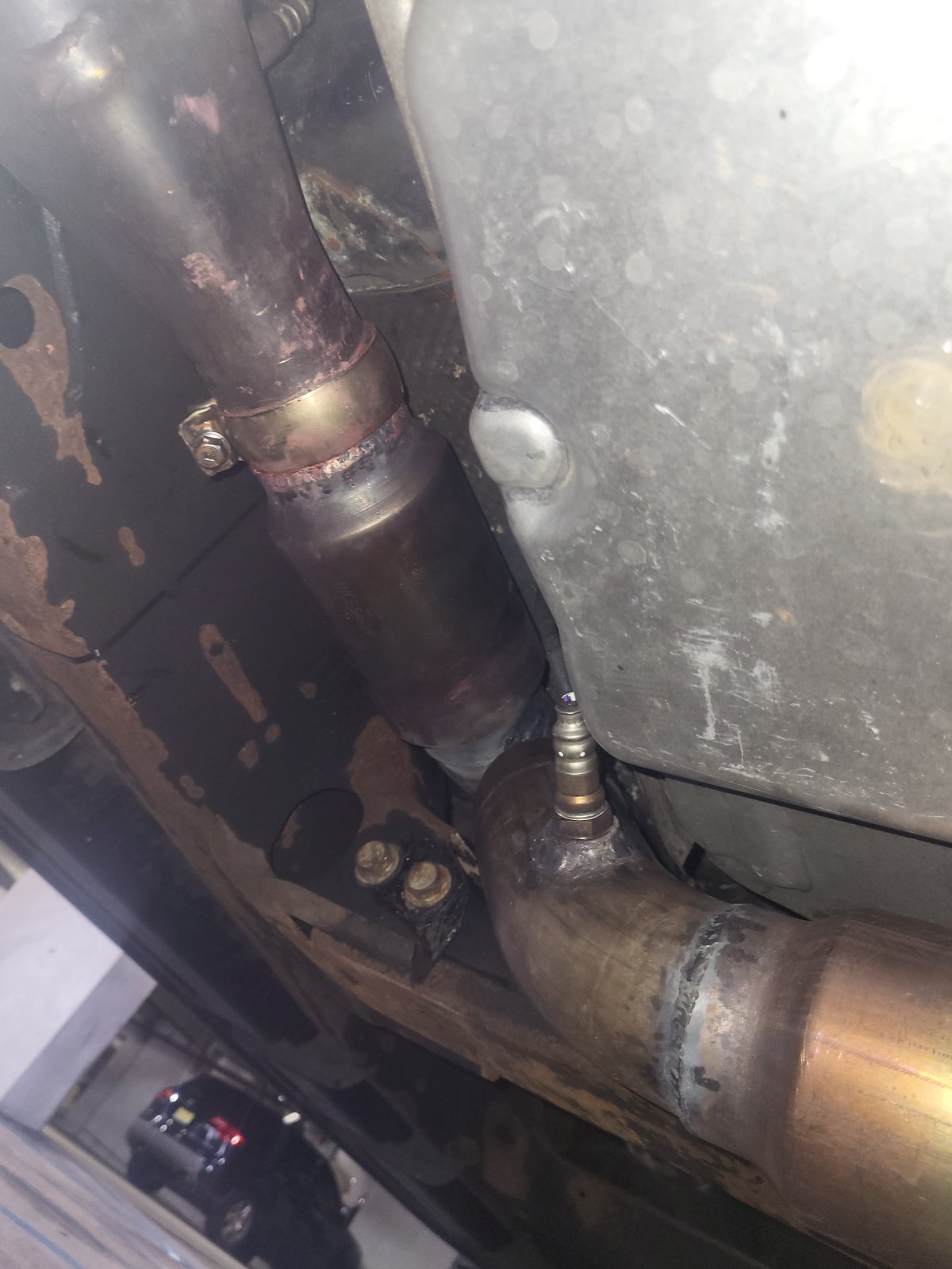

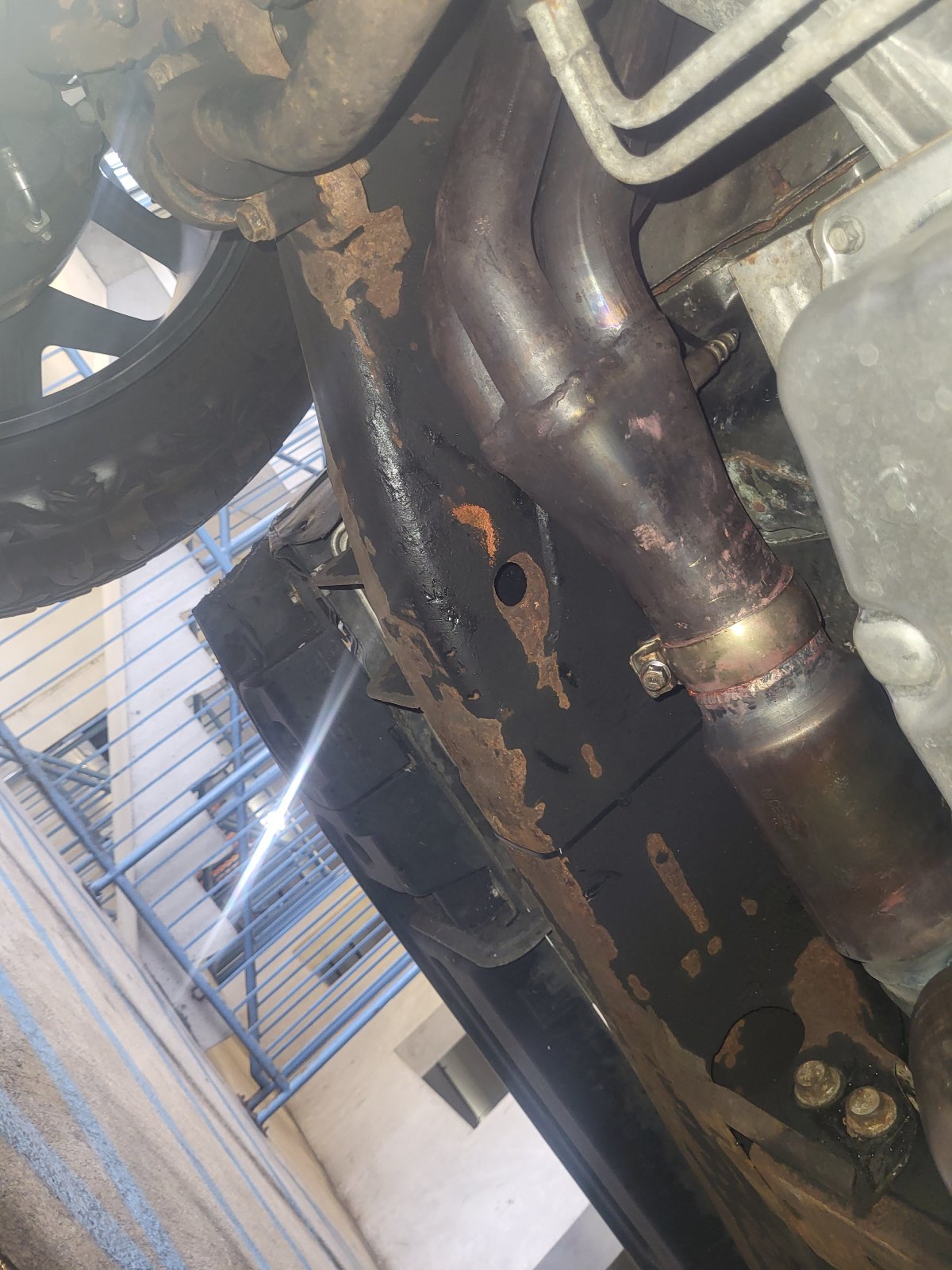

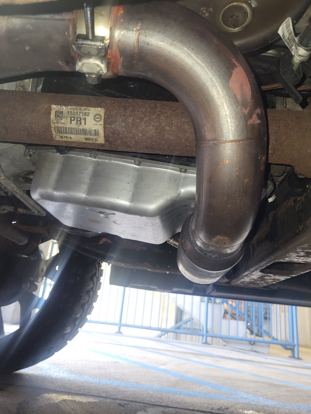

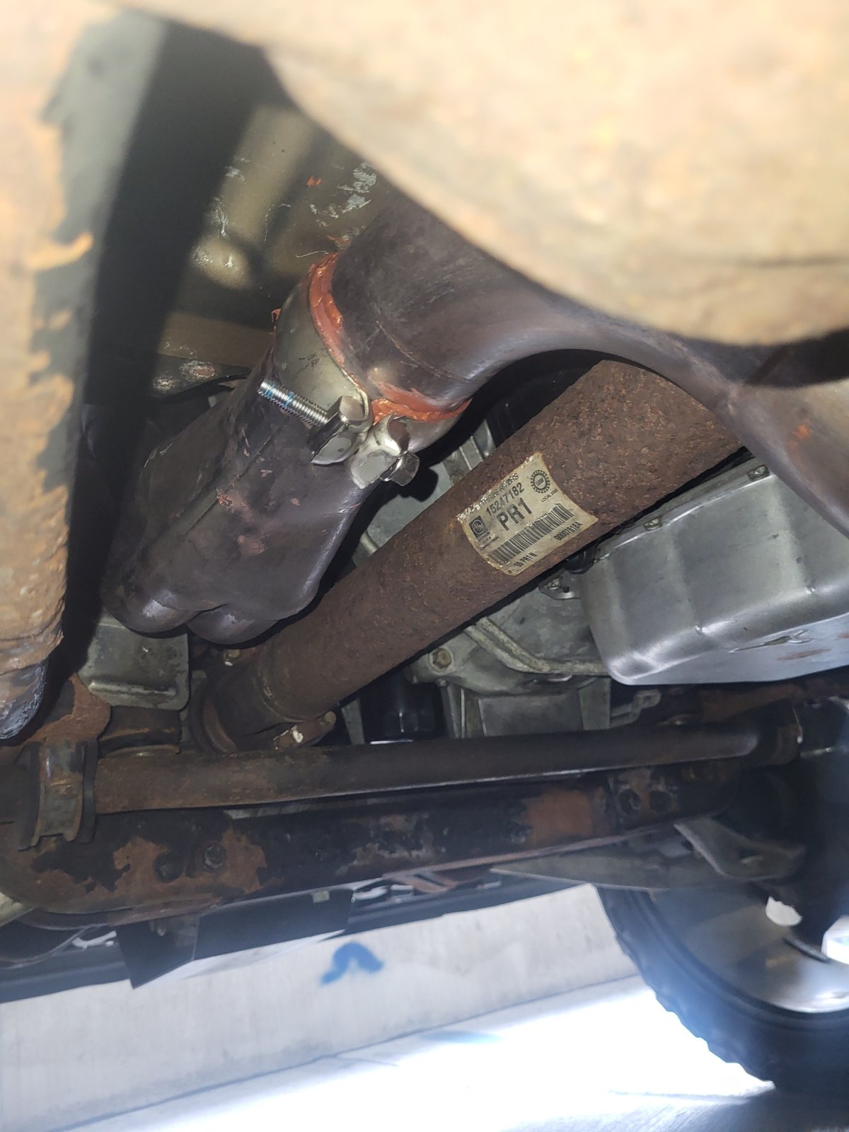

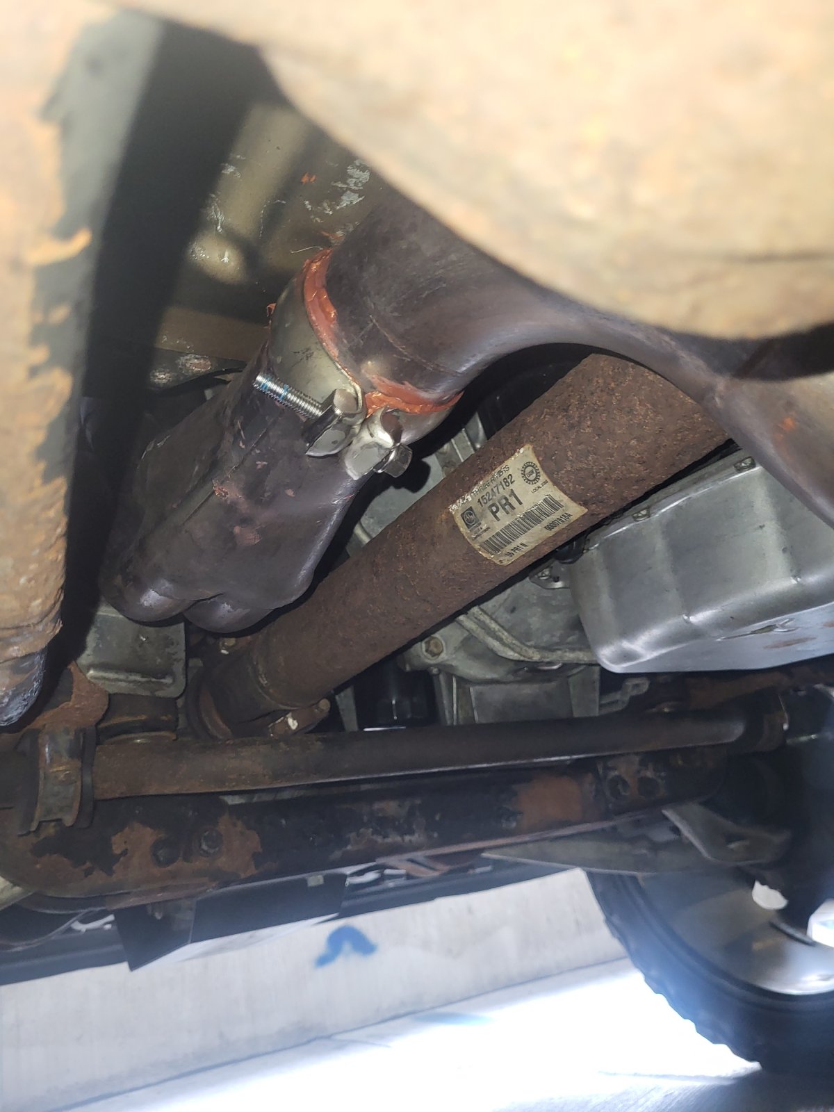

Ok so i did get this installed and boy what a pain. Just like @992dr said, these are for a silverado and yes they are. So the 1st issue we ran into with the headers was that the collecter on the driver side header was contacting the floor of the escalade. So we had to tweak some to make it work.
2nd issue was on the transmission crossmember. We had to cut a nice chunk off of it for the pipe to run through and connect to flex pipe. Had to modified the y pipe to make it work. Luckly this guy is a buddy of mine and hooked me up but its not worth the hassle. Guy that sold me these told me he had it on his escalade which obviously there was no way.
As per cats, i bought 2 of these
I beleive i got them off summitracing. They are alittle to big for my liking so that was another hassle to make these work.
Here are some pics.
C
crownvic31
Jun 13, 2022
212
176
One of the cats seats right under the trans pan. The o2 bung was welded right after it. I do have the check engine light due to the positioning of the o2 sensor. I also have a blackbear device whicb i am waiting to fix something before doing the tune.
My suggestion is to buy what fits. Modifying is ok if you have the skills or friends that wont charge you an arm and a leg but this wasnt easy. Does look good though .

Good to see you finally got them installed. If you do alot of short drives that flex pipe will rot pretty quick.
Will the cat being so close to the trans pan cause any fluid temperature (atf) issues? Gonna relocate that o2 bung? At least you're emissions legal now. How's it sound?

Why you say that about the flex pipe? My trans fluid temp in 90 degrees weather never went higher then 154. I also do have a tru cool cooler installed. The o2 rear will stay where it is. I will delete it with the tune if black bear cant adjust and make it work. Sounds pretty much the same as with the shorties i had. I guess the reall difference would had been with out cats? It does pull harder. Cant wait for tune

Personally I've had bad experiences with flex pipe. If you do short drives condensation collects in the grooves of the pipe and rots it out pretty quickly.
