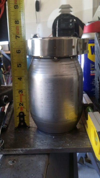

It's been a while, but I have cut down cats for this exact reason. It's easier to adapt them with a little ingenuity.
They started out as 2.5"in/out Magnaflow spun metallic converters, and I cut them down to 3" in/out. It shortens them quite a bit for tight spaces.
Personally, I'd prefer a quality header and a fabricated y-pipe :)

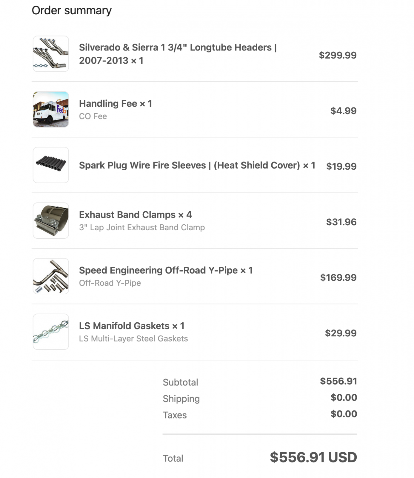

I'm probably going to roll the dice with Speed Engineering headers and Y-pipe. There seems to be many more positive experiences than negative.
I’ve had 4 sets or more on my trucks and haven’t had an issue with them at all.
Also just about every one of my friends has ran them also (atleast 6 off the top of my head) with no issues and my tuner put me onto them and can get them discounted (think my last set was like 275-300$ something.
For the money I’d buy another dozen before I spend 1000$ or more for a different set
