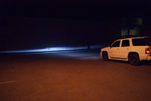

One of the more fundamental differences in projectors (there are projectors for both HID and halogen bulbs) is that halogen projectors tend to focus and magnify the light in front of the vehicle, while HID projectors tend to focus and spread the light in a wide pattern, giving you a usable beam width and depth that can't be matched by a halogen bulb. I have usable light that extends a couple of lanes to each side of my truck. See the following picture for how wide the beam is. Then try this with a halogen light and compare.

DEPO's are often recommended because they have above average cutoff and spread for a cheap aftermarket light. They are not designed for HID's, though, and instead have halogen projectors. In essence, the projectors that are there, and the same can be said of all aftermarket projectors for these trucks, are made for a much weaker light source. I'd be interested to see a shot of the DEPO's without HID's, actually. The cutoff and brightness would be interesting, and a benchmark for comparison.
Bottom line is a typical Tahoe stock reflector with an HID capsule just blasts light all over the place. Yes, it might be brighter on the road, but it's brighter EVERYWHERE, including other people's eyes. The point of good projectors is to keep the light bright but out of other's eyes.
