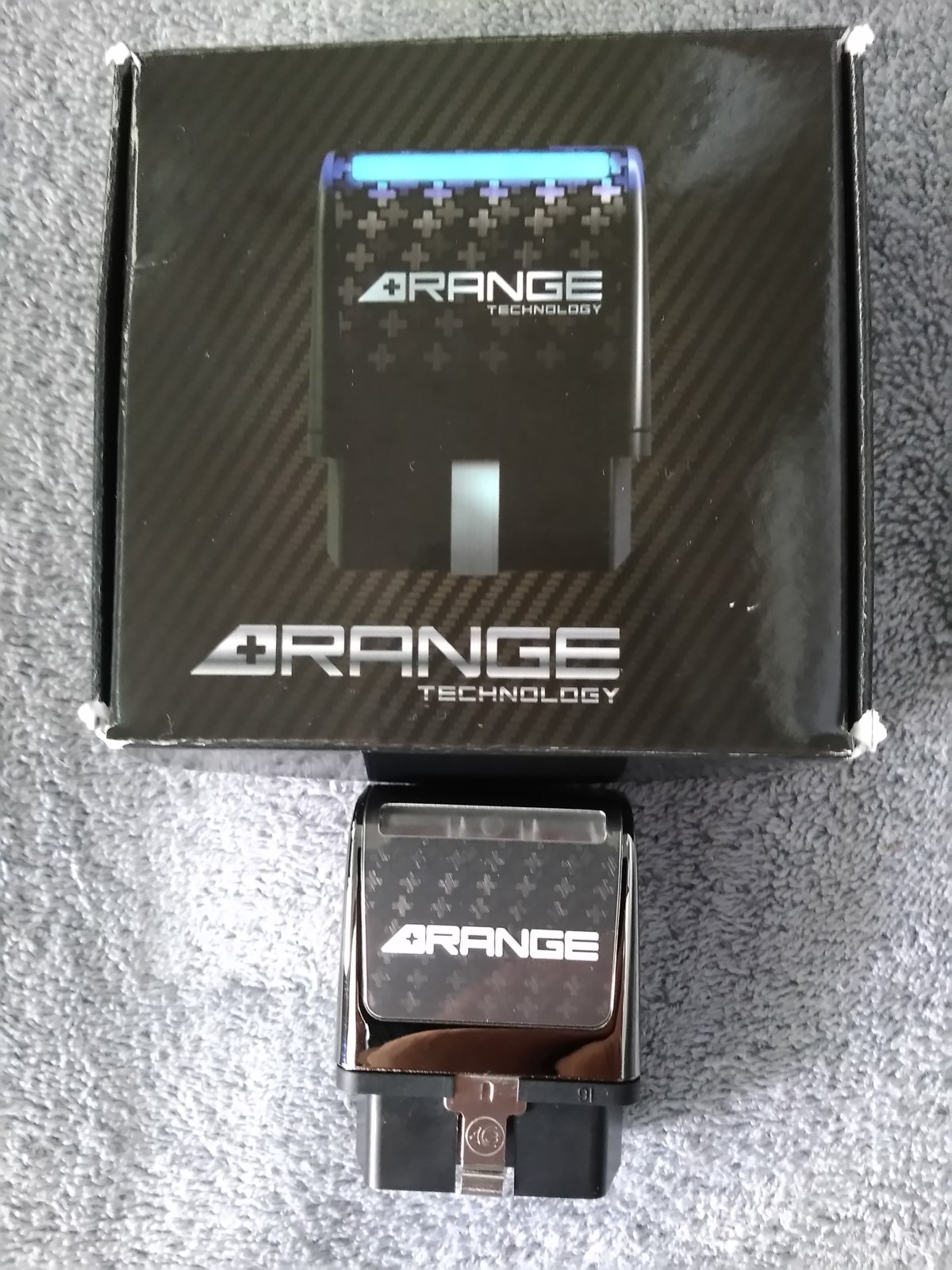

there are some simple options to turn it off, almost any off the shelf tuner will allow you to disable It, typically they run about $300, you can find them used and un-married on ebay for half that price, there is a another little device that plugs into the obd port and you just leave it there made by range technology but even those run a couple hundred. my opinion is to just get the little tuner as they can be found easier used for less and call it good. other options are to have it deleted but that requires at least a partial tear down of the engine and reprogramming the electronics.

Bought the Range + ... My problem solved.

Be careful if you buy from somewhere other than www. RANGETECHNOLOGY.COM (PH: 888.997.6515... There's alot of knockoffs! And you might not get the latest version.
