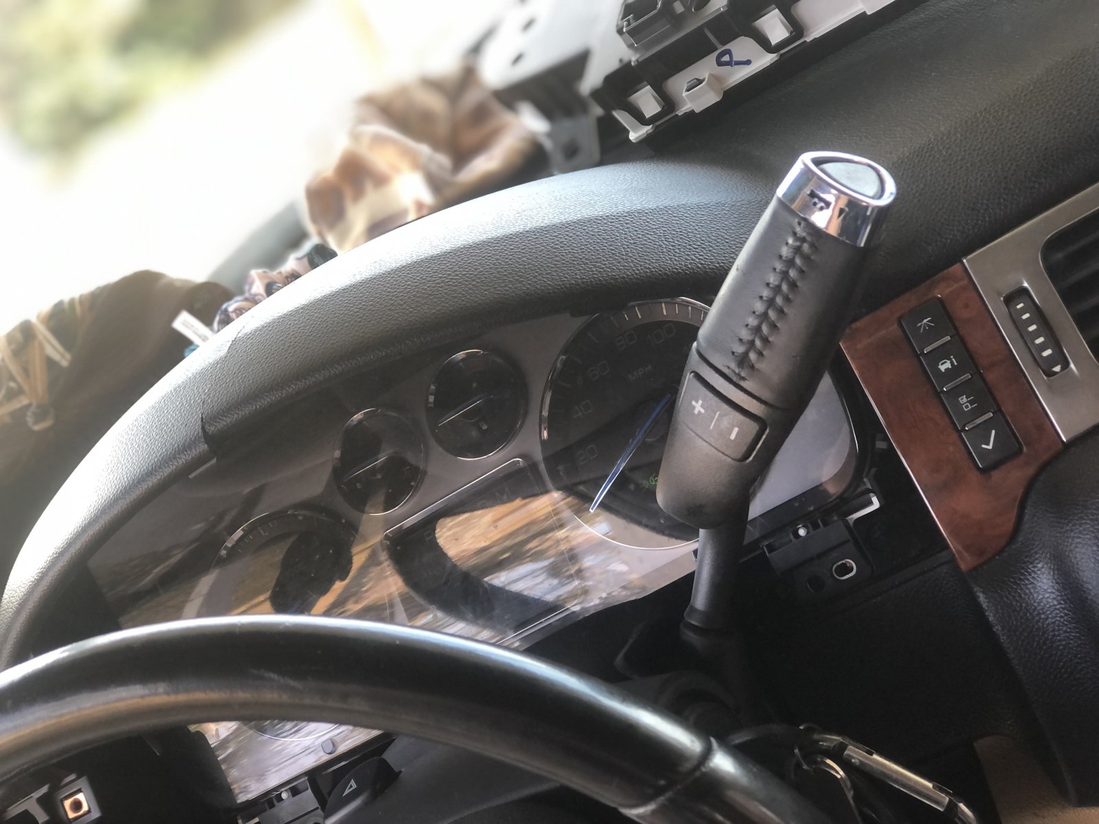

recently installed a Escalade cluster and messed up along the way and popped the fuse. I swapped it out and got the cluster to power up all the warning lights along with the menu items but the guages Speedo tach and trans temp etc are not working? Has anyone done this swap give me any insight on what I could’ve done wrong?

Got it situated the day after this post there’s groups of matching wires (pink,green,purple) that if not matched up correctly will cause parts of the cluster to not work. Just had to swap a couple wires around trial and error and got it fully functional

Thanks buddy just got to find someone who can piece the two shrouds together so it’ll look stock! I did it in a day it was easy but gotta be dedicated cause I went in cutting the harness no turning back!
