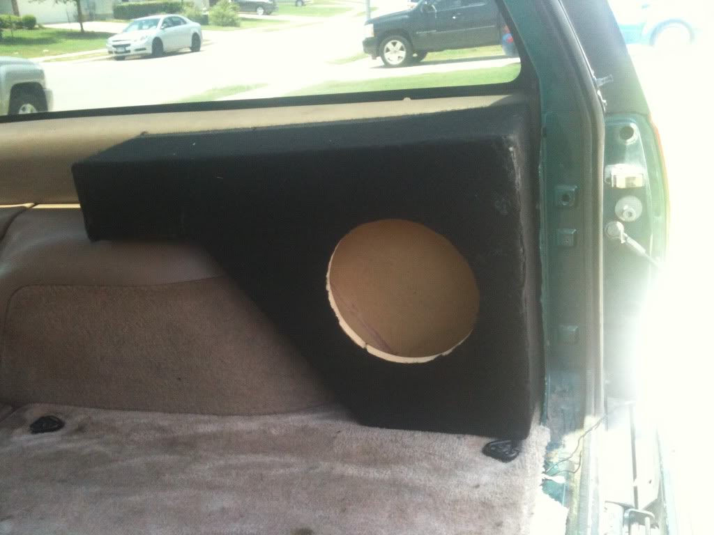

I would go with the 6x9s for, as for the bass, one 10 is the perfect amount imo. For subwoofers I personally am a MTX fan or my second pick would be Rockford. For amp I always go with a MTX amp. As for the box, I actually just finished my build the other day. Not hidden but out of the way, leaving same space as before.

do you fold down the rear seats a lot? Thats the best place for a sub and amp combo and for it all to be hidden. I also love using my cargo shade so kevins box wouldn't work for me. IM a big fan of JL and kicker, on the pricy side, but you get what you pay for.
heres a few pictures ive found over the years that i use for reference.

Agreed. I used the sunshade to cover up my guns and crap like that from prying eyes. Unfortunately, I have to keep my rear seat in its proper position. I'm too tall to sit in the driver's seat with the rears flipped forward.
I think I might have to bite the bullet and spring for the Q-logic rear door panel for a 10 in the back. Maybe mount the amp to the floor in the front of the cargo area out of the way. Probably have to rig a fan if I put it under the seat.
