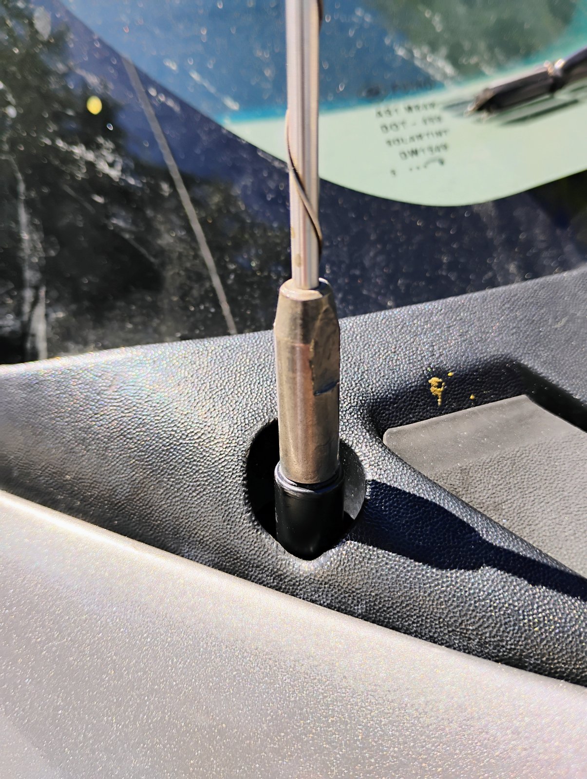

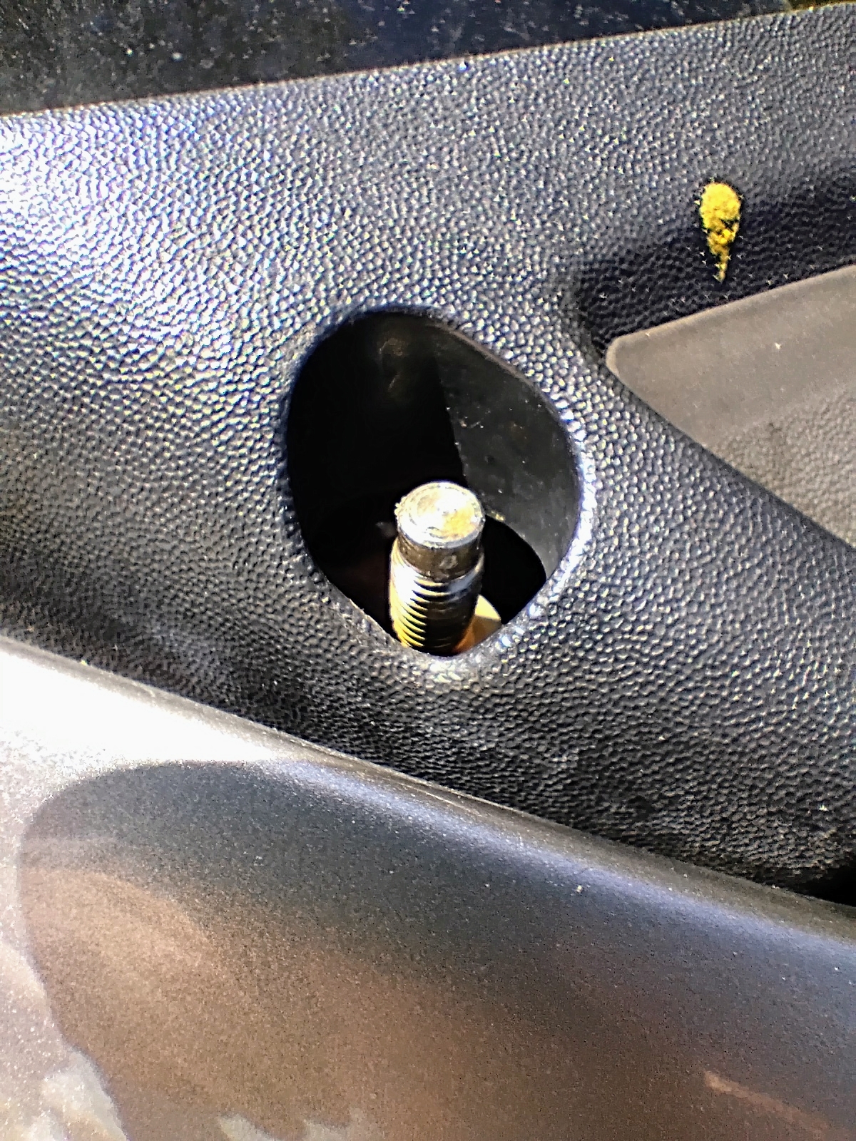

Update - radio is kinda sucky after a few days of living with it, only because my truck has antenna/reception issues. I installed the 12v solution found here:
But still had crappy radio reception, so WTH? I looked at the actual antenna and it's just sitting on top of the threaded male connector that comes up. The inner part of the antenna is stripped so it won't thread/screw down so it was just staying attached by the sheer act of gravity. Off to the pick n pull I go.....

So with a 7mm adapter I was able to get a GM antenna on. Radio reception did not seem to improve. Granted I live in a mountainous area, but other radios in our fleet have no issues with the same stations this one struggles with.
Not sure what else to try other than maybe a longer antenna......? The old radio had one of those flat windsheild mounted ones but it wasn't that great IIRC, maybe I should try it again....

The 12v adapter was a wild goose chase because my antenna doesn't use it. Consulted a local car audio shop who confirmed that fact, and they had an OEM GM base in stock so I took it home and installed it (pain in the ass). Put on the junkyard antenna but it sheared off the adapter while tightening it. For some reason I kept my cool and ordered a new brass adapter and a new antenna. Hope to have it all finally done this weekend.
