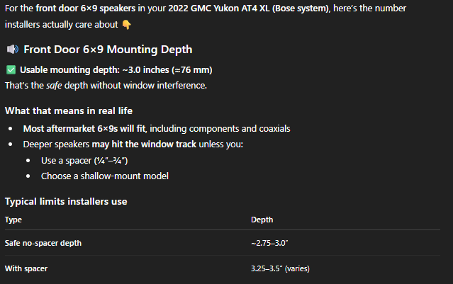

Since I have not opened my door panels thus far, ChatGPT is calling out:

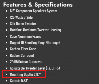

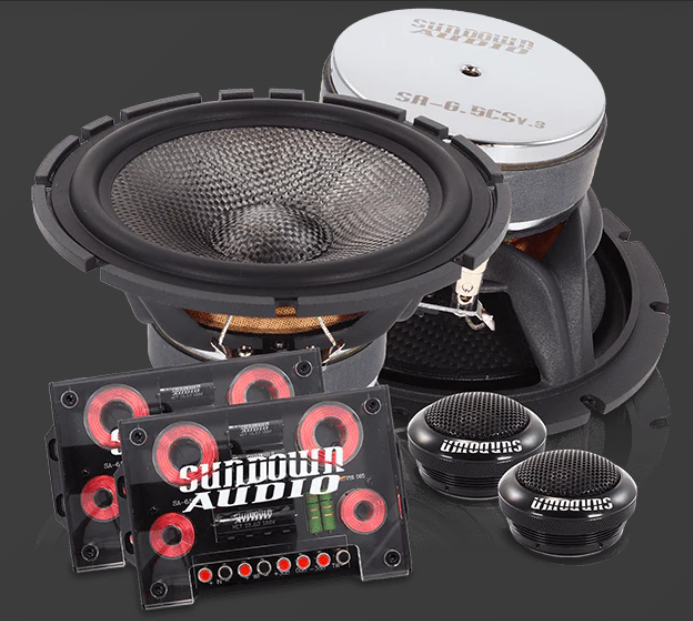

Considering ordering (for front and rear doors):
Only concern would be the mounting depth/excursion distance so not to hit the trim, as I want to keep the stock look/panel and not add on any external covers. Based on the above, should be good. I can design/3D print a 6x9 to 6.5" insert (in ASA or ABS). Same would hold true if not an exact fit on the dash/rear tweeters (3d print a solution).

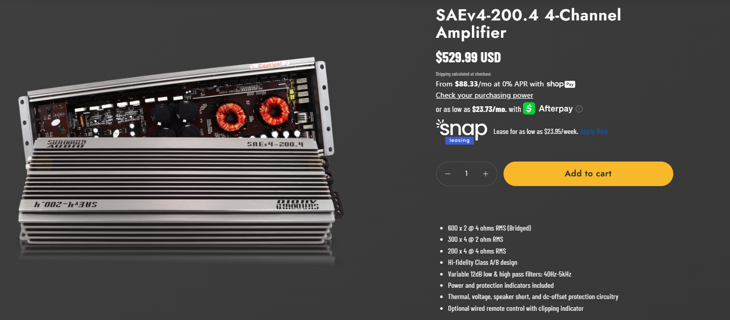

Most likely to run this amp for satellites:
