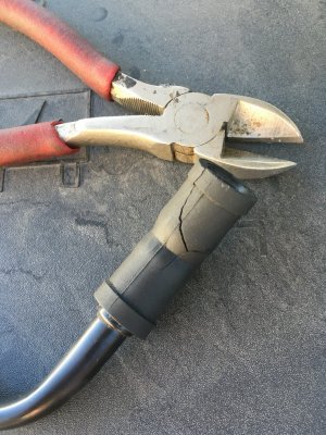

So it looks like my 2006 is different.... ugh... no valve. Just a tube that’s part of the vacuum hose.... now what?
View attachment 231899 View attachment 231900
Not sure what you're trying to do, Chase? If you're looking for a clog or something, that house just pulls off. Be careful, though, the plastic gets brittle and likes to snap at the connection on the intake.
Why not put a catch can on it?
I was hoping mine would have a removable pcv to clean ir replace, and maybe that might help slow the oil drips. I guess not so much...
though my oil leak is not anywhere near as serious as the OPs. It’s on a few drips a day. But it’s annoying. I don’t think a catch can would solve my oil leak.
No, but it would catch the stuff you're suspecting to have gunked up the PCV and caused the pressure that may be contributing to your leak.
Anywho.. there is a "valve" at one end of that hose.
If there is it doesn’t come separately from the hose. I pulled it off yesterday. I have a new one coming in tomorrow afternoon because the opposite end where it attaches, the plastic is cracked. Thought I had a pic of the whole piece. I’ll have to take a photo tomorrow when I put the new piece on.
That’s the pics that attaches to the valve cover. There isn’t a “valve” at the other end, at least not that I can see.
