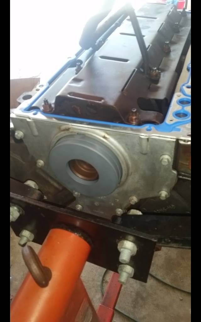

If it's dripping there has got to be an obvious source. Did they check to see is the rear plate was properly aligned before putting in the new seal? I have the plate alignment tools from Sac City Corvette and I haven't had any issues with leaks. I didn't want to chance having to do it twice..
The gray piece is the alignment tool, but the plate has a big gasket around it too..if they removed the plate they need to RTV the corners connected to the oil pan or you will have a bad leak..

Don’t want to derail off original topic too much, no an alignment tool wasn’t used when we did the rear main, and RTV was used.

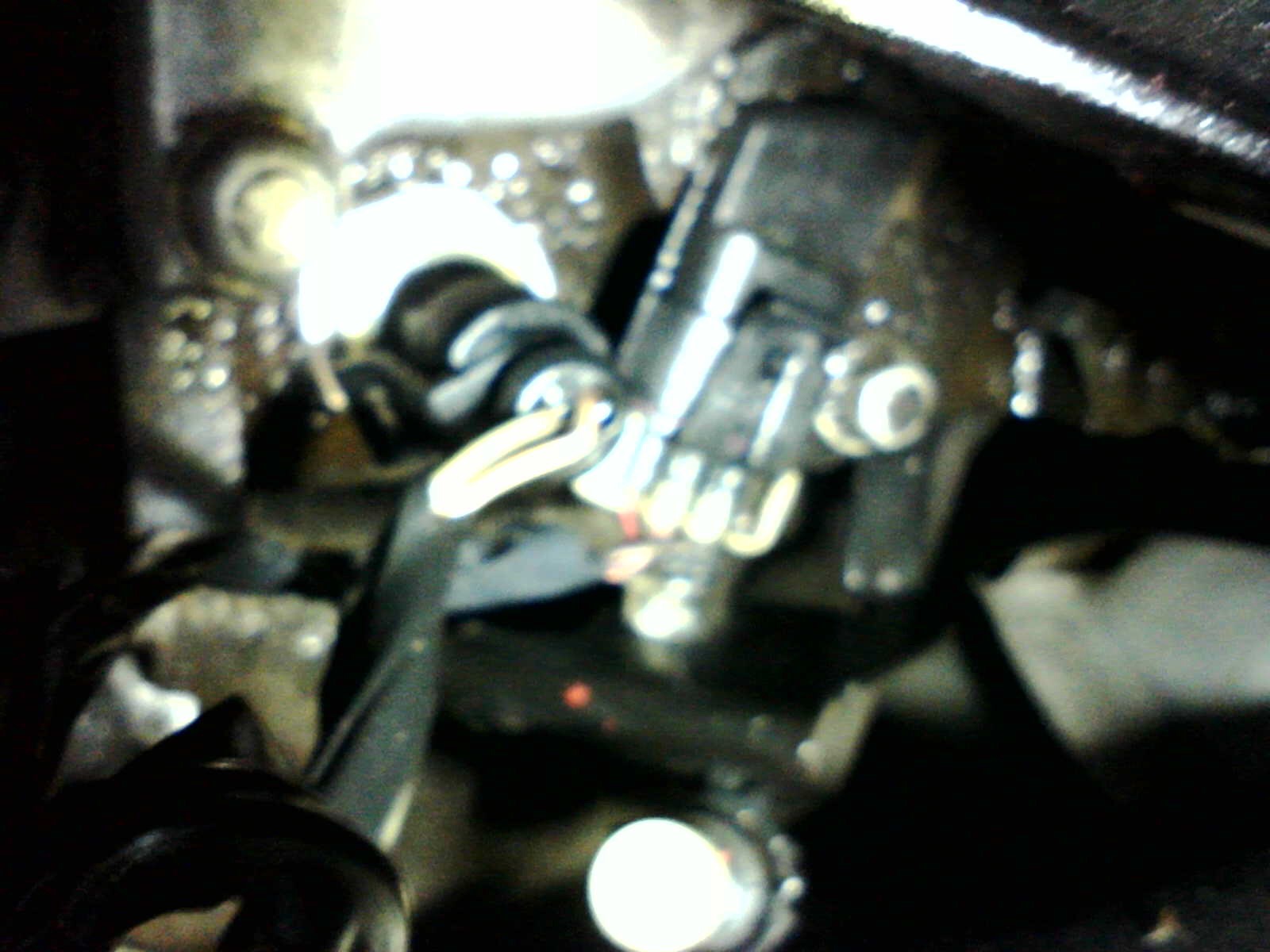

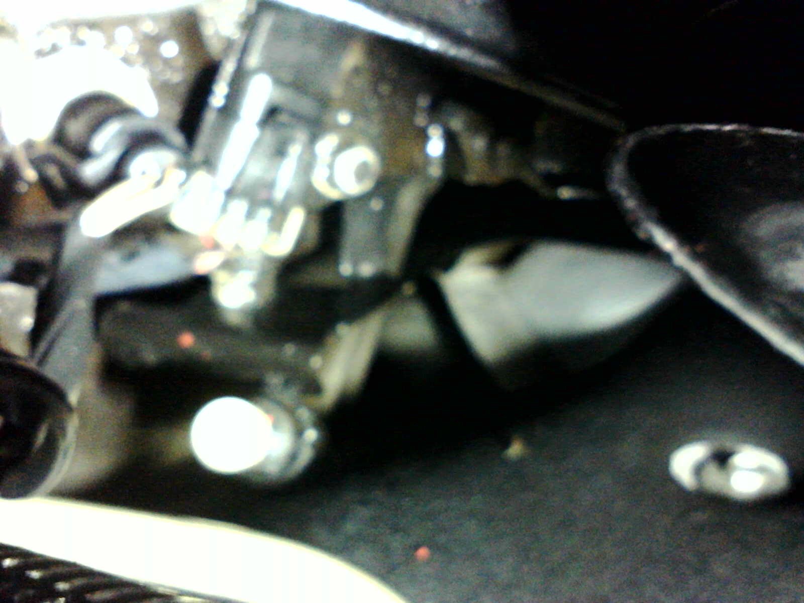

Decided to try this cheap endoscope somebody gave me to check for oil back by the camshaft position sensor, oil pressure sensor, etc. I know it’s blurry, but it looks like oil to me. I swapped the oil unit before. Anybody else think this looks like my leak?

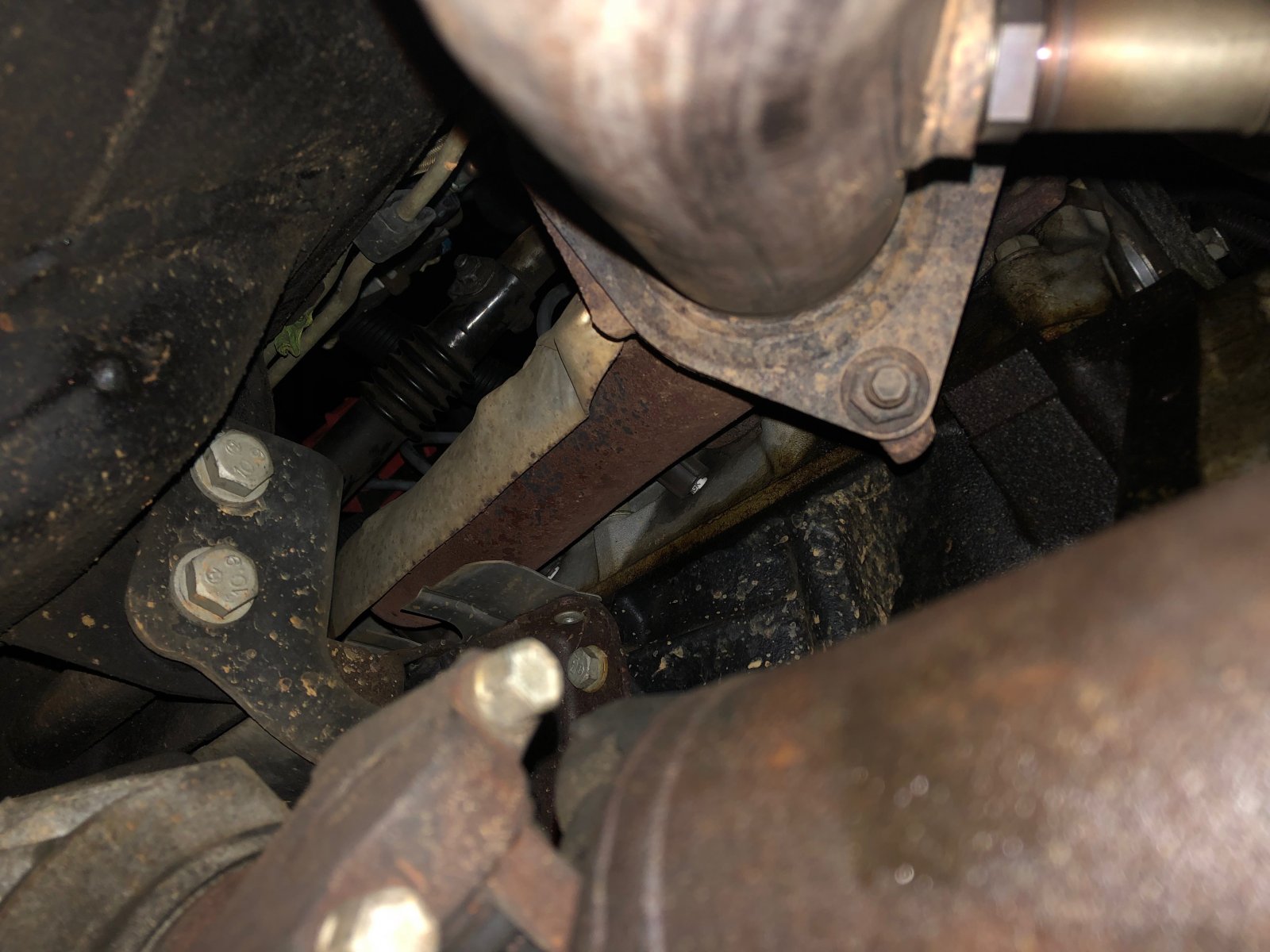

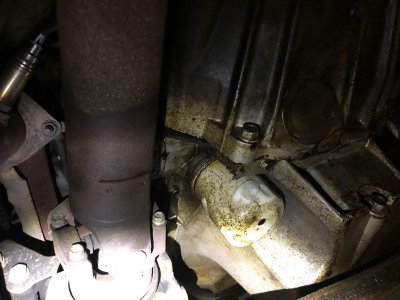

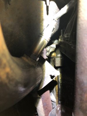

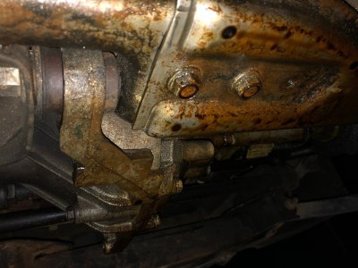

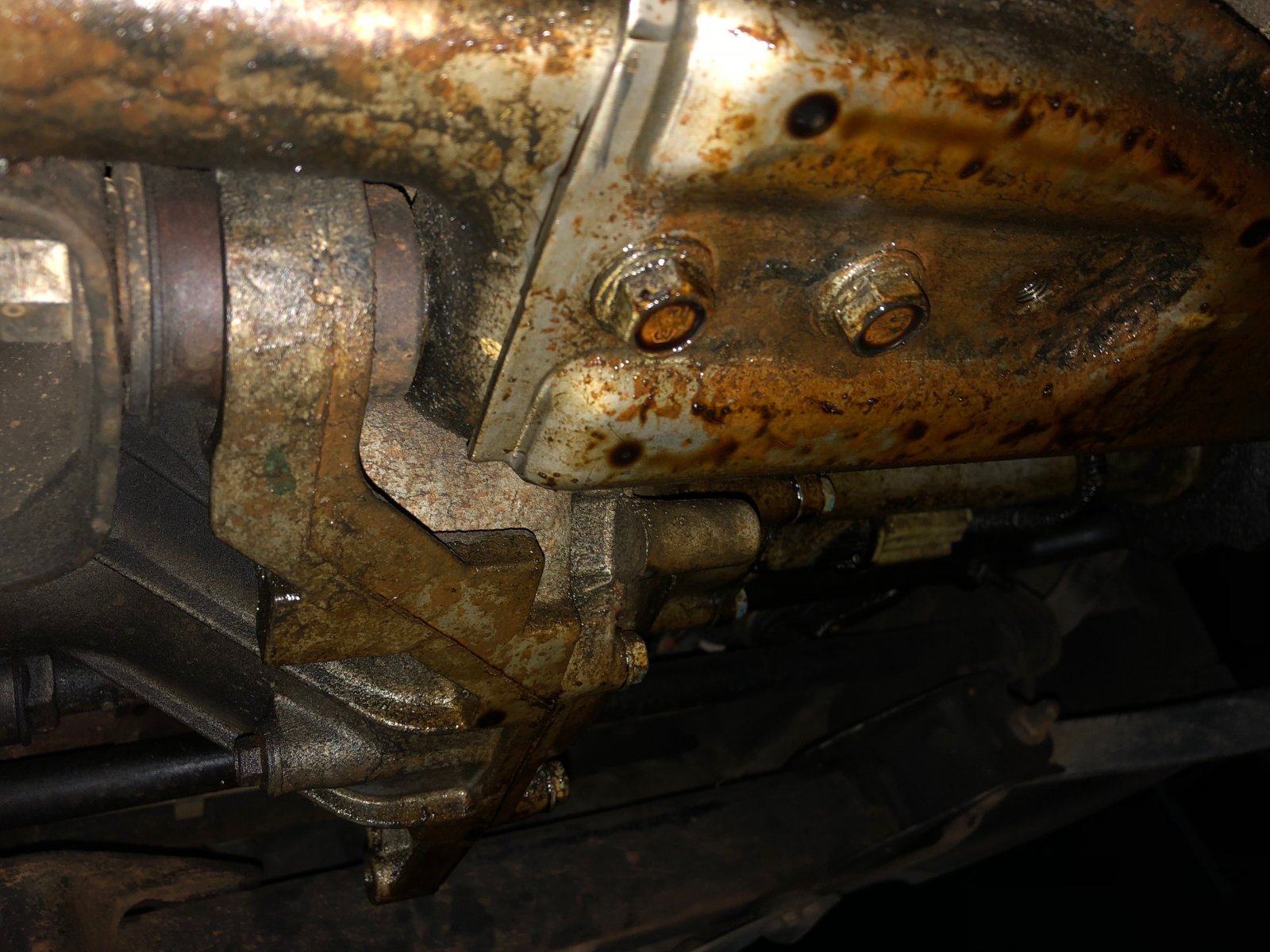

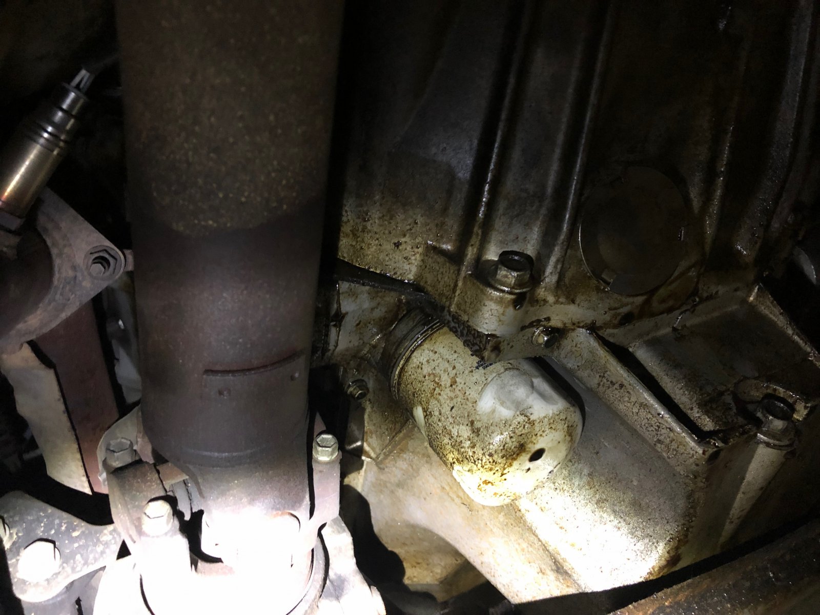

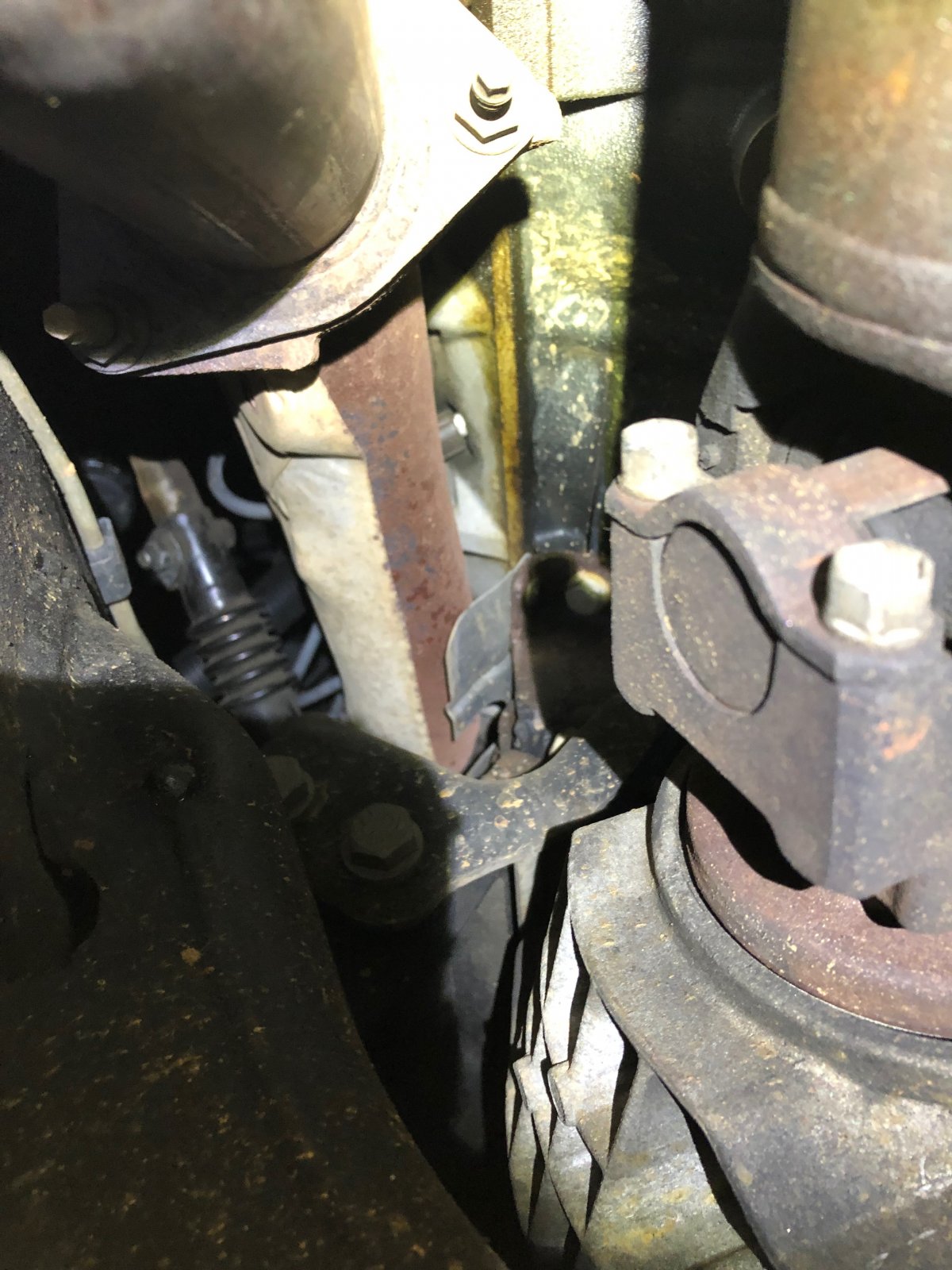

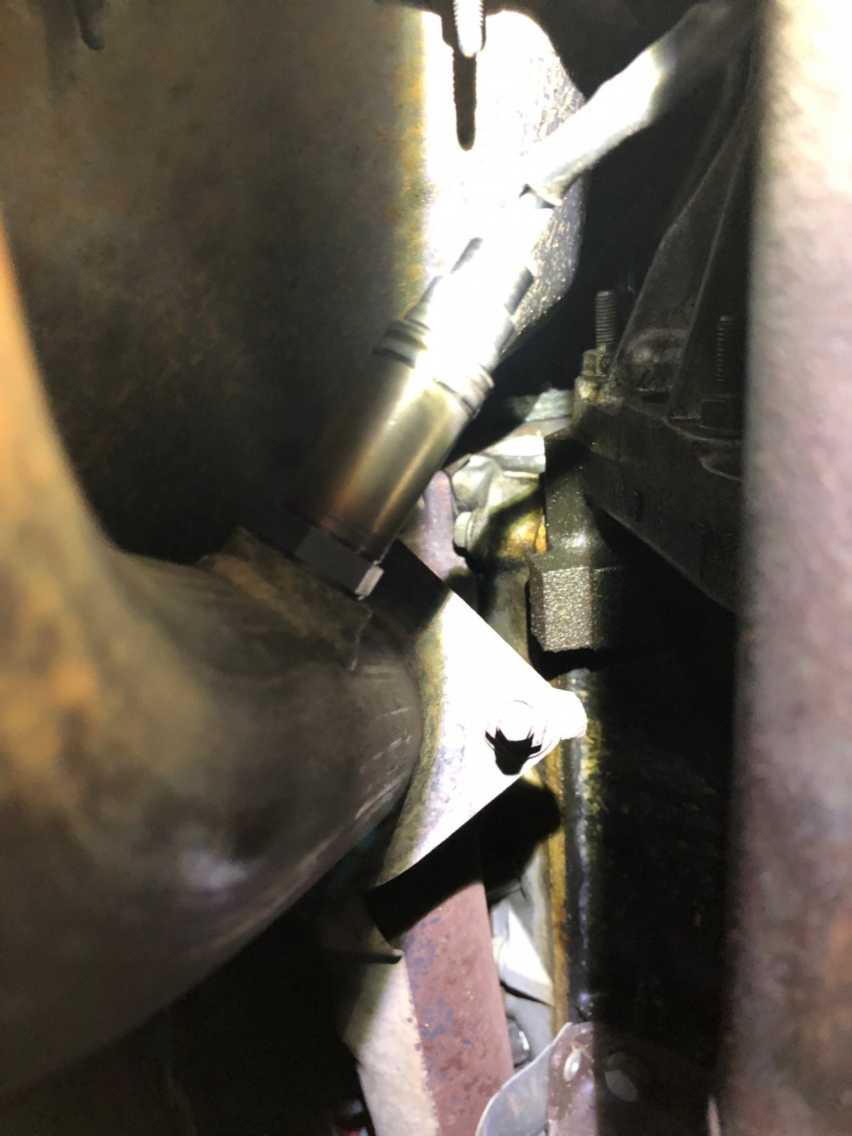

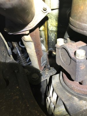

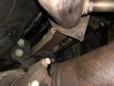

Last night after swapping out my O2 sensor I spent a little time trying to figure out where the oil leak(s) is coming from. I started the engine and crawled underneath for several minutes watching for drips. I found that there is an area above that O2 sensor (bank 1, sensor 1 - driver's side before cat) that is dripping down onto the exhaust, which is then causing a bit of smoke with each drop. (This would also explain why I smell burning oil coming from the air vents).
These aren't the best pics but do they, along with the description above, help anyone narrow down a potential source of the leak? Also I believe I have multiple leaks as when I park there are spots under the front and back of the engine... the spot under the back side is usually between the size of a softball and frisbee..
I'll try to get some more and better pics this weekend.
Thanks in advance for any help.

Oil cooler line? Metal to rubber fitting near front of block. On mine it was this fitting. At idle small drip but once the rpm increased a spray to the power steering pump area at front of block. Then blow back on highway and it took me a good week to find. Was covered all the way back to trans. Actually degreased and pressure washed the underside of engine. Dried and fired it up. Layed under there for 20 minutes and got a single drip. ????. Got the wife to rev it up and holy sh*t. There it was, a pinhole and a concentrated spray. These are known leakers. Metal expansion in the aluminum crimps. Another not so great design. (But it does make it easier to route when you have to change them). No brainer for me, aftermarket oil cooler and lines for me. 4 years and not a drop.
