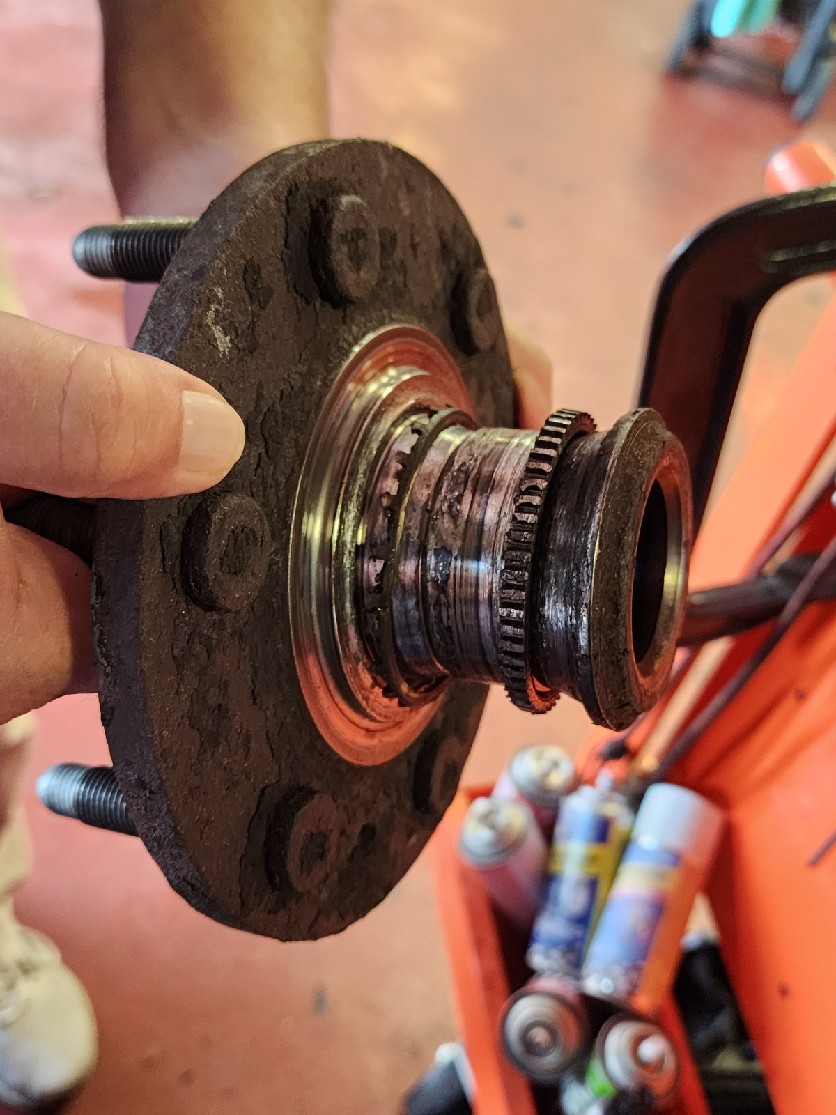

That hub looks original to me, so I would say the second dealer gave you accurate information. Perhaps the first dealer replaced the hub on the other side?

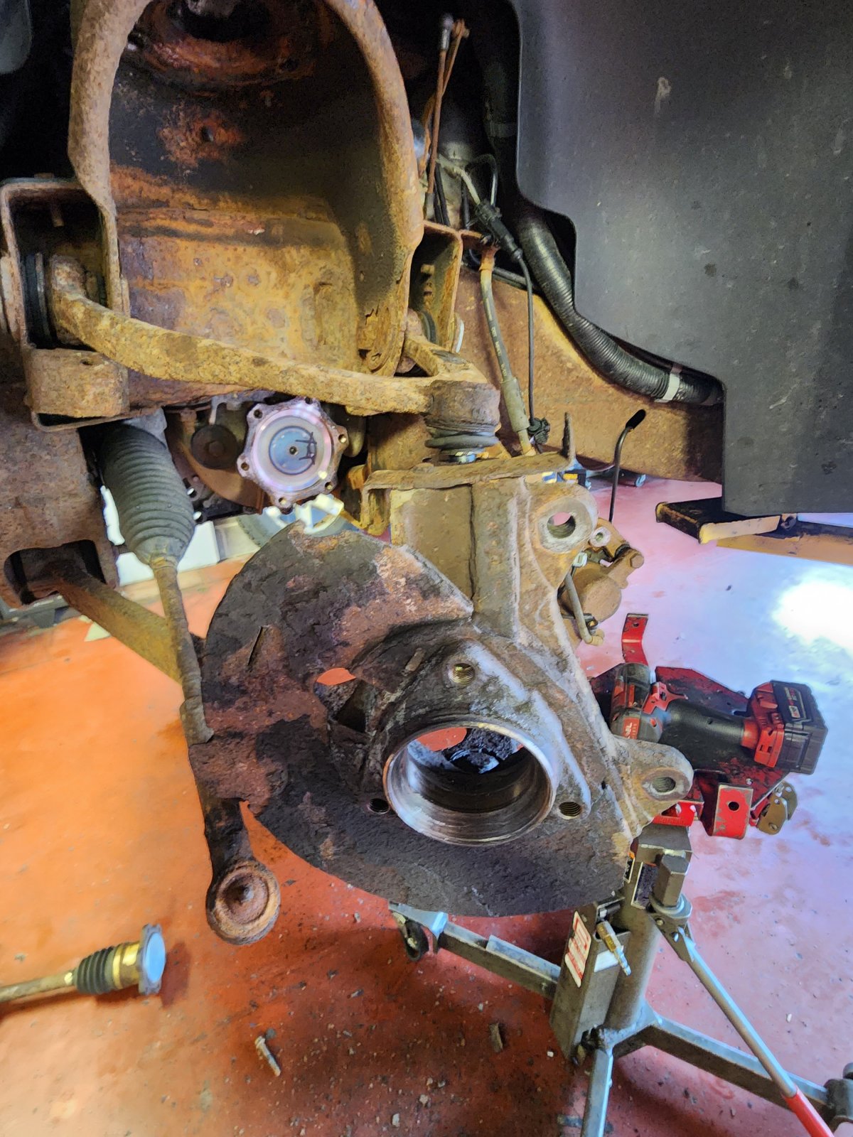

That is definitely shot! They were correct in their assessment. Also, your ABS stuff was caused by the tone ring either contacting the sensor, or moving out of range. By the looks of it, it was hungry and ate the sensor for lunch.
As for the axles being bad, that's hard to say. If the hub was moving all around, it could have put extra strain on the CV joint. Luckily axles are affordable and easy to replace.
All around an easy, straightforward repair. Any competent mechanic should be able to knock that out in short order.
