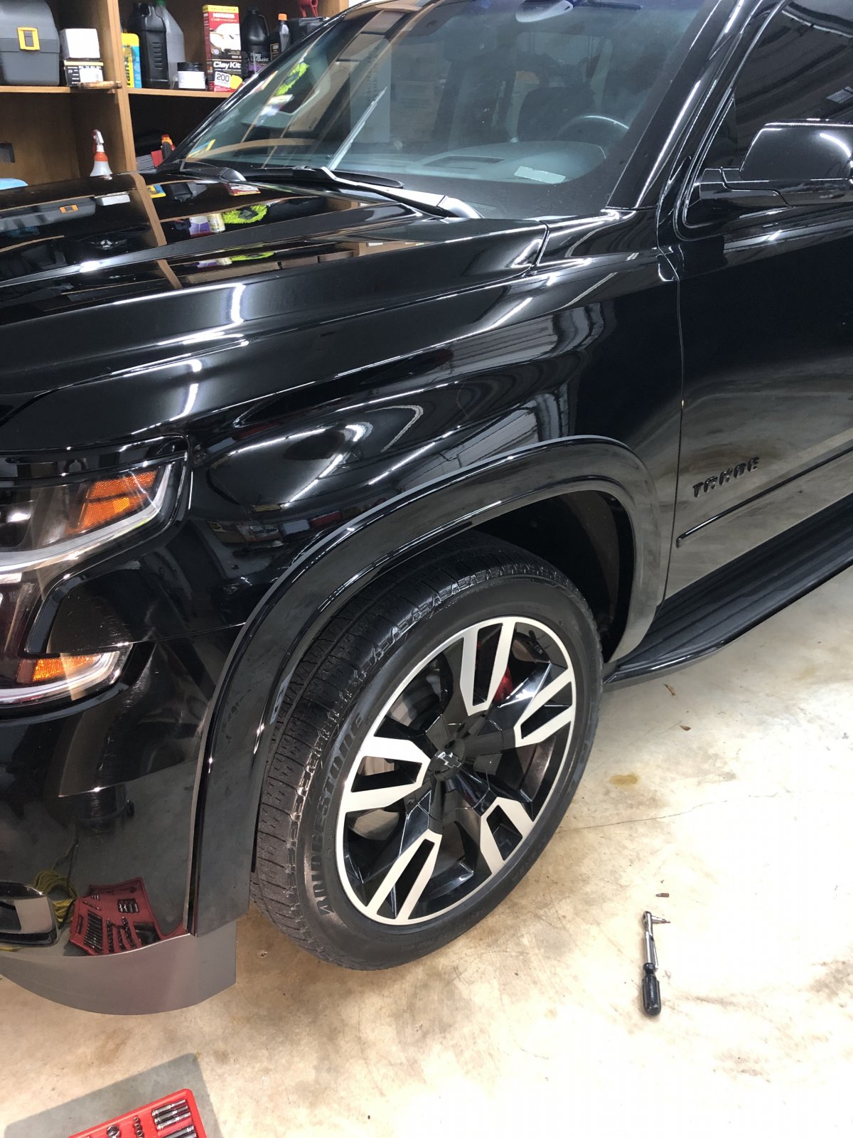

Hello I have a 2019 Tahoe, stock suspension however I’m looking into dropping the rear in order to level the car. I recently installed some fender flares and because of this I want my wheels to stick out more to match the flare. I really want to stick with the 22” wheel look. Can anyone tell me what the stock offset is on my trucks wheel? And also recommend me a wheel that has a lower offset so that they will stick out to be flush with my fender flares? Is it even possible? Thanks in advance. Here’s a pic of the wheel I have and you can see the fender flares there.

Here is a site you might find useful for determining how much farther out different offset wheel could potentially fit. It’s not vehicle specific but it’s enough info to give you an idea:
I believe your ‘19 OEM RST rims are 22” x 9” +24 offset.
Dont over complicate it. Nothing wrong with taking a vertical straight edge placing on the new EGR flares then measuring the distance from your stock tire sidewall to the straight edge. That will give you a rough idea how much farther out you want your new wheels to be.
If I had to guess you’re probably going to be in the range of a 22” x 9.5” +10-12 offset. And the stock 285/45/22 tires will be fine on 9.5” wide rim.

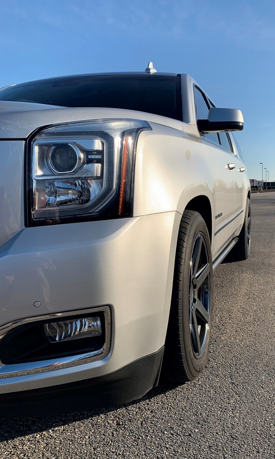

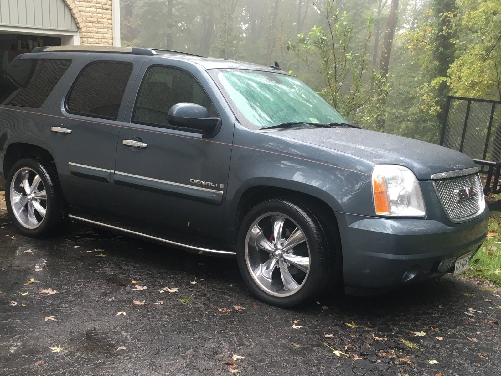

Whoops, hit the wrong symbol. They’re negative 35 so they have a pronounced lip. Here’s a pic with my old wheels but same offset.

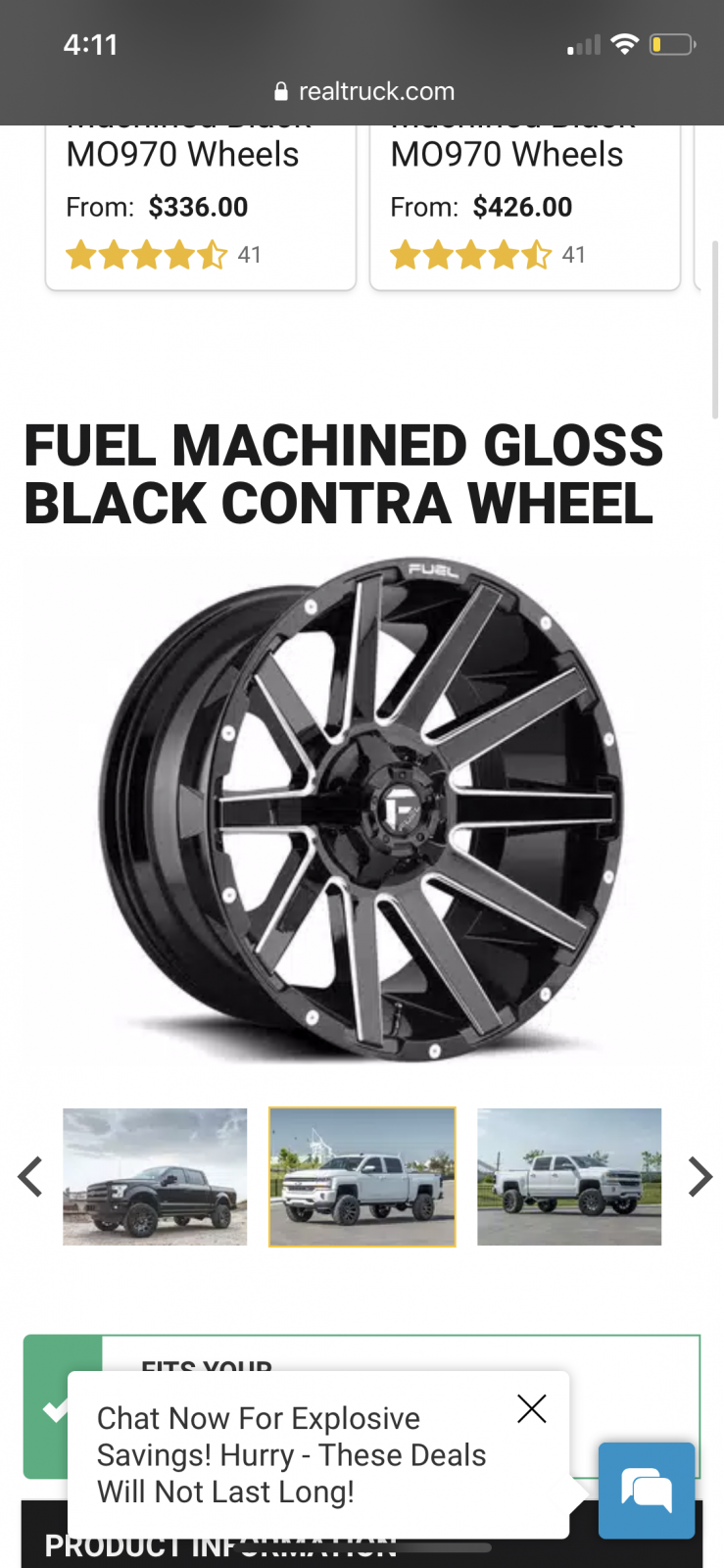

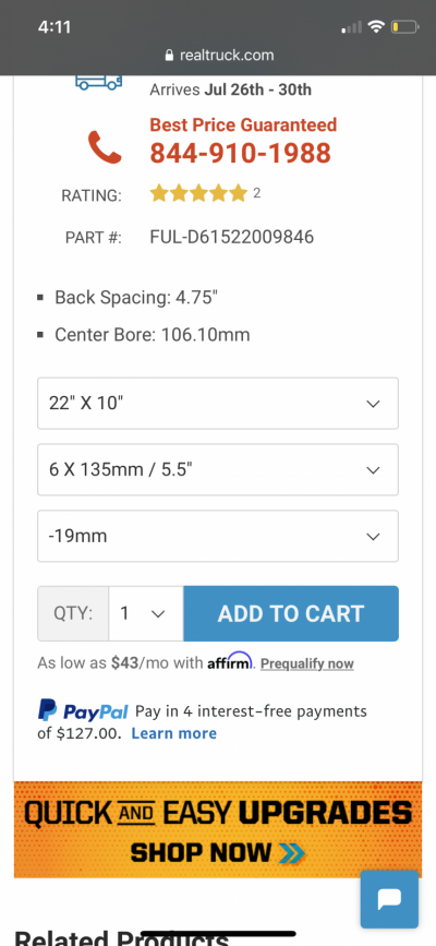

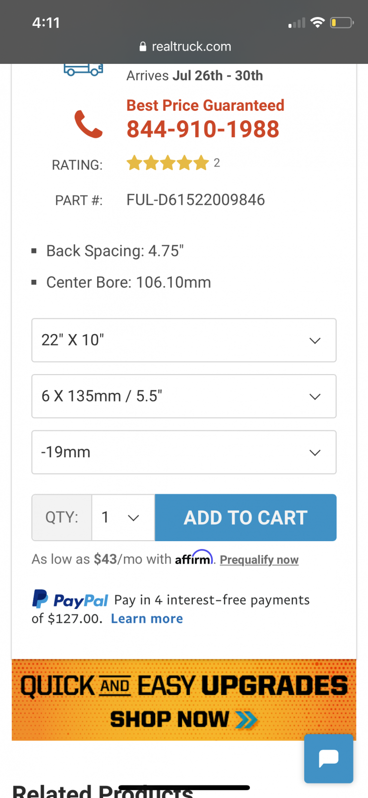

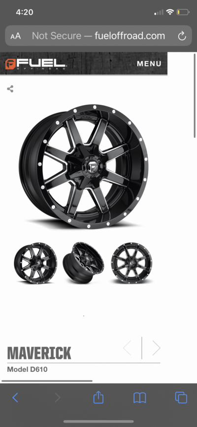

Found these wheels that I love the look of and the website only had them in 22x10 and with a offset of -19 and they say that they’ll fit. Does that sound right?

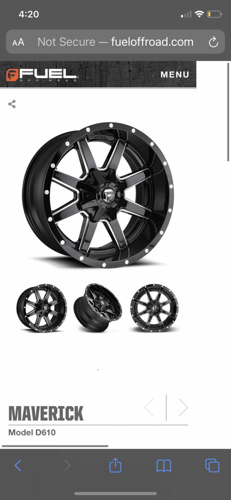

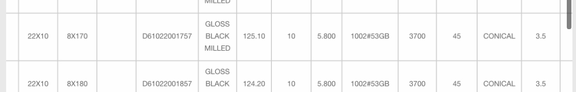

I’m pretty sure those ones I just posted will stick out way more than I need them to but I just found these that are 22x10 with a +10 offset which if I understand correctly should make my wheels go out about an inch and a half? That sounds about what I need to me. Would they fit?

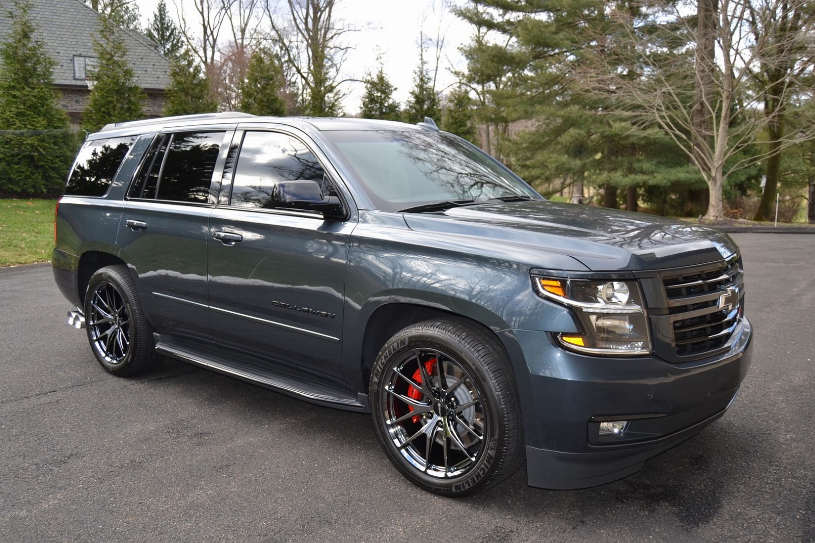

Here are my old Raceline Surge 156B PVD Black Chrome 22" x 9.5" + 15mm Offset w/ 285/45/22 Michelin Defender LTX's mounted.
You should be able to find some 22" x 9.5" wheels with +10, +12, +15 offset options.

The fuel contra is my favorite looking wheel but they only come in 22x10 -19. That would make it stick out 2.14 inches more than it does right now. Do you guys think that would be too much?
As mentioned mine s are 22x10 negative 35 offset with 305/45 tires. I’m lowered so I had to pull the front liner in a little but no rub out back at all. I’d think with 285’s you would be fine but to be sure call Tire Rack and tell them what you want.

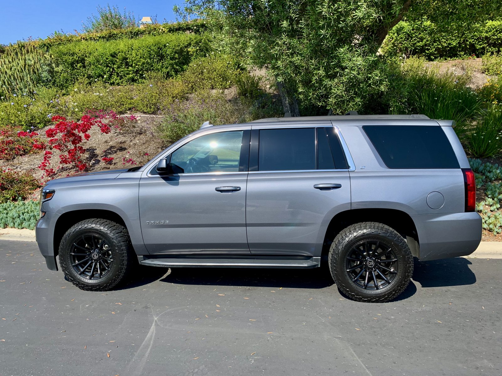

Great, sounds good. Could you post a pic if you can of the car from some angles showing how the wheels stick out? I want to get an idea of how it’s going to look.
